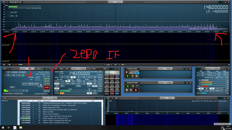

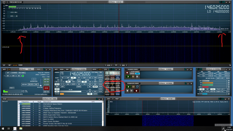

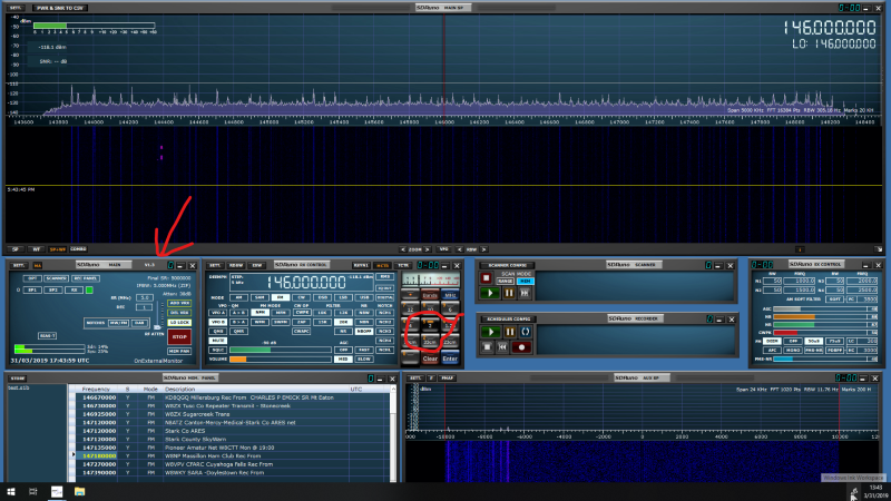

Not sure what's going on with 2 meter framing button
When I click on the 2-meter preset framing button, I only see about half the 2-meter band (145.1 to 146.9MHz). As a workaround, I can change the IF mode to zero, then go back and set the sample rate to 5MHz and then I can see the entire band (143.8 to 148.4 MHz).
But things get wonky after that. I haven't messed with it much, but it seems like after changing the IF mode to zero, if I go to different bands using the preset framing buttons, sometimes the IF mode stays set to zero, sometimes the IF mode changes to Low-if. Sometimes the sample rate stays at 5MHz, sometimes it changes to 2MHz.
I'm sure that there is a pattern to what's going on, I just haven't figured it out yet.
Thanks again for a great product. I have learned a lot about radio by using it and most importantly being able to visualize the signals.
- SDRUno 2 meter preset after zero if 2.png (380.3 KiB) Viewed 16459 times
- SDRUno 2 meter zero if 2.png (387.53 KiB) Viewed 16459 times
- SDRUno 2 meter preset-2.png (361.13 KiB) Viewed 16459 times
Re: Not sure what's going on with 2 meter framing button
This was an error in the re-definition of the band framing buttons. It'll be fixed on the next release.
1.31 fixed this.
Thanks for the quick response to this.
