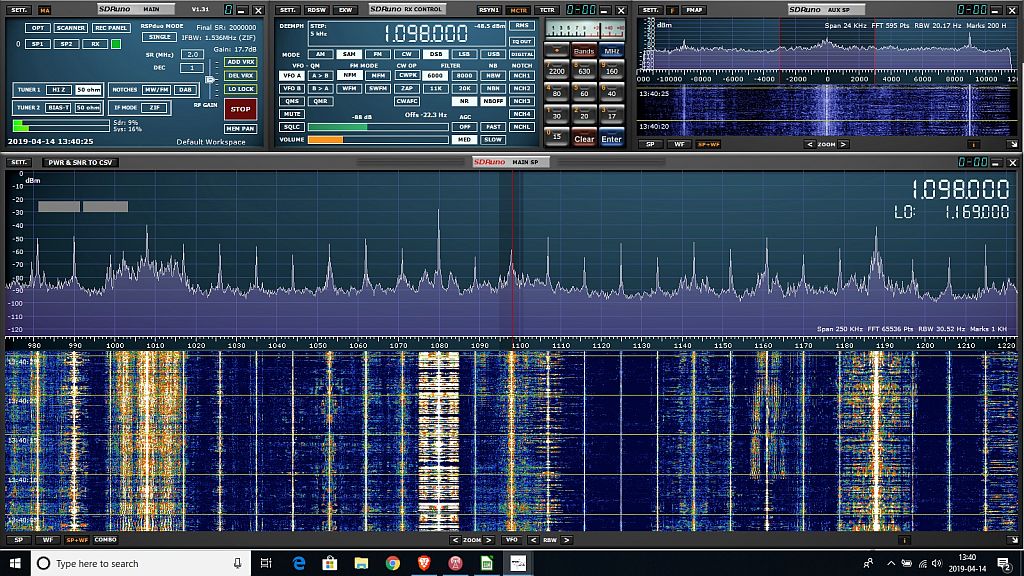

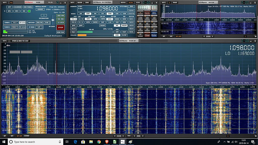

I have it figured out now. HOWEVER, clicking that ZIF/LIF button triggers some bizarre behaviour. (Gee, I hope I can attach some images!)
1. ZIF Mode. Listening to MW on 1098 kHz. First image. Note the frequency scale, the freq listed and IF freq below it.
2. Click to change to LIF Mode. Stations stay where they were on Spectrum and waterfall, frequency display is still OK, but freq scale has been shifted for no reason that I can see. The station originally on 1098 is now on the IF freq, according to the frequency scale, which shifts when you change to LIF Mode.
Not only that, but you can't tune any of the stations any more by clicking on the spectrum when in SAM (DSB) mode. It tunes OK in AM mode but you get nothing but screaching in SAM mode.
Clicking back to ZIF Mode sort of corrects this. You have to click the VFO button to re-center things ion the display.

- In LIF Mode
- SDRUno-2.jpg (196.38 KiB) Viewed 48145 times
- In ZIF Mode
- SDRUno-1.jpg (194.14 KiB) Viewed 48145 times

Look at LO lock: if you click on it the pointer will move when you tune. If you click again, the scale will move.
Re: How Do I Display More Spectrum?
Look at LO lock: if you click on it the pointer will move when you tune. If you click again, the scale will move. You are receiving a very strong signal @ 1153 KHz which maybe overloads the system & causes many birdies, it appears. Also I do not see the S meter bar & the power meter indicator, very strange.

I had the extra S-meter turned off. I always get that blank space when it's turned off. I don't know why. I turned it back on and noticed the SNR display under the S-meter. That's a good enough reason to keep it turned on!
