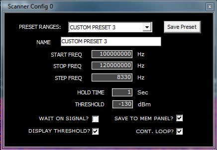

Firstly, I couldn't input a scan step of 8.33kHz? Is this not supported?

Tech support, thanks for your very quick reply!
For whatever reason it was automatically getting changed to 1000hz. I just tried typing 8.33k (with 'k' on the end) and that worked. Thanks.Tech_Support wrote:Firstly, there is no reason that you cannot enter a step size of 8.33 kHz. All I can think of here is that you are either trying to edit a pre-defined preset (which is not possible) or you were trying to set the step-size whilst the scanner was already running (which is also not possible). In one of the custom pre-sets, simply type 8.33k in the step size field and then save the preset. Please note that the RoW Air-Band preset already uses the correct step size.

Hello StandingWave,
Please check that you are trying to edit the step size of one of the custom presets. Select the entire number that is already there as a step size and type 8.33k I have checked this and it works fine.

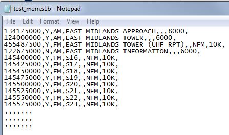

Just a quick note on the filter setting.
It is possible to edit the memory file using any text editor (such as notepad) and change the filter bandwidth to any permissible value for the operating mode.
In the example below, the first entry was changed from 6000 to 8000.

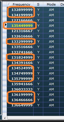

I would reply to this tread beacuse up to now the only "bug" noted is on the 8.33khz scan.
Using "8330" string on step field allow to scan the band, but not respecting the ICAO Guidelines, that define the required overlap between 25khz with 8.33Khz channels.
Example:
scrolling up tune from 118.000, multiple steps of 8.33 bring to have 25khz frequency channels not correct ( for a max of 6khz ). It's not a big deal but for instance, storing frequencies while scanning results can't be compared with official 25khz db already present.
Any suggestion to fix it?
I'm playing with an rsp1a since few weeks and i can only say.. Great product! Also the features on sdruno are amazing..
Example:
