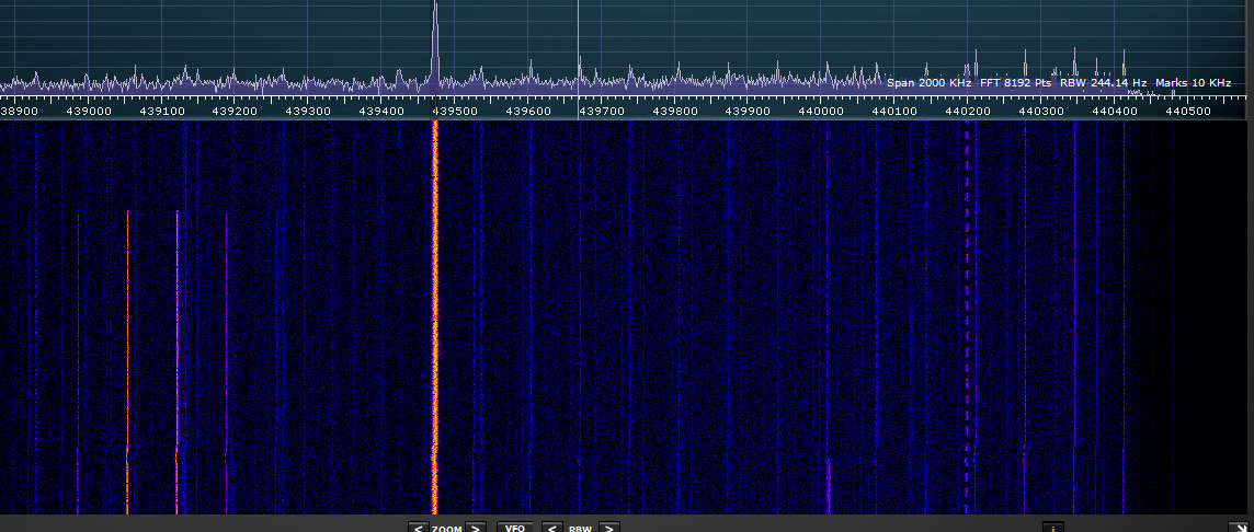

BTW, anyone know what the signal with the dotted line is on the right of the waterfall at 440.200MHz? It seems to be there constantly regardless of the time of day I fire up SDRuno.
- wfall2.jpg (282.82 KiB) Viewed 72743 times

Good to hear you got it working, I think the NXDN was mis-identified if you're still on a DMR channel.
Don't know about the 440.200, frequency is clear here in the Netherlands.
Over here there are a lot of NXDN signals between 460-470 mhz, maybe it's the same where you are and you can have a look at decoding them.
Martien, PD1G
