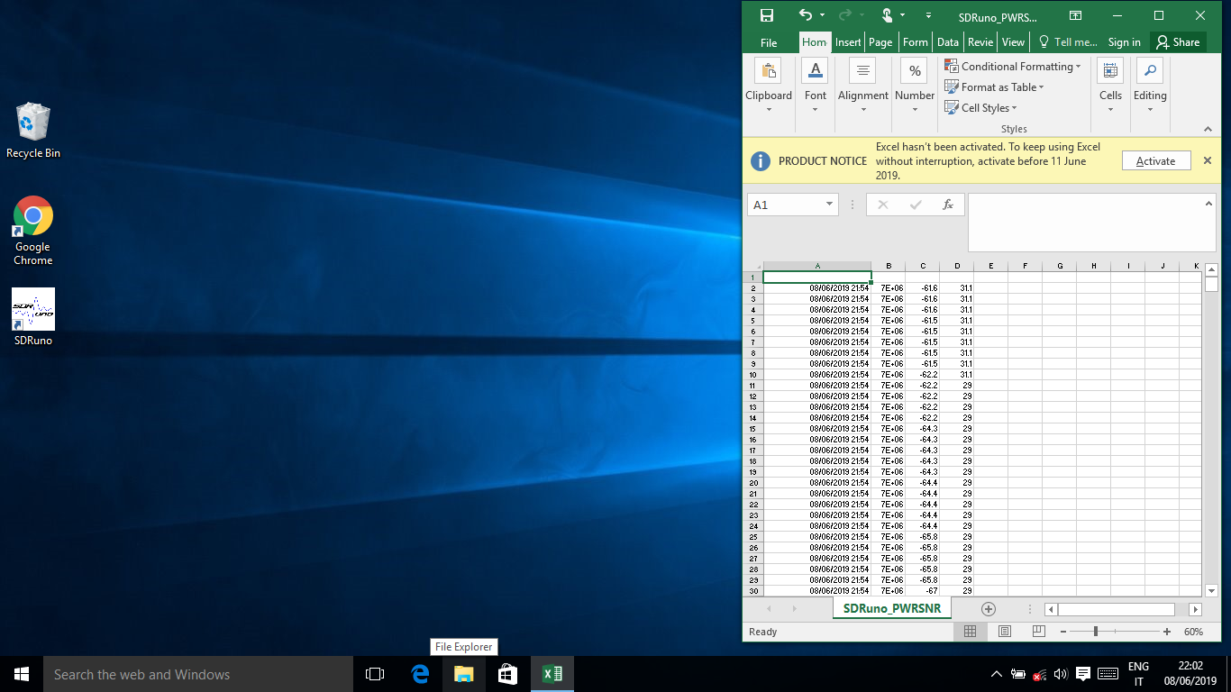

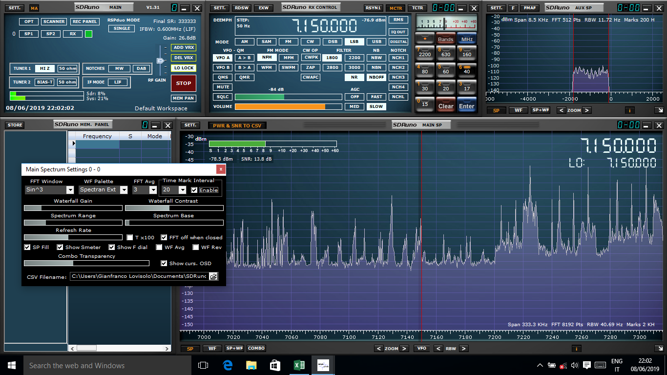

Post by glovisol » Sat Jun 08, 2019 8:10 pm
SDRplay Support,
I am really sorry to give you this new problem, but here are my pics....I really do not understand what is happening. It behaves like this both with the IBM X61 + W7 and with LENOVO T540p + W10.
Gianfranco
