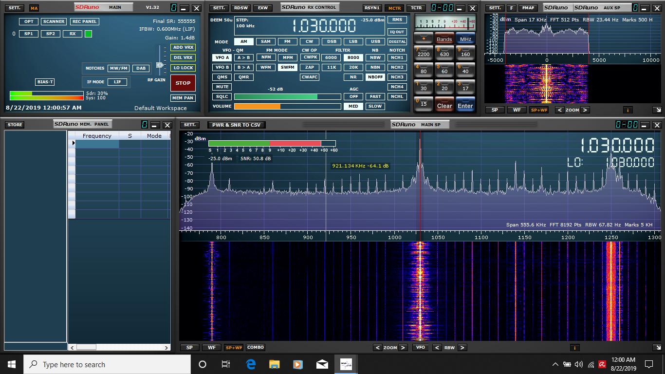

Capture1.PNG I started the program, clicked on Play, the frequency was already set to 1.030, audio unintelligible.

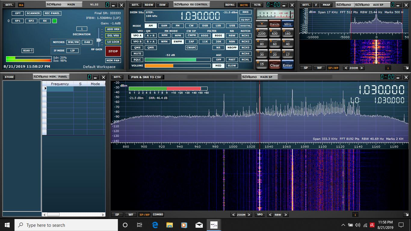

Capture2.PNG I clicked on the 80M button, then put the frequency back to 1.030 and mode back to AM and the
BC station comes in normally
The captures were originally PNG files and this program said they were too large to attach. So I converted them to JPG files.

Re: Initialization problem?
Hi again Jim.
That's really odd! I can't find any problem with your settings. A first I thought the distortion may be due to the LO and the VFO being the same, but you're in LIF mode so it doesn't matter.
I can only suggest raising a support ticket via the main menu on this site or maybe doing a 'factory reset' via SDRUno's OPT menu.
CPU load is up at almost 100%. This will result in severe audio breakup.
Yeah, but it was equally high before and after.
Something doesn't look right there, you have sample rates that look like band buttons have been used, but none are depressed. Can you explain the steps you took to get to the position where the audio wasn't right and then when it was?
