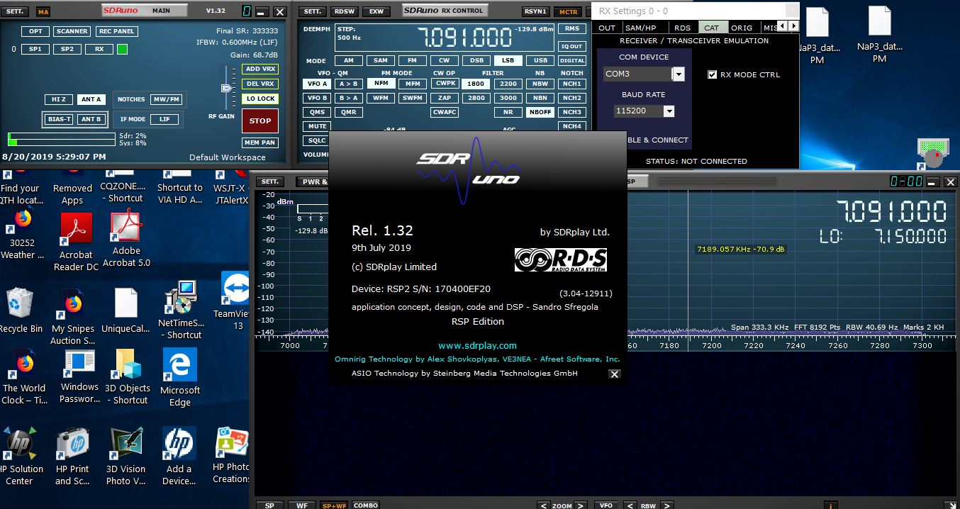

I liked the SDRplay when I first got it, but I can hardly use it anymore. The SDRuno software has just become too complicated. Perhaps it is just me - old age. My latest problem is I am now getting an error message - "VRX#0: The specified com device doesn't exist or is already open?" I run OmniRig first then HRD and then SDRuno. It always worked perfectly until recently. Radio is TS-590SG - I am using both the USB and Com ports. Any help would be appreciated.
Newest problem the SDRuno logo keeps popping up and I can not cancel it.

You have the RX Settings 0-0 covered by the about screen. That error is produced when a com port is assigned in that settings area that does not exist.
Try unchecking Enabled and Connect
