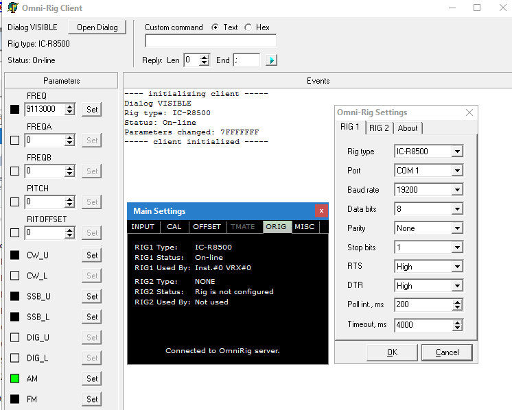

your FT2000 must be connected to a physical COM port on your PC where Omnirig is runnning. It seems as if you are trying to access the FT2000 through an uRouter network. I do not have such a setup and cannot comment on uRouter.
But, when Omnirig Client.exe finds the FT2000 and reports frequency and mode correct (after you started your uRouter), any program interfacing with Omnirig must get the same information, including SDRuno, of course.
Did I understand right, that in the window of Client.exe all is right after you started uRouter? Or does Client.exe always report a missing COM port?
I have attached an image of my R-8500 (I have cut off some buttons which are not available for my 8500 to make the image smaller). This is basically how it should work with your FT2000. I have a physical COM1 on my PC, no uRouter network.
73s, Heinrich
