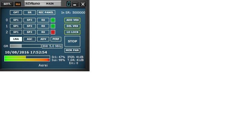

the screenshot at this very moment we see the consumption of almost 100% of the memory.

Sorry, ik3umz, this screenshot means little to me. Please post a shot of the Task Manager and answer the question I ask in my first post. I would also suggest you reduce the BW to the minimum you really need. Your 5 MHz BW is using both CPU and memory resources.

I have set the options I can see in the image posted by IK3UMZ. Now my SDRuno consumes 140 MB (2 VRX, I had only 1 before).
But this is still not reason to worry. CPU usage now is around 10%.
The problems indicated in the IK3UMZ's MAIN panel seem to be related to a huge CPU usage rather than a memory usage.
Try to delete one of the VRX. Does this make anything better?
