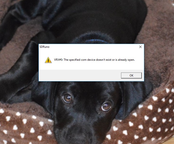

I get this error before Sdruno starts.

I have just got my Sdrplay and installed Sdruno. I keep getting the error message in the attached image each time I start the program. If I click th OK button on the error the software runs ok. Has anyone else had this message and is there anyway to get rid of it. The sdr play is connected to a use 2 socket. There is only one instance of it running.
Thanks for any help
Rod

Make sure you don't accidentally have another process of SDRUno loaded.

I've only got one session running. I can boot up the pc and Sdruno will be the first program I start and I get the same message.

Rod2117, please open a administrator command prompt, enter winver and post the results here. Thanks and enjoy, John.

I think I have solved it. In the RX screen I clicked the settings icon and whilst going through the various options I noticed that the receiver/transceiver option was checked. I unchecked this and started Sdruno. No error message and all is fine.
Thanks forth the replies.
I can start using it properly now.
Rod
