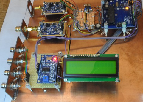

SteveAndrew wrote:The Trackgen software actually started out as part of a project similar to what you are doing. I was building a vector analyser using the AD8307. I got the system pretty well up and running, and then got distracted with the analyser project. I'm having some thoughts about incorporating the VNA system into the analyser to give it added utility.
As you may see on the picture I have also used two AD8307 boards (https://www.sv1afn.com/ad8307pmh-1.html). They are working very well. Very lineair and low noise 25mV/db, 50 mV/dB and 100 mV/dB output. The LCD display was not connected during our experiments.
Scalar NWA proto board.
I found a very nice DIY Dual Directional Coupler, 5 - 1000 MHz, 20 dB at https://www.changpuak.ch/electronics/DI ... oupler.php with all data to produce such one.

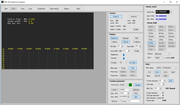

When I launch SAS-s.a. then sometimes the program starts as shown in fig.1 Clicking the Spectrum button once then I have the full field back. It performs when you have used SDR-UNO before laucnhing SAS-s.a. If one knows it (manual), then it is a minor detail.
fig 1.jpg (31.04 KiB) Viewed 30836 times
