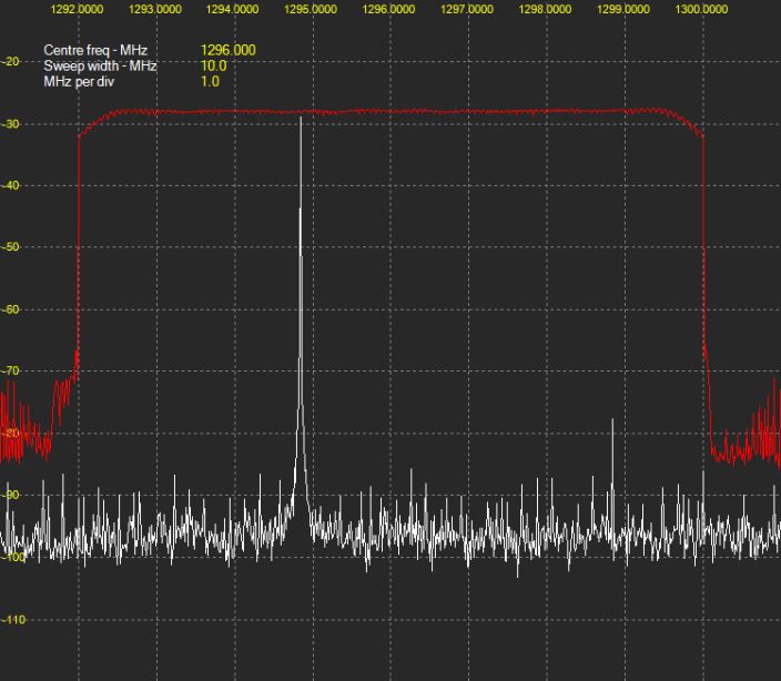

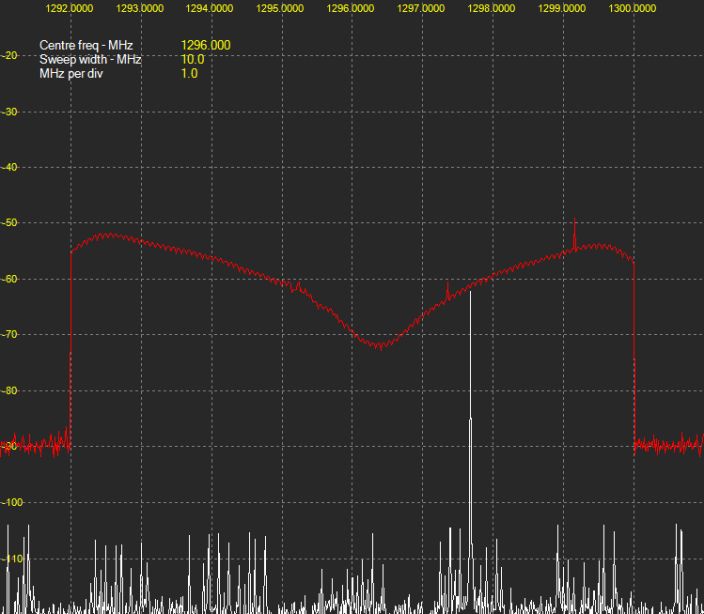

attached files are a return loss sweep of a 10 element 1296 Mhz yagi antenna.
return loss bridge used was an amtronix sw 1200n. didn't want to mess with a tracking generator........so signal generator was set for Very slow sweeps to achieve a smooth peak hold trace. (8mhz sweep, 50ms delay per step, 1000 steps)
second picture is with the DUT removed to establish a reference line.
first picture is with the antenna attached to the DUT port of the RLB.
sweep 1296a.jpg (50.41 KiB) Viewed 34590 times
sweep 1296.jpg (53.68 KiB) Viewed 34590 times
