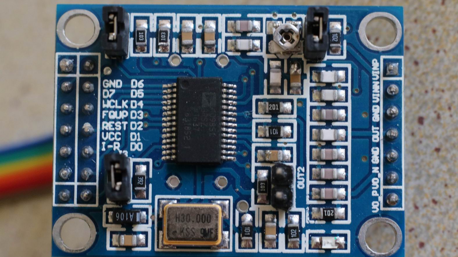

Pics of the two modules I bought :
AD9850 Module.jpg (180.56 KiB) Viewed 31371 times
AD9851 Module.jpg (217.66 KiB) Viewed 31371 times

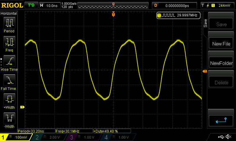

I think the time difference meant that you missed my second message, when I wondered about the oscillator as well, but having put the scope onto the XO output pin, it's reading a solid 30MHz regardless of the set frequency, so it looks like it's a real 30MHz XO.
AD9851 XO 1.jpg (73.22 KiB) Viewed 31371 times
I'm wondering now if the problem lies with the I-R pin being unconnected? I think I read that this pin switches the internal oscillator in or out, but how this leads to a default of 2/3 of the set frequency I haven't a clue. I'm brand new to Arduino stuff, so it's impossible for me to judge whether the problem is with the module itself or its control. Lots of research on my part is needed, I think.

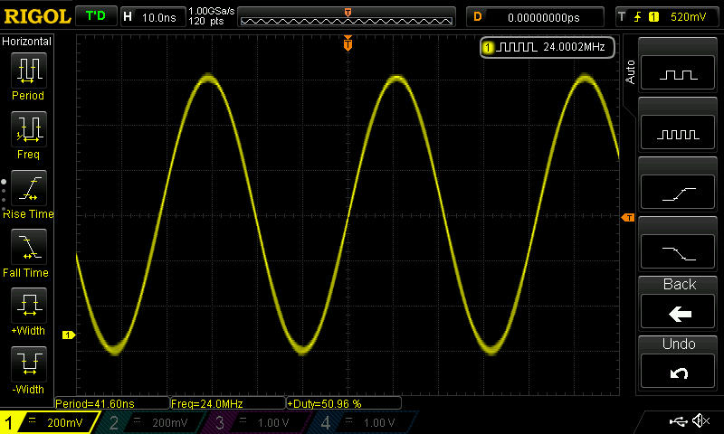

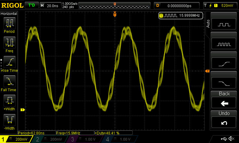

Pics of the sine wave outputs from each module - the AD9850 is by far the better of the two!
AD9850 24MHz set, 24MHz out.jpg (74.65 KiB) Viewed 31371 times
AD9851 24MHz set, 16MHz out.jpg (77.78 KiB) Viewed 31371 times

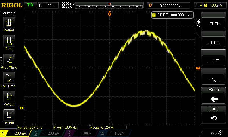

AD9851 1.5MHz set, 1.0MHz out.jpg (74.11 KiB) Viewed 31371 times
Output Ch 2 on the AD9850 was used for the pic - Ch 1 output looks the same as the AD9851 pic (on which both channels give the same output).
Going by the clarity of the printing on the back of the chip on each module, it did occur to me that the AD9851 chip could well be counterfeit (we shouldn't be surprised if it is!). Loads of fake AD9850 chips were in circulation two or three years ago, I've read - maybe this is why Don can't get his to work?
Regards,
Dave
