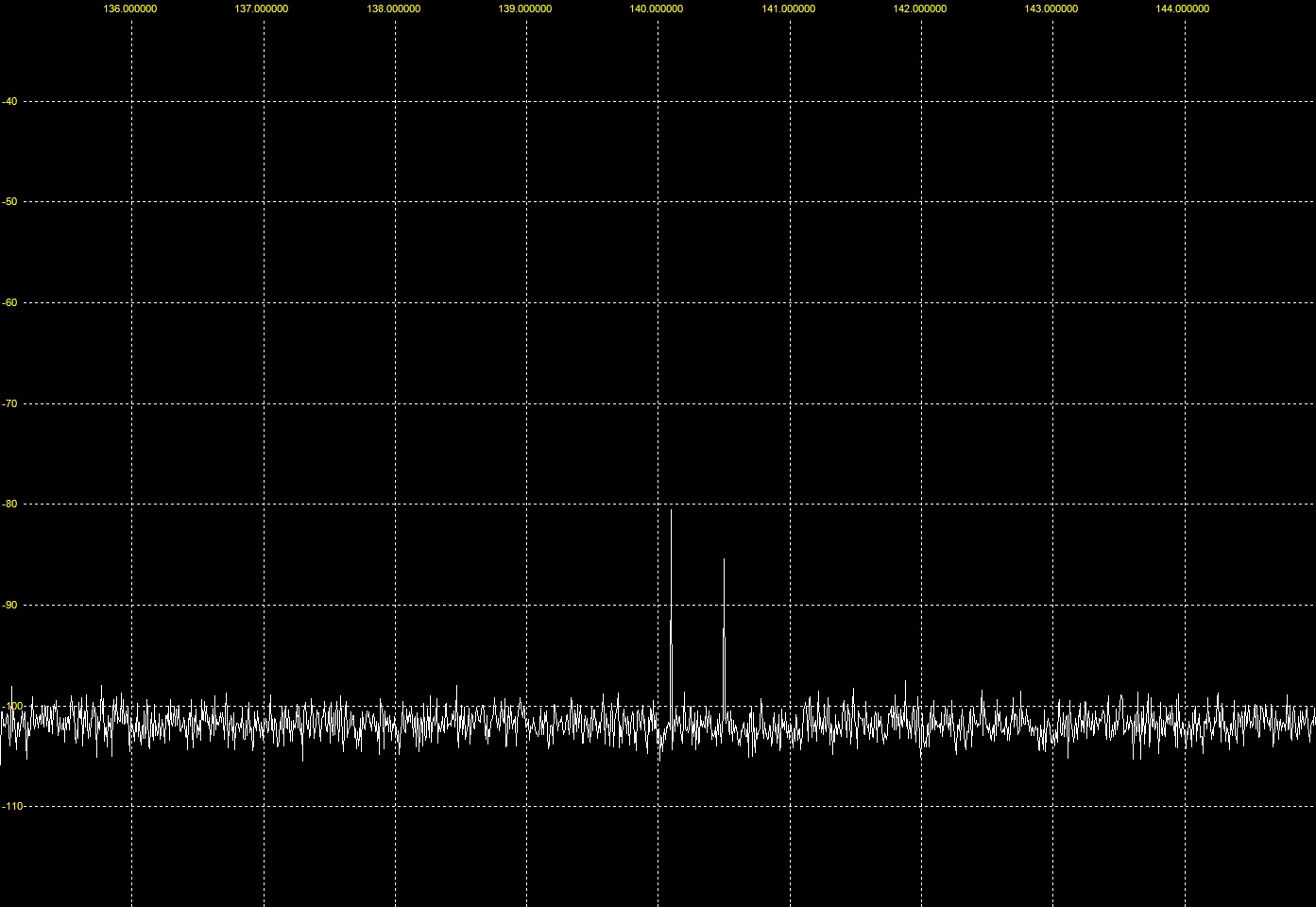

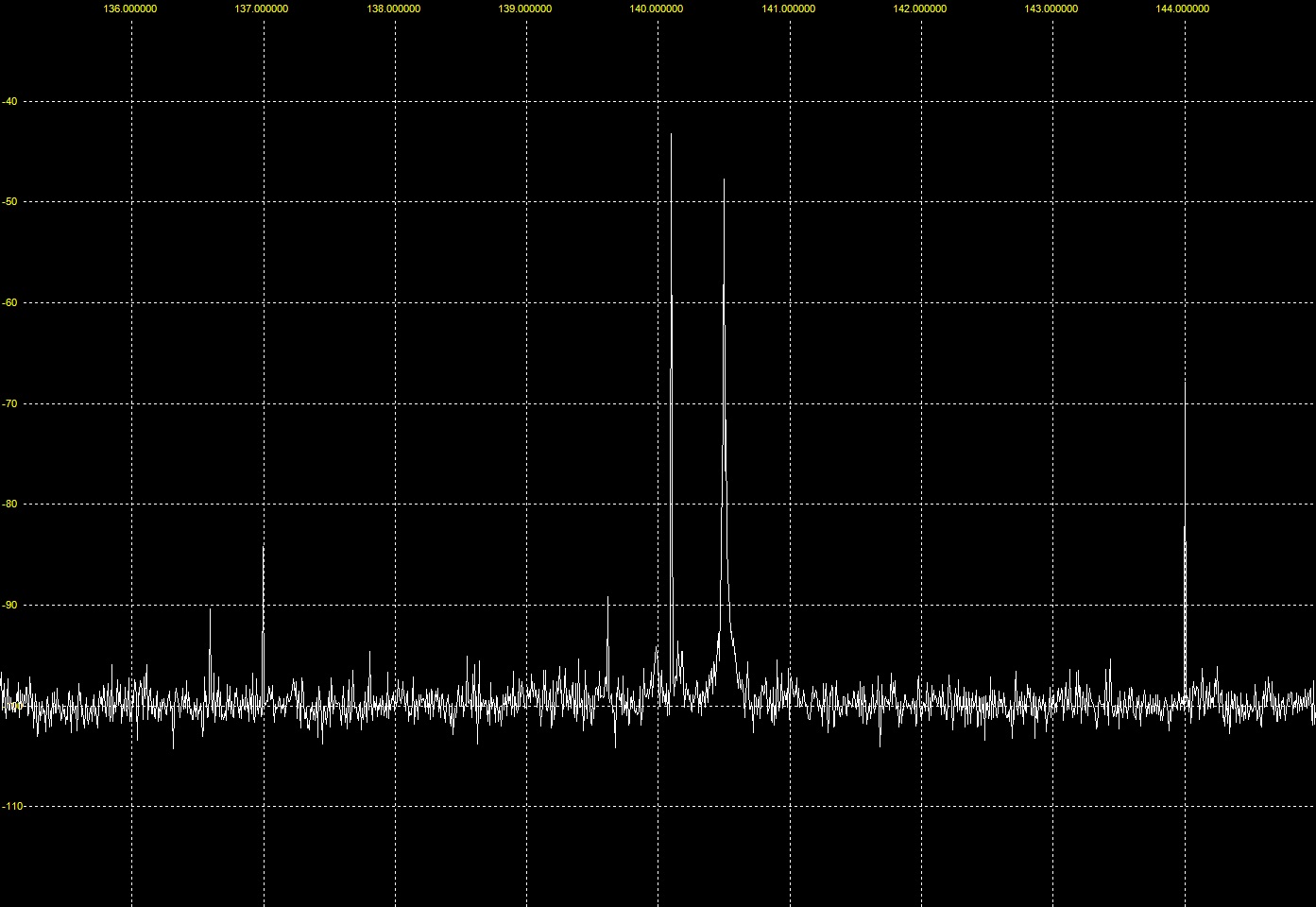

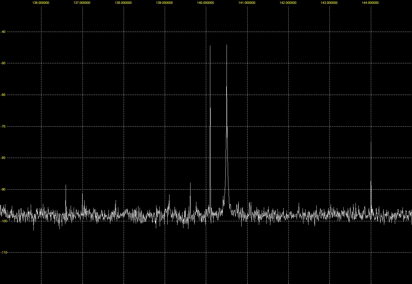

I have used an RSP Duo with a 140.1 MHz DDS output connected to tuner1 and the 140.5 MHz output of an ADALM Pluto SDR connected to tuner 2.
In SDRUno I see on tuner1 only the DDS signal with a RX level of -28 dBm. On tuner2 I see only the Pluto SDR signal with a RX level of -30 dBm.
If I start the spectrum analyser program, select tuner 1 and push the start button I see both signals of both tuners with low level below 80 dBm.
Selecting tuner2 no signal is visible
Selecting Tuner1 again both signals are visible but now with higher power levels.
Further switching between tuner 1 and 2 does not change the shown spectra of tuner 1 and 2.
If I now push the “stop” button and then “start” button again then also tuner 2 shows both signals with slightly different power levels.

Cornie wrote:If I start the spectrum analyser program, select tuner 1 and push the start button I see both signals of both tuners with low level below 80 dBm.
Cornie wrote:Selecting tuner2 no signal is visible
Cornie wrote: can repeat this after restarting the spectrum analyser. Also, after a complete deinstall and reinstall of sdruno, spectrum analyser SW and drivers.
Do you have any idea what causes this behaviour?
There is a bug that was mentioned in the release notes: If the analyser is stopped and re-started, sometimes (but not always) there seems to be a shift in reference level causing a drop in the apparent noise floor. This may be connected. I've added this to the bug list.

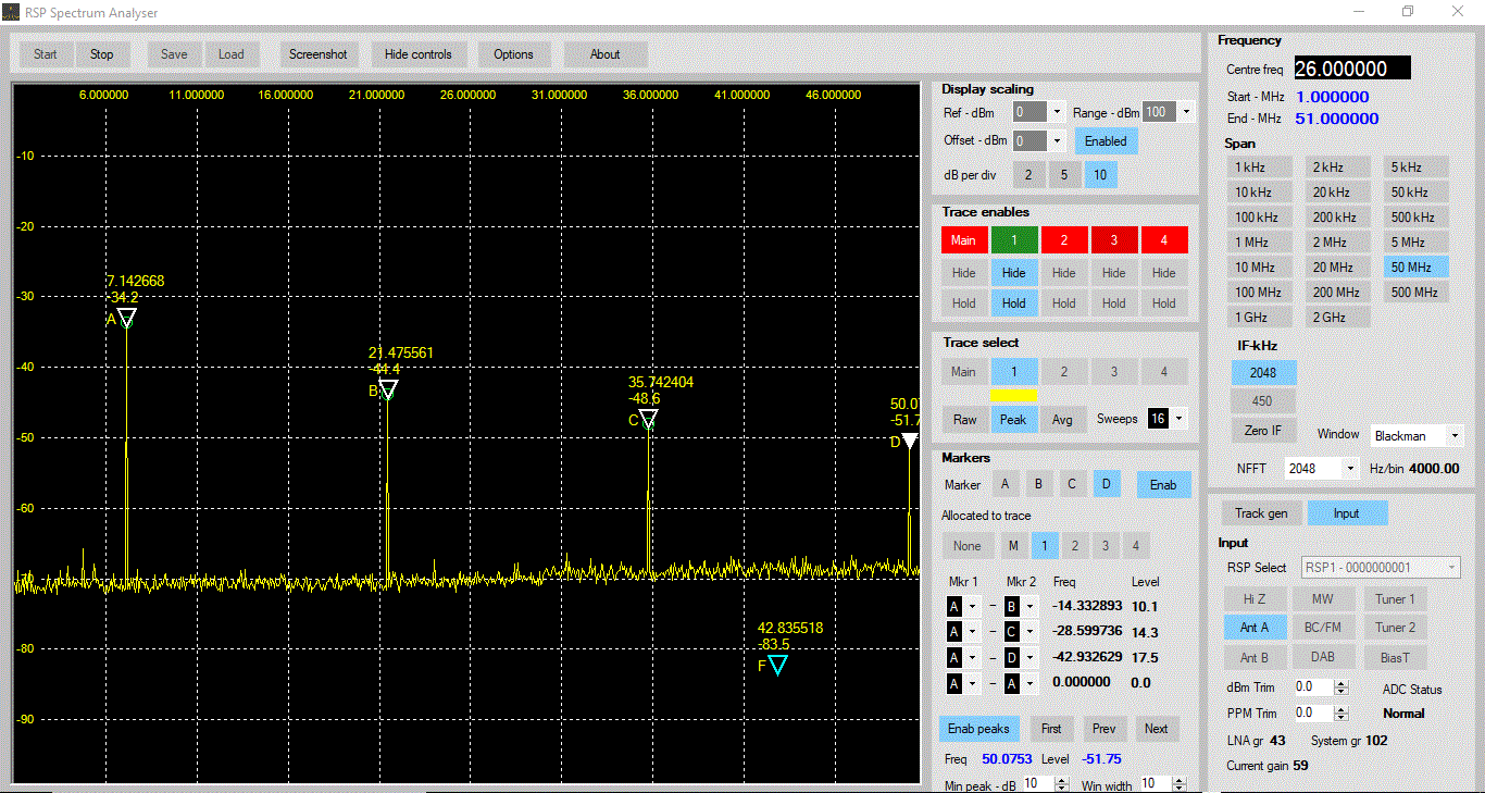

K9AQ wrote:Thank you Steve!
This morning I did a quick test of the ability to measure harmonics using an Elecraft XG3 signal generator. The placement of the marks takes some getting used to. I found the fastest way was to enable peaks and then use the "next" buttons to place the marker on the peak that I wanted.
https://www.sdrplay.com/community/downl ... ew&id=1592
Don
K9AQ
Hi Don
Glad you like the new version.
You are correct, using the peak function to place the markers is by fare the easiest way to do things. As you say, placing the marker with any degree of precision can be difficult. I'm going to try and add a "nudge" function to help by using the scroll wheel or left and right arrow keys.
