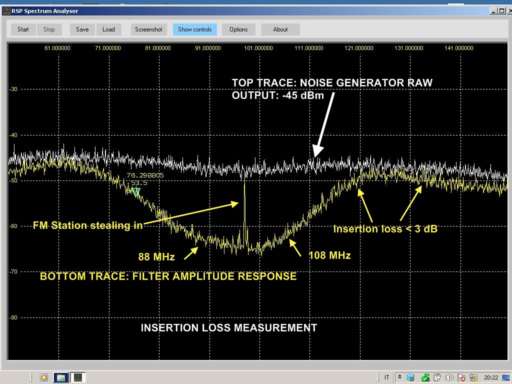

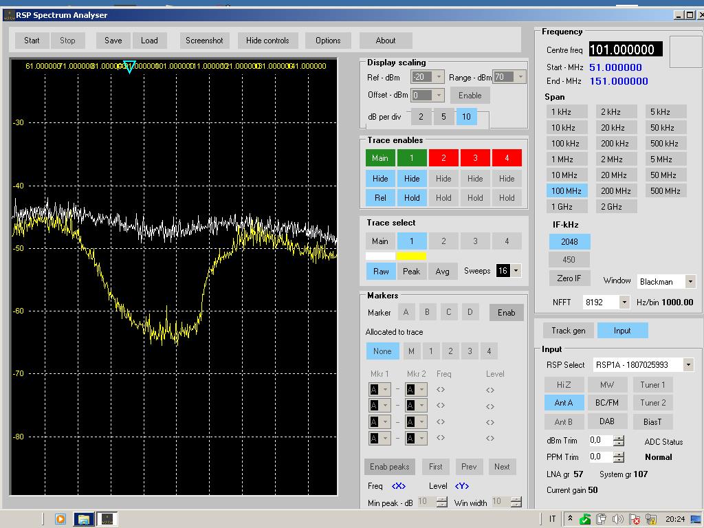

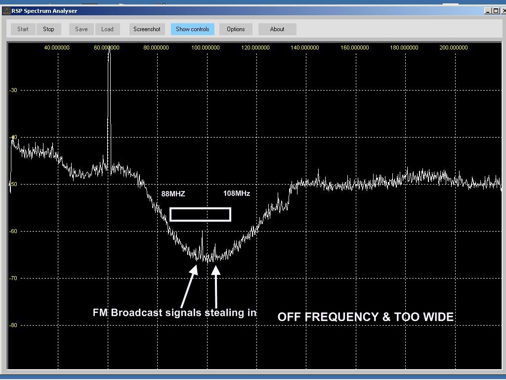

THREE SECTION/TWO STUB COAXIAL LINE BANDSTOP FILTER FOR FM BROADCAST BAND SUPPRESSION
By cutting three cheap TV type coaxial cables to 1/4 wavelength at 98 MHz and hooking them together with two coupling capacitors you can build and test a bandstop filter prototype in one morning's work, thanks to the new Steve Andrew's Spectrum Analyser and to a cheap BG7TBL Noise Generator. This would have been impossible before because of the severe bandwith limitation of the previous Ver. 0.9.

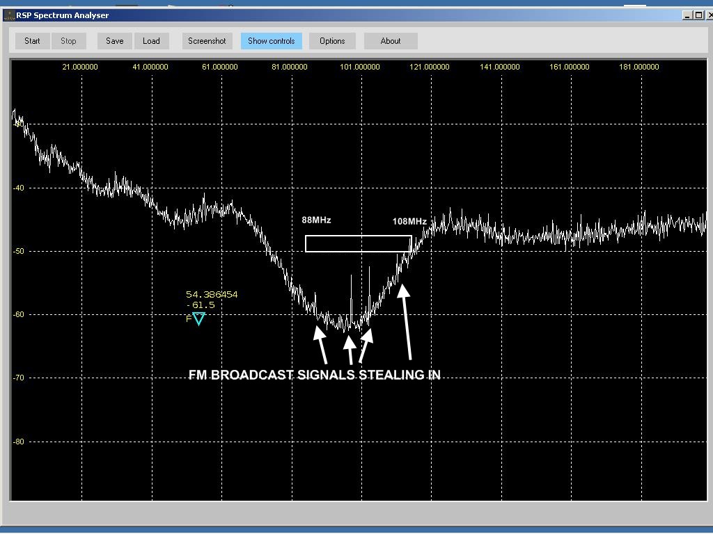

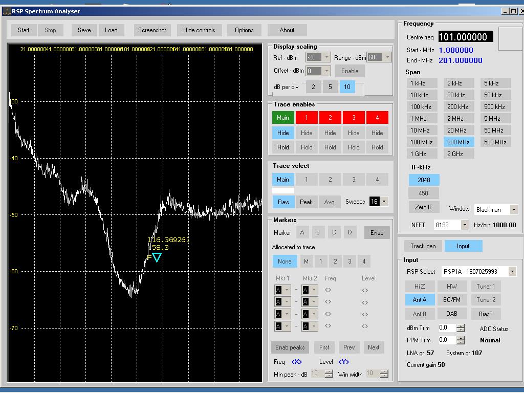

THREE SECTION/TWO STUB COAXIAL LINE BANDSTOP FILTER FOR FM BROADCAST BAND SUPPRESSION - CLOSEUP DATA
Here below more filter measurement data.

Hi Glovisolglovisol wrote:THREE SECTION/TWO STUB COAXIAL LINE BANDSTOP FILTER FOR FM BROADCAST BAND SUPPRESSION - CLOSEUP DATA
Very nice screen-shots, great to see the analyser being put to good use.
Looking at your screen-shots, it looks as if you might be running under Vista. I've just installed the analyser on a Vista machine and I'm getting the same display as you are. Some of the control panels are displaying a fine lines around the border, there is an empty box to the right of the centre frequency box, and various other 'artifacts'. Also, after hiding and then re-showing the control panels, the top bar has shrunk and there is a wider margin between the spec display and the control panels to the right of the display.
This is not normal. It looks as if Vista may be handling some controls in a slightly different way. Under Win 10, everything looks fine. I'll add this to the bug list.
Steve
