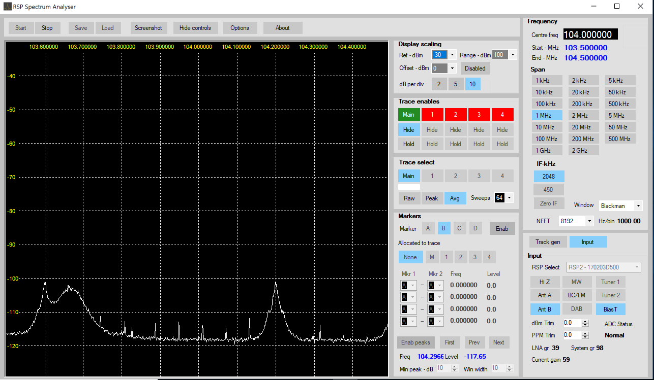

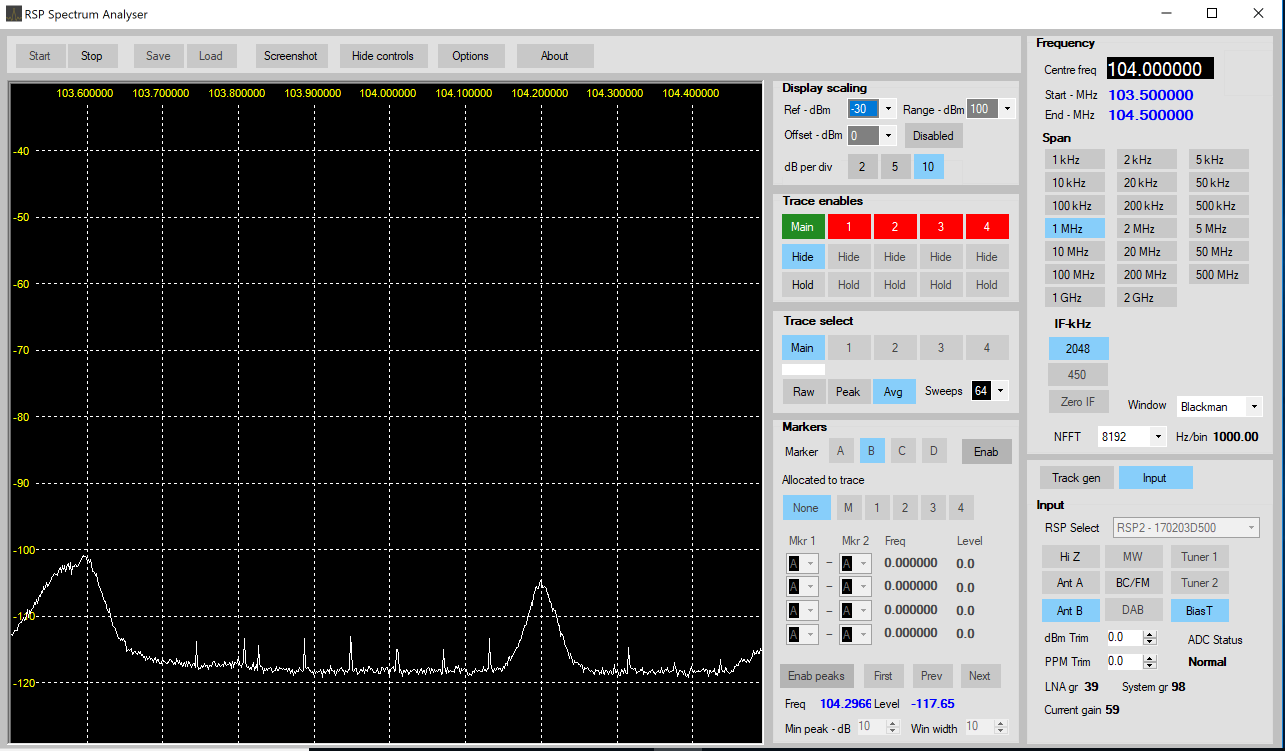

Hi MikeMike H wrote:I had attached the plots (or so `I was told...) I will try reattaching them in two submissions this time. It is not so much the noise floor that increases, but the shape of the curves as well, especially around marker 'C'. Many thanks, Mike.
Regarding the noise floor, the plots are as I would expect them to be for each reference level setting. As the reference level is decreased from 0dBm to -100dBm, the noise floor will drop, and more of the signal will be visible. I have no answer for the anomalous signal that appears at 103.85MHz at reference level -30dBm. Apart from that particular plot, everything looks fine to me. Am I missing something ?

Yes, that particular peak at 103.85MHz @ -30dBm reference was the aspect that set me off thinking that something was wrong and some more complicated interaction was going on. In a way, I feel comforted that the peak at 103.85MHz is not expected behaviour (by you at any rate), and I will try repeating that measurement.

I found some more info on the peak at 103.85MHz... It is repeatable, but... If I start the analysis with averaging using the 'Start' button on the top panel then the peak is not present. However, if I cycle through the reference values while in averaging mode then after 10-20 changes in the ref value, the anomalous peak will become present. It is not aways visible, and -30dBm seems to show it particularly well. It is not always in the same place and seems to shift frequency. Stopping and restarting the analysis using the button on the top panel seems to fix the problem.

Thanks for the information Mike. That seems like a very odd one. I've added it to the list of strange things to investigate.Mike H wrote:I found some more info on the peak at 103.85MHz... It is repeatable, but... If I start the analysis with averaging using the 'Start' button on the top panel then the peak is not present. However, if I cycle through the reference values while in averaging mode then after 10-20 changes in the ref value, the anomalous peak will become present. It is not aways visible, and -30dBm seems to show it particularly well. It is not always in the same place and seems to shift frequency. Stopping and restarting the analysis using the button on the top panel seems to fix the problem.

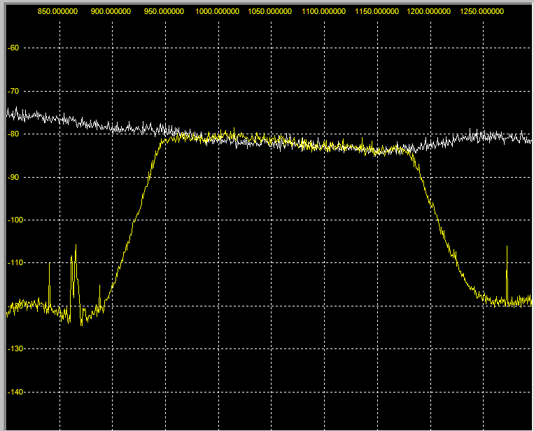

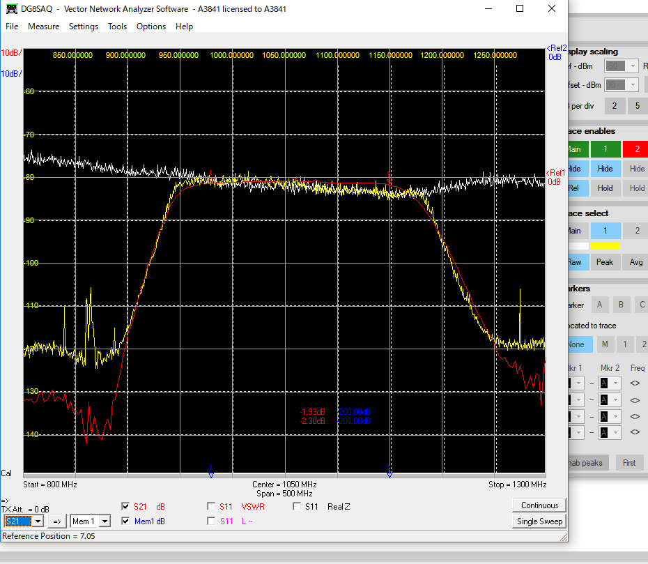

By the way, I have measured an ADS-B (1090MHz) BPF filter with both RSP2 SAS 1.0A and VNWA (vector network analyzer). Please see the attached. The results with SAS 1.0A almost coincide with the ones with VNWA. (I used a transparent display function of VNWA to overlap the traces.) If a through calibration function would be provided for the future versions, it should be perfect!

Thanks for your reply.1) The "Ref-dBm" control sets the reference level at the top of the screen. In addition, it sets the LNA and IF gains, according to a pre-defined look-up table. At higher reference levels, the total gain will be low, the lower the gain, the higher the noise floor will be. At lower reference levels, the gain will be higher, resulting in a lower noise floor. This is normal.

Those screen shots make me feel very happy - Thank youja8scd wrote: By the way, I have measured an ADS-B (1090MHz) BPF filter with both RSP2 SAS 1.0A and VNWA (vector network analyzer). Please see the attached. The results with SAS 1.0A almost coincide with the ones with VNWA. (I used a transparent display function of VNWA to overlap the traces.) If a through calibration function would be provided for the future versions, it should be perfect!
Can you explain what you mean when you say a 'through calibration function' ?

I mean such a function by which the white trace becomes flat (0dB - reference line) so the yellow trace will be displayed in relative to the white one. This is because noise generators will not give out uniform output from 1kHz to 2GHz, and also we don't need absolute dBm readings when it comes to measuring filters.
