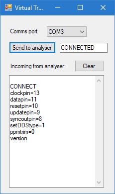

It looks as if you have established a comms link between the analyser and virtual Trackgen. The analyser is expecting to see "CONNECTED" back from either the Arduino, or virtual Trackgen. Type CONNECTED into the box on virtual Trackgen and click "Send to analyser". This will (should) complete the handshake between the two, the red patch should now change to green.

Shows response from the analyser after virtual Trackgen issues the CONNECTED response.

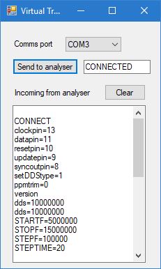

The tacking generator is started on the analyser - this shows the data sent from the analyser to virtual Trackgen.
