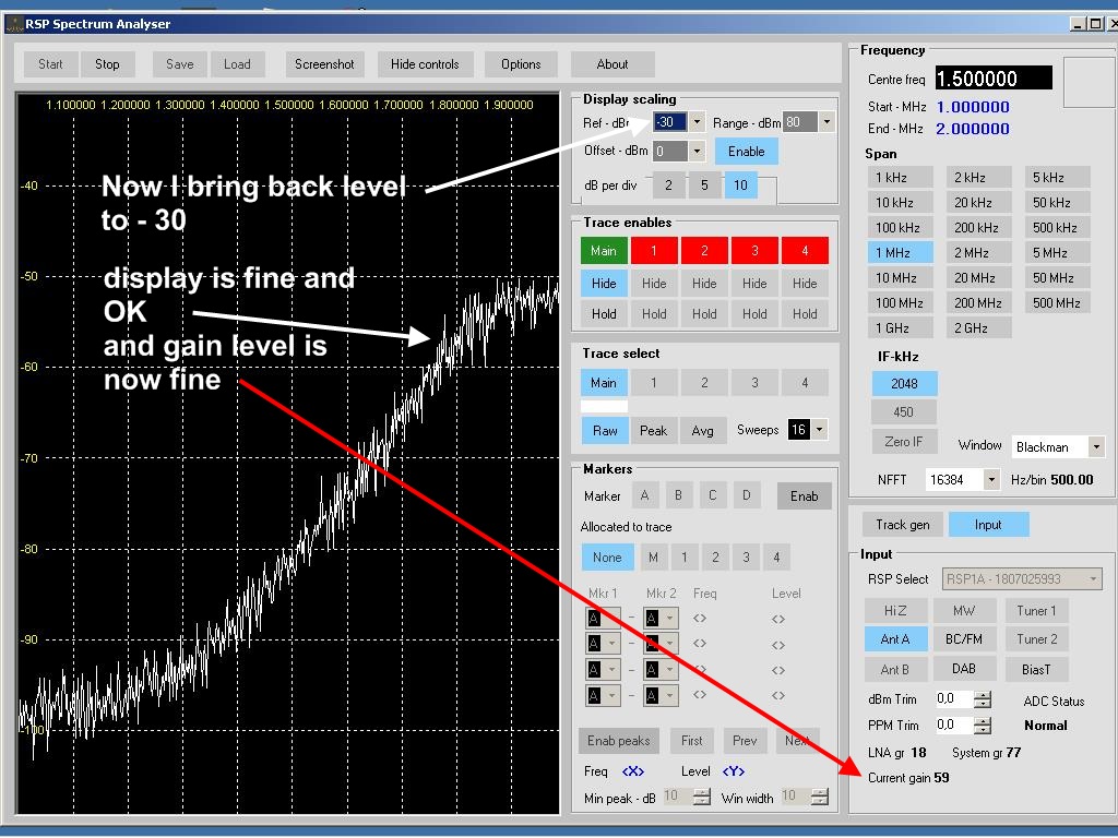

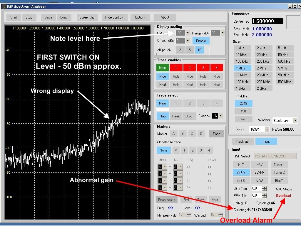

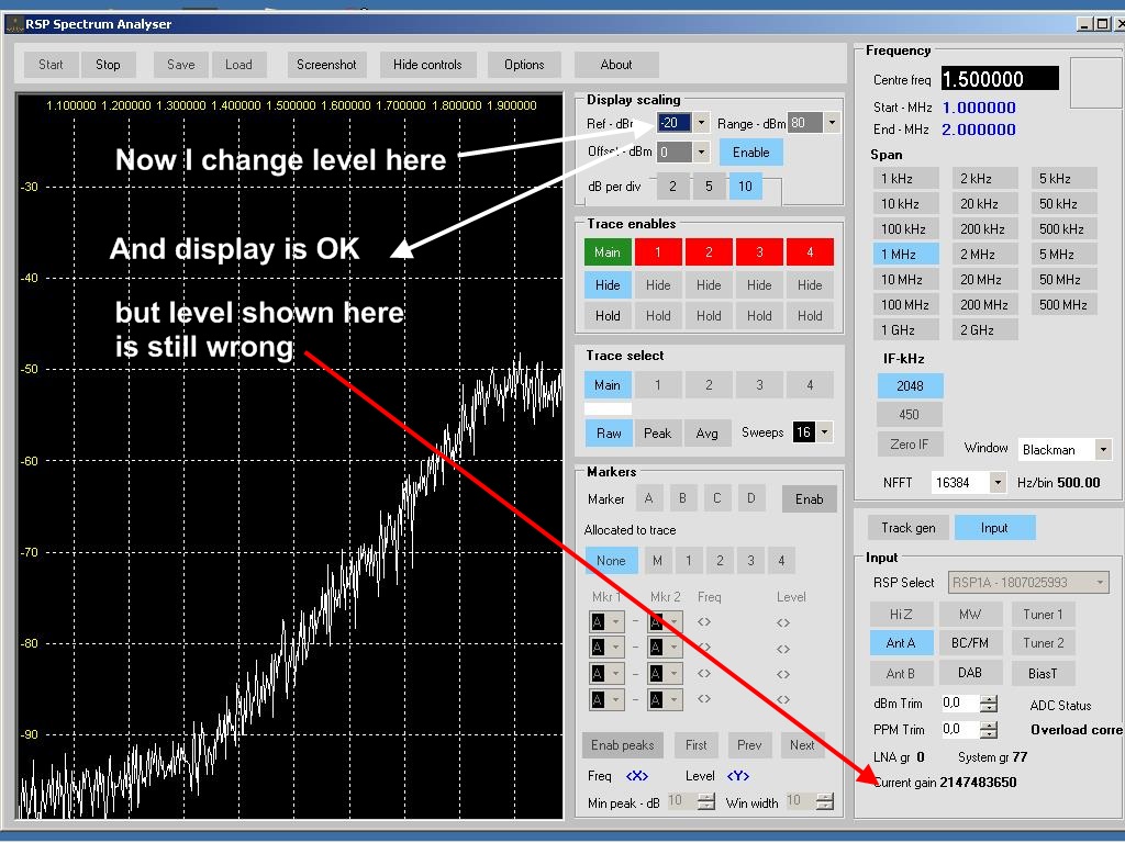

Hi Steve,
There is a "false start" problem whereby on switch on of a measurement previoulsly set up and OK the Spectrum Analyser comes up wrong, like if it was overloaded. Then, by altering the REF level and going back the SA recovers, as shown in the enclodes pics. Otherwise I have been working for several days with this 1.0a software and it is really a dream!
Kind regards,
Gianfranco
SA False Start 1.jpg (253.93 KiB) Viewed 179047 times
SA False Start 2.jpg (256.59 KiB) Viewed 179047 times
