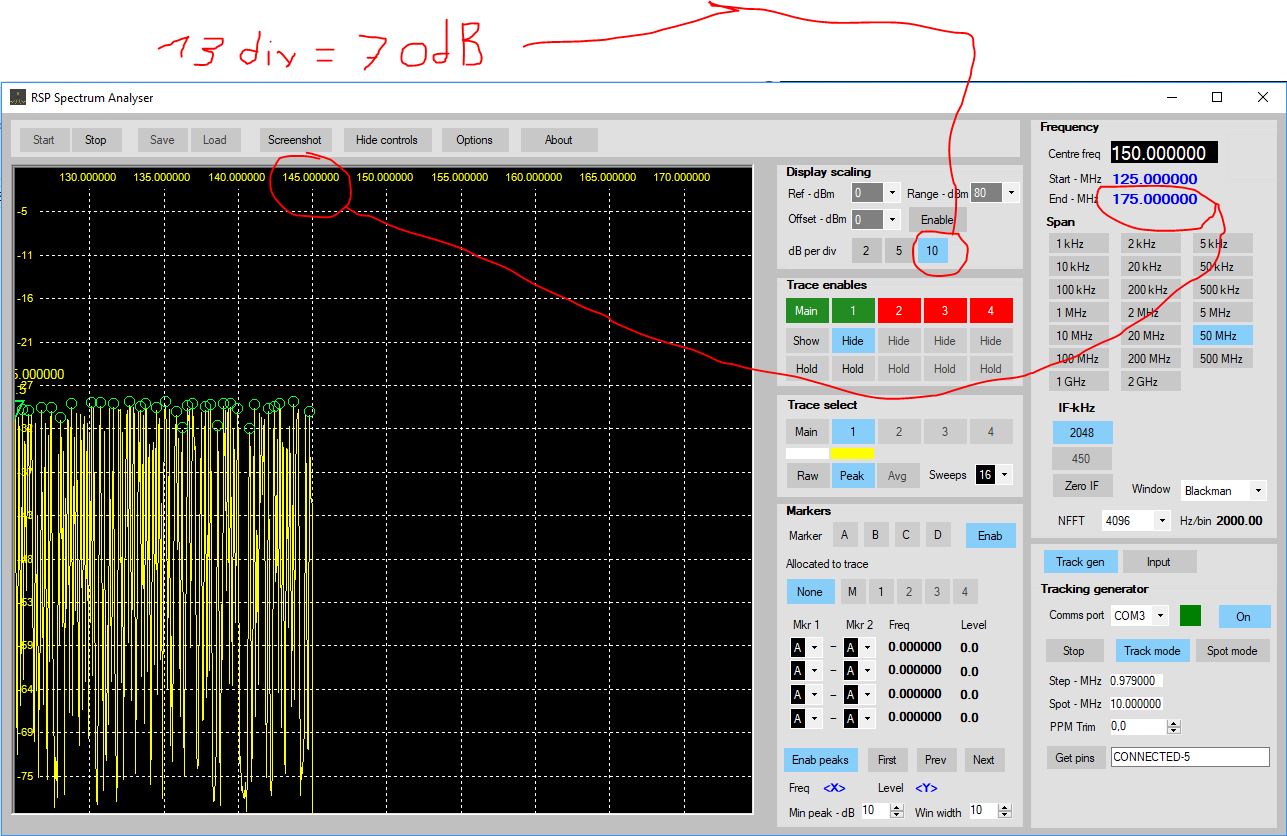

papyblue
Posts: 4
Joined: Tue Apr 02, 2019 2:27 pm
Re: Feedback for version 1.0a here
Post by papyblue » Fri May 03, 2019 3:23 pm
Hello Steve,
I have two new problems to get back to you:
The display is 5.3 dB per division instead of 10 and the scan does not go all the way.
thank you.

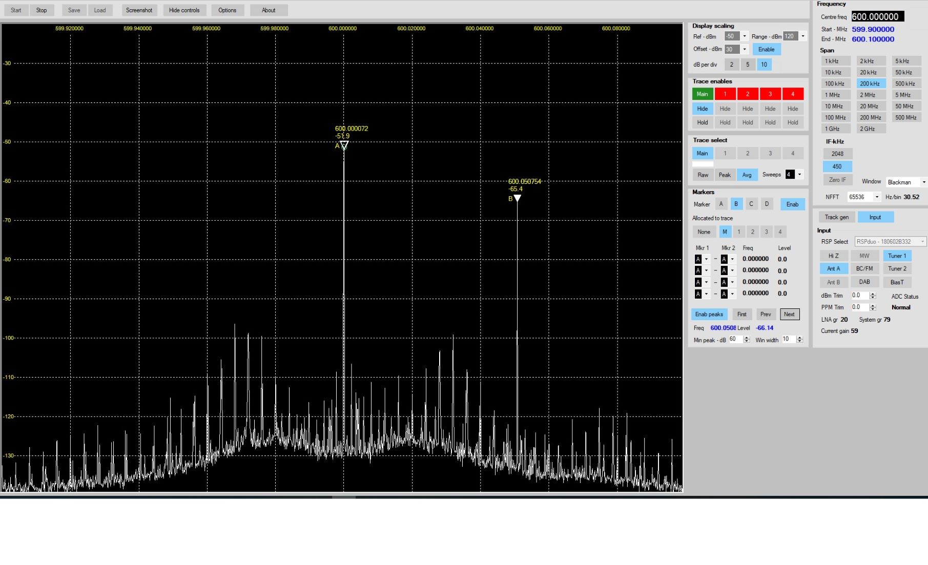

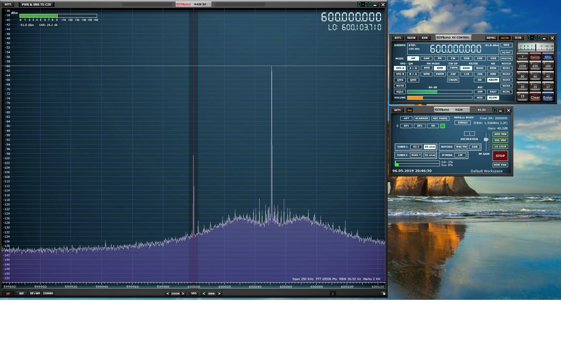

One of my applications for using the RSP spectrum analyser is looking for spurious outputs of an SDR transmitter. Especially for the higher spans of 500 MHz -1 GHZ – 2 GHz there are so many high-level clock spurious of the RSP-Duo, with n*24 MHz, that it is hard to recognise any spurious of my own input signal.
Because I could not remember seeing such high clock spurious in SDR Uno I made a comparison between SDR Uno and the RSP Spectrum Analyser. Using a LImeSDR I generated a -60 dBm signal at 600.05 MHz and measured the level of this signal and the level of the of the 25th harmonic of the 24 MHz clock at 600 MHz. I chose similar settings for both programs
The results show a big difference. In SDR Uno the clockspur at 600 MHz is at -98 dB. In the RSP Spectrum Analyser with 50 dBm Ref level the LimeSDR input is measured with –65.4 dBm but the 600 MHz clock spurious is measured at -51.9 dBm, that is 46 dB stronger than in SDR Uno. Similar results with other Ref levels.
Also, the RSP Spectrum Analyser output shows a lot of low-level spurious signals, that are not visible in SDR Uno.
Maybe a possible reason is that the spectrum analyser has allocated more of its gain after the circuit parts where the clock spur is coupled in and that SDR Uno has its gain more before those parts?
Another point that I mentioned before is that after selecting tuner 1 in the output screen I see a mix of the signals that are connected to both tuner inputs. The output level of the “wrong” output signal corresponding to the tuner2 input is so high that it can’t be just coupling from tuner 2 input to the tuner 1 circuit. The only possible reason that comes to my mind is that the multiplexed output signals of tuner 1 and tuner 2 are not demultiplexed in the correct way.
Hope you find a solution for this problem because I really like the RSP Program.
