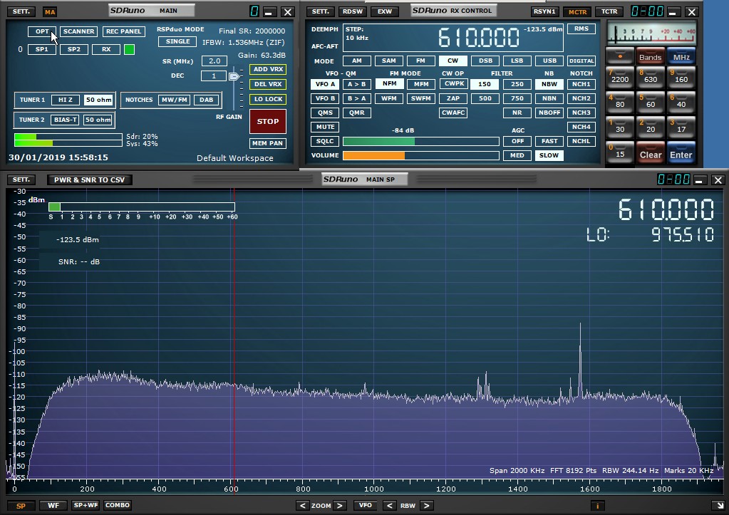

Thanks to glovisol for the links and Mike2459 re comments on frequency sweeps. I'll have to check my Siglent. As for attenuation, a while back I invested in a really useful 110 dB rotary attenuator that I use frequently when I want to very gradually introduce a signal into an SDR or similar.
For now, I found the broadband noise source that I bought on eBay a couple of years ago:
https://www.ebay.com/itm/SMA-noise-sour ... 1831285650
and connected it through the attenuator to the filter under test and then to an RSPduo, which is connected to a PC running SDRUno.
My first test was of a low-pass filter designed to pass the bands below 500 kHz but block the MW BC band. Here is the result on SDRUno:
Interesting to see the filter characteristics. I definitely won't be using this filter when trying to hear WWVB on 60 kHz.

I am using a home built 2 pole elliptic LP filter with a response very similar to yours. Think the poles are slightly higher in frequency. I'm using it for NDB chasing. There is some noticeable attenuation starting around 500 KHZ.
As to WWVB reception this filter has not impacted it. It could be the antenna port, coupling transformers or even the antenna rolling off the lows. I have mine connected to the Hi-Z port. That should be easy to verify by removing the LP filter and comparing results.
Re: Evaluating RF filters?
My biggest challenge on the lower bands is the extremely strong MW AM BC environment we have here in the Los Angeles area -- 37 broadcasters nearby, including a number of very powerful stations 5 to 6 km from me. So one of my biggest priorities is to do everything possible to attenuate those signals. Ideally I'd like to fabricate a band-reject filter that strongly attenuates ~520-1700 kHz, but with sharp skirts so that the 630m (~475 kHz) and 160m (~1.84 MHz) ham bands are not impacted significantly. I talked to one guy who designs and sells RF filters, and he said he looked into this but gave up because the filter design was going to be so complex.Mike2459 wrote:I am using a home built 2 pole elliptic LP filter with a response very similar to yours. Think the poles are slightly higher in frequency. I'm using it for NDB chasing. There is some noticeable attenuation starting around 500 KHZ.
Actually I meant that mostly as a joke -- though I was surprised to see my filter's low-end skirt put 60 kHz about 45 dB below most of the LF spectrum. In practicality, WWVB is such a strong signal that I can almost always hear it well even when using this filter.As to WWVB reception this filter has not impacted it. It could be the antenna port, coupling transformers or even the antenna rolling off the lows. I have mine connected to the Hi-Z port. That should be easy to verify by removing the LP filter and comparing results.

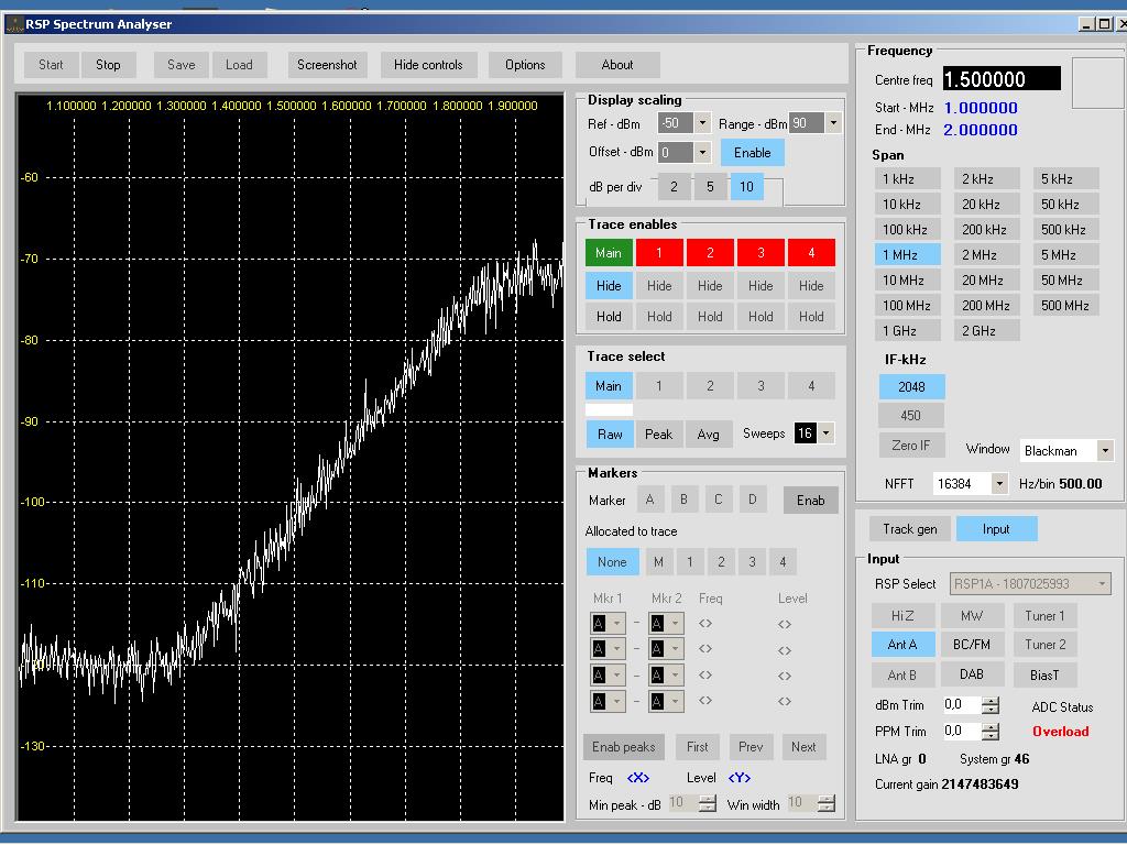

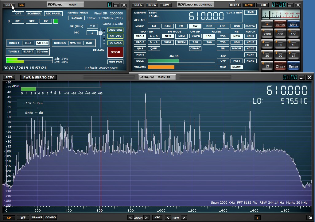

Franko, this is what you need to get rid of MW interference, it is effective and easy & inexpensive to build, just look at the thread.- Attachments
- Spectrum 0 -1900 KHz no HP Filter.jpg (196.96 KiB) Viewed 83627 times
- LF&MF Elim. Filter 1.RSP-1A.jpg (143.4 KiB) Viewed 83627 times
