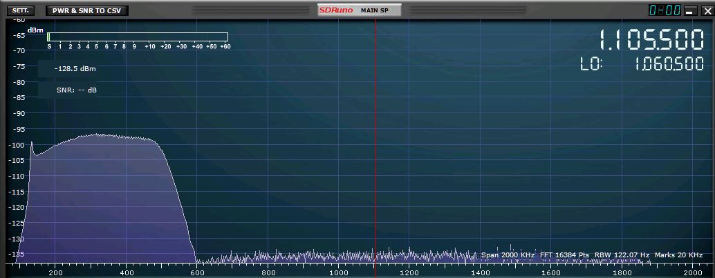

Here is a scan of my homebuilt 3 pole (not 2 pole) elliptic filter. Had to set the RSP2 to maximum RF gain and disable IF agc and manually set it to a low level to keep receiver noise from masking the low level response while trying to avoid ADC OL. Used a program called RF Filter Designer to determine component values. All of the capacitors are SMD's, the coils are wound on small toroids. Set up my FG504 to start the sweep at 100KHZ and end around 4 MHZ.

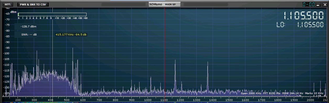

Post by Mike2459 » Sun Jul 14, 2019 6:10 pm
Here is a scan of the filter in use. My local RF environment is no way near as challenging as that of LA!

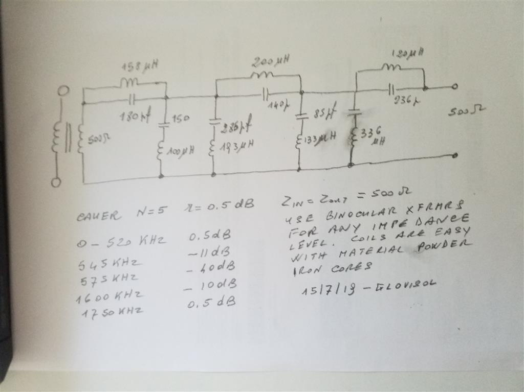

My challenge is that I'd like to build a band-reject filter that will pass frequencies from 0 to about 520 kHz, and also pass frequencies above about 1700 kHz, but strongly attenuate the band from ~520 to 1700 kHz. The reason for this is that I have a single antenna connected to a high-quality four-way splitter, which feeds four SDRs monitoring bands from 2200m to 6m.
One idea would be to build a low-pass filter and also a high-pass flter, and place them in parallel so that they function together. But I've been warned that combining multiple filters runs the risk of having them interact in undesirable ways.

As to the sweep. My unit has an adjustable sweep from .1ms to >10Sec. For this I used .1ms but it's not critical for a spectrum display as long as it is not too slow. Just adjust it for the best display. Too view it on an O'scope the timing becomes more critical.

Having long ago prepared Excel spreadsheets for quick calculation of any type filters, once you plug in the available filter prototype tabulated data, I could quickly check your specification and the result is shown below. This filter is complex, but with easily realizable components, provided you stay on a Zo = 500 Ohm. You can then translate Zin & Zout to any impedance you need with binocular core ferrite transformers: this is a big advantage if you use long wire antennas and/or the HI Z input of the RSP. If you need less than 40/45 dB attenuation in the stopband, I can compute a simpler filter, perhaps a Cauer N= 3 prototype.
I am wary of automatic calculation software, because then the user tends to calculate filters without really understanding what he is doing.
Finally, if I may venture advice, for filter development and measurement the easiest and most practical setup is a cheap noise generator, such as the BG7TBL and the new Spectrum Analyser software, applicable to RSP processors. You can find many examples in my filter threads. For a lively discussion on Noise Generators, see:
https://www.sdrplay.com/community/viewt ... +generator
Hope this helps.

ERRATA CORRIGE: in the schematic I omitted to put the value of the capacitor in series with the 336 uH inductor: value is 215 pf. Sorry for that!

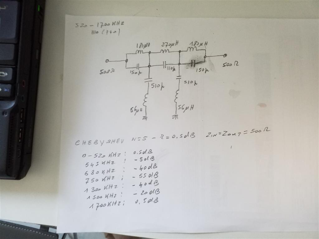

This filter is simpler & easier to make, it would be good as a first experimental unit. It is a Chebyshev N=5, r=0.5 dB, Zin=Zout=500 Ohm as the previous Cauer filter.
