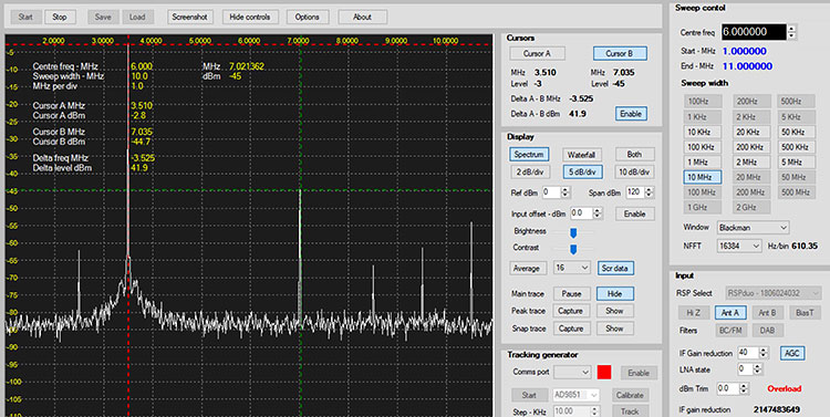

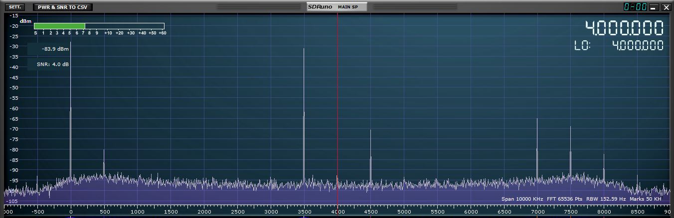

I've looked at the screenshots John Harper (AE5X) posted on his blog. I see that he has an input signal at around 0dBm. This will almost certainly lead to an overload condition, the Overload warning is shown on the analyser. It's probably best to try and keep the signal no higher than -30dBm. I also see that he has AGC enabled, and has no gain reduction set via the LNA state control. This control works in the same way as it does with SDRuno and reduces the front-end gain. He has the gain reduction set to zero.I suggest that you turn AGC off and use the AGC and LNA controls to set the gain manually. Setting the number of FFT bins to 32768 or higher will also result in a more stable display in terms of signal amplitude.
The following screen shots were taken with a signal input of 3.5MHz at a level of -30dBm. The overload warning has been triggered, please ignore that, It does not always get cleared once the overload condition is removed - one more for the bug list. I get the same signal at 7MHz as John. It's not produced by my signal generator (tested using a Racal RA6790 receiver) So it looks as if it's produced somewhere in the RSP2. I haven't had time to look into that yet. The third shot was taken as a control image and shows the analyser display with the signal generator output disabled.
The second shot shows the same -30dBm level displayed using SDRuno, note the close correlation in displayed signal levels.

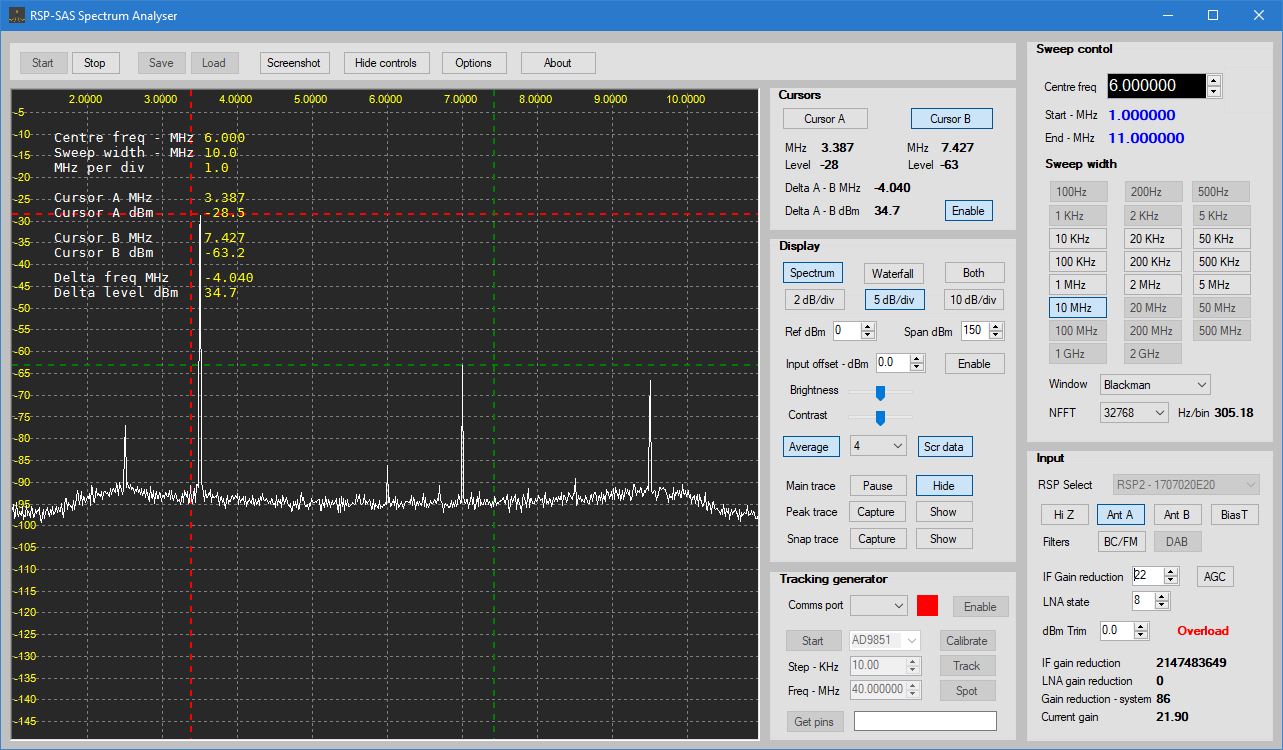

Re: Feedback for version 0.9a here
Continued...
This screenshot is the one that John Harper posted. I think there may be some confusion regarding the Ref-dBm control in the Display control panel. On a normal analyser, this control would set the appropriate gain or attenuation. Currently the control is just used to set the displayed dBm level at the top of the display and has no effect on gain. This was not made clear in the preliminary instruction manual. The next release will operate in the same manner as a normal analyser with the appropriate gain reductions being set according to the reference level selected. The AGC system will be removed entirely.
As mentioned in my previous post, I'm not sure what the signal at 7MHz is, it may not be the harmonic John was looking for as I get the same signal both with the analyser and SDRuno. Note the similarity in signals between his test, and my test with a signal generator.
I hope this is of some help. Let us know how your further testing goes, and thank you for your comments and observations.
