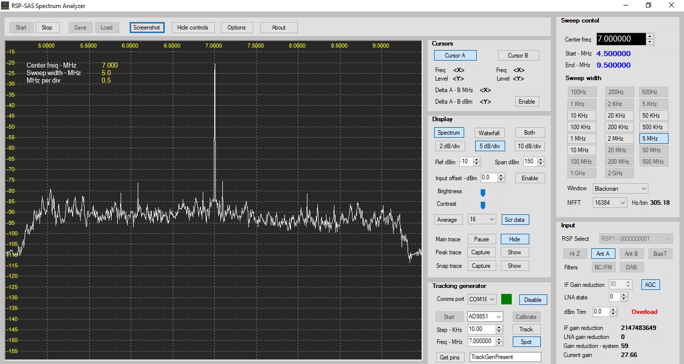

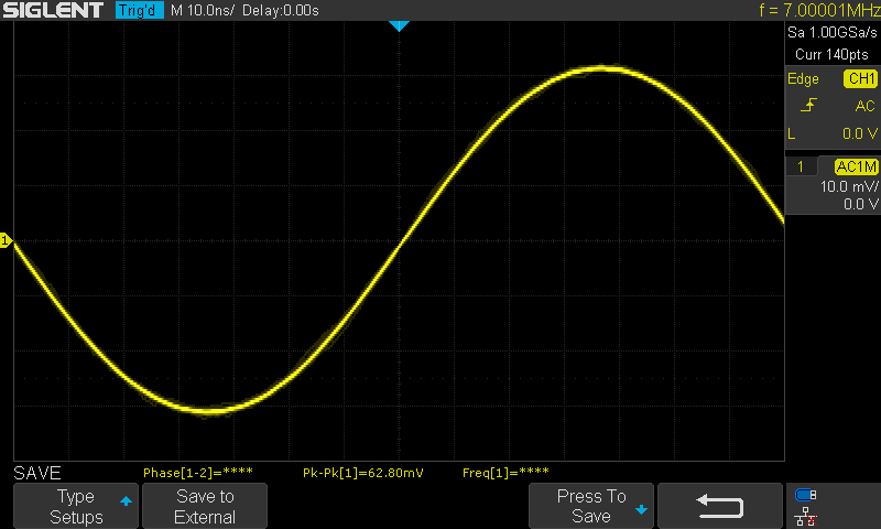

I am finally home from my camping trip and had time to get back to the tracking generator. I had ordered a package with an AD9850 and an AD9851 but the Chinese firm only shipped me an AD9850. The new one looks just like the old one that I couldn't get to work. The new one worked perfect on the first try with the Arduino 9850_test, running on an Arduino Mega. I then uploaded Trackgen_Mega2560_AD9850.hex using XLoader, and it worked!
I have tested it on different frequencies from 7mhz to 40mhz and it is right on frequency. I tried but spot and track. Now that I have it working, I can experiment with it and I want to build the AD9850 and the Arduino in to a shielded enclosure. That will probably be a Winter project.
Here is a picture of the waveform on my scope
This is what it looks like on the spectrum analyzer

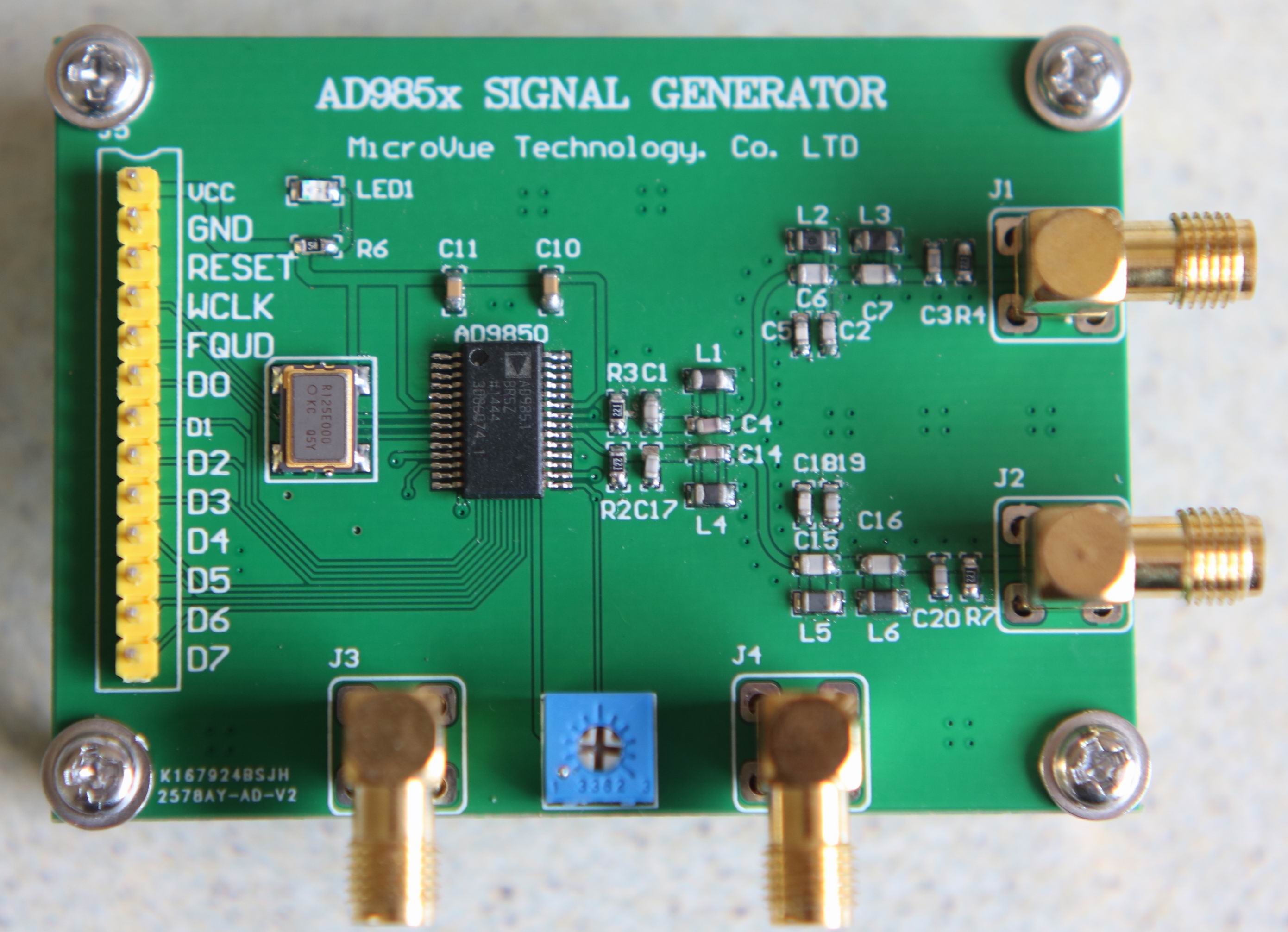

As you will have seen, DaveR was also having problems with an AD9850 - It seems that in both your case and his, the problem was caused by faulty hardware, and not faulty code - Good to know. If you get a chance, could you let us know what type of DDS module you have. Further back in the thread there are pictures of the modules DaveR and myself are using, are yours the same type ?

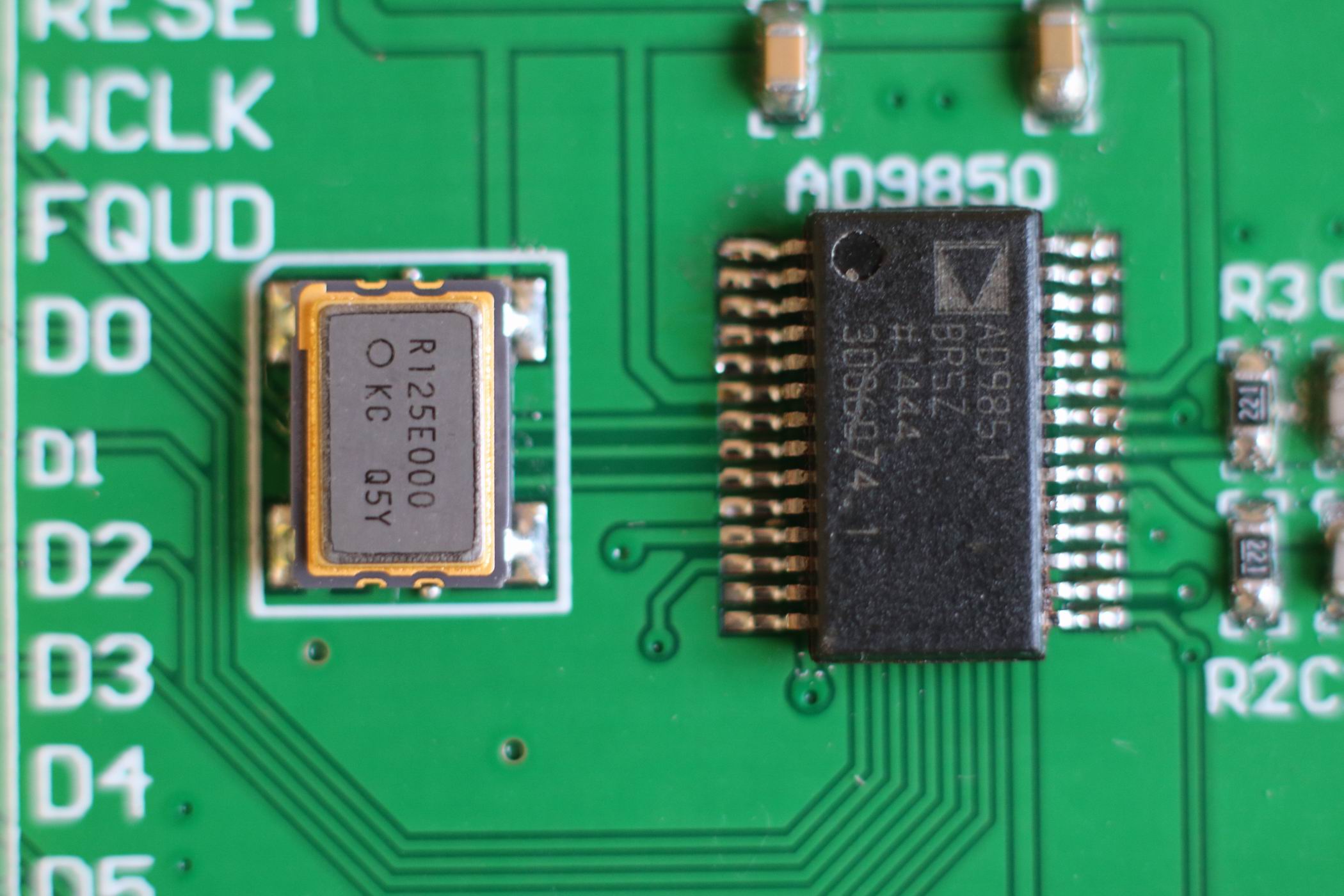

Some good news and some bad from me: the second AD9851 module I ordered arrived from China this morning, and it looks really nice - 3 times the size of the usual boards, with four SMA connectors, which would make it a very good board to build into a box as a small signal generator. Unfortunately, the board itself was obviously originally designed for the AD9850 chip, and has a 125MHz oscillator fitted instead of the required 30MHz one!! Consequently, due to the mismatch, the module will not work as either an AD9851 or AD9850. It does give some output, depending on the particular code used, but at totally unpredictable frquencies ranging from about 10Hz to 125MHz - a 1MHz sine wave comes out at 998Hz, for instance. You've got to love Chinese QA, haven't you?
We'll see what comes back from the supplier this time, but I'm starting to think that getting a working AD9851 module might not be an easy task - and the prices for them appear to be increasing daily!
AD9851 (v2).jpg (405.77 KiB) Viewed 33789 times
125 MHz (Wrong) Oscillator.jpg (265.65 KiB) Viewed 33789 times
The other thing I've noticed about the board is that there is no I-R pin on it for amplitude control (a board designed for the AD9850 wouldn't have had one to start with) unless one of the other pins has been assigned to the function, but I haven't managed to find any documentation for this board so far.
