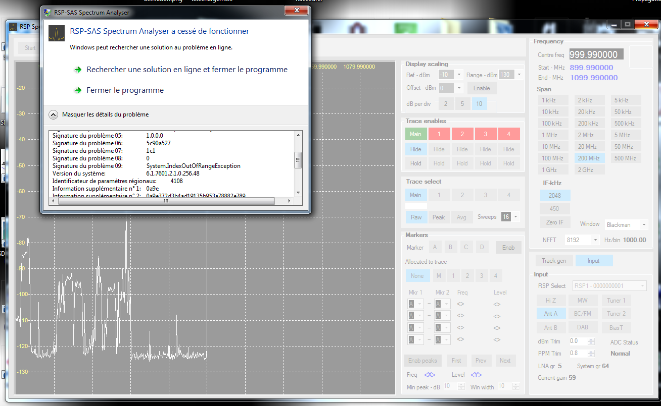

Hello,
I'm not able to go on 1000 MHz and over. I'm using a RSP1 and was able to go over 1000 MHz with the older version.
What i'm doing wrong ?
Thank you for your help.
73 QRO, Rudi, HB9ARI
PS Seems to be related to an out of range index

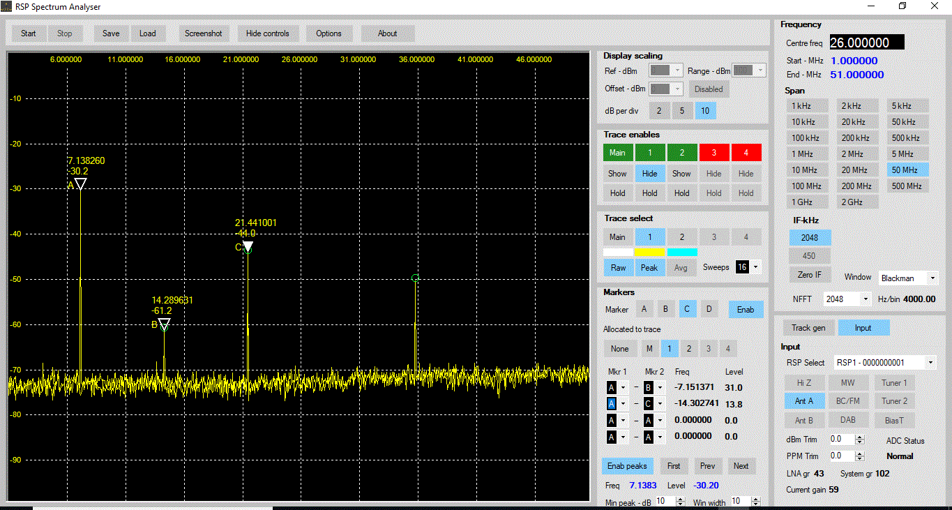

Re: Feedback for version 1.0a here
Thank you Steve!
I build and experiment with high power solid state amplifiers and I have been looking for an affordable spectrum analyzer for many years. I even used a surplus HP analyzer that must have cost many thousands of dollars when it was new, but nothing gave me what I needed. I needed good resolution at a small span so that I could see the IMD products, a large span so i could see (and measure the values) of the harmonics, and I also needed a way to evaluate the performance of the low pass filters.
I am very happy to say that your newest release of the software will do everything that I need. Thanks! I can take the Rigol spectrum analyzer off of my Christmas list.
My newest project is a dual LDMOS 2.8KW 160-6M amplifier. The timing of the software release is perfect. The amplifier is ready for testing with the spectrum analyzer. I will post screen snapshots when I complete the testing.
This morning I did a quick test of the ability to measure harmonics using an Elecraft XG3 signal generator. The placement of the marks takes some getting used to. I found the fastest way was to enable peaks and then use the "next" buttons to place the marker on the peak that I wanted.
https://www.sdrplay.com/community/downl ... ew&id=1592
Don
K9AQ

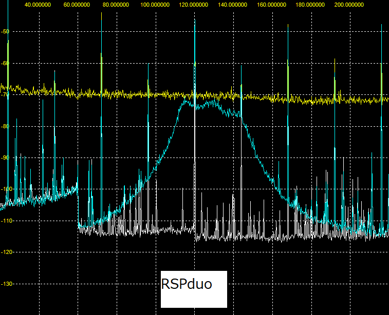

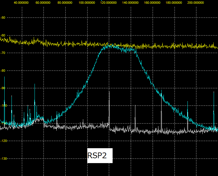

Hi Steve, thank you very much for your releasing the new version.
While I was measuring an airband BPF, RSPduo showed bit different operation than the other two models. I am attaching three screen shots showing the results with RSP1A, RSP2 and RSPduo.
Yellow Line: Noise generator is directly connected to RSP Ant port.
Blue Line: Noise generator is connected through an airband BPF.
While Line: Ant port is terminated with a 50ohm load.
RSPduo:
1) spurts at 24MHz x n are so conspicuous compared to those observed with RSP1A and RSP2.
Also, noise floor of RSPduo seems quite noisy. Is there any reason you can think of, or is this totally dependent on the RSPduo hardware?
2) As the default, the BC/FM and DAB are enabled although those button ares not inverted. By clicking them twice respectively, the filters will be removed.
Yas - JA8SCD Tokyo

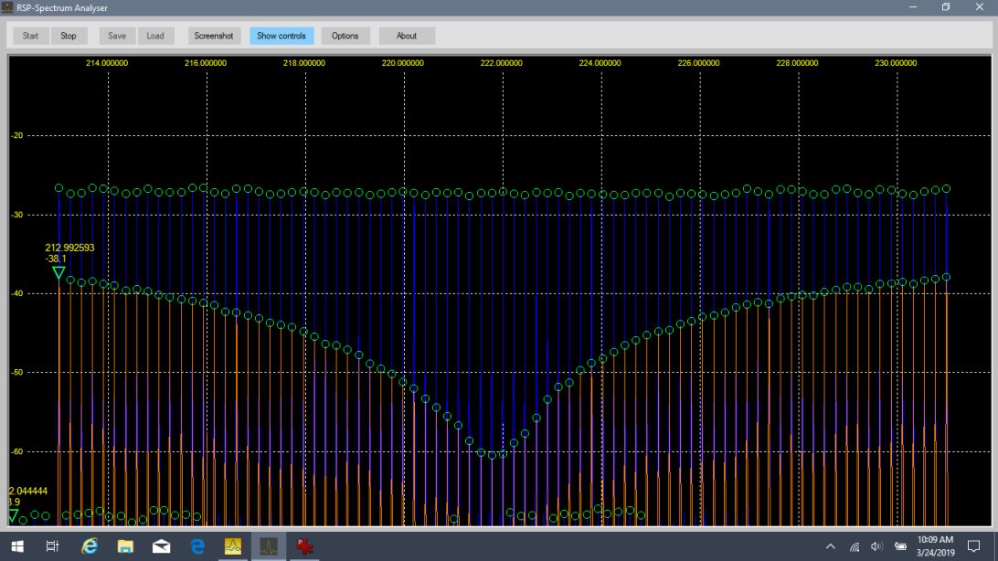

GREAT JOB! the improvements are fantastic!
only suggestion would be the addition of "sweeps per second" display. this would help when fiddling with the step rate on the signal generator.

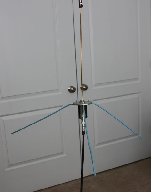

attached are some return loss sweeps of a homebrew 222Mhz ground plane vertical on the "indoor range".
