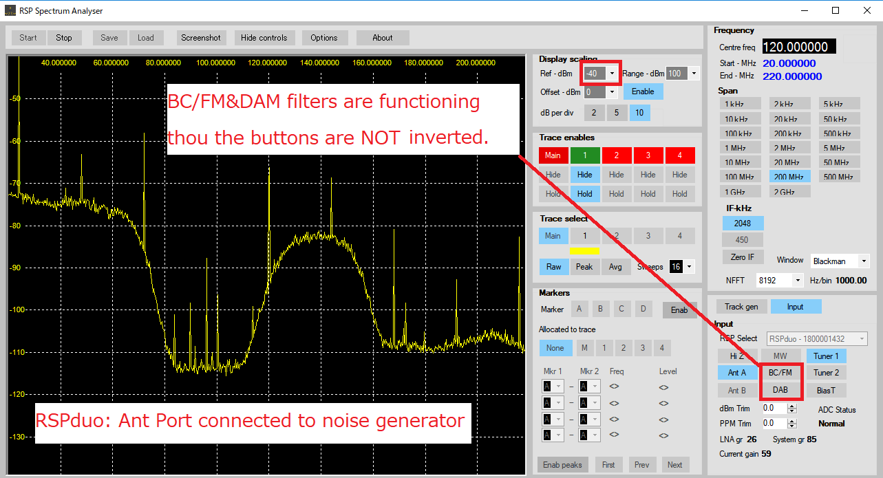

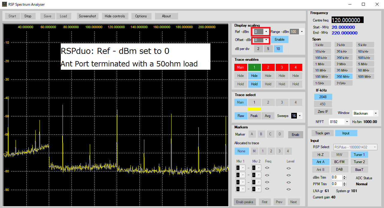

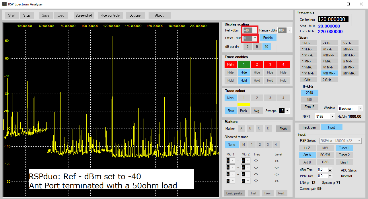

1) I will contact Tech Support, but could you kindly explain how you define "Ref - dBm" button. Please see the attached. When the Ref is set to -40dBm, the noise floor is quite low with so many spurs. Then, setting Ref to 0dBm shows a much higher noise floor with less spurs. My understanding is that the noise floor should not be changed regardless of how you set the Ref level - which should not affect the RF gain, but the the Ref - dBm level appears to act as RF gain control. (The Ref - dBm button needs to be pushed/toggled a few times before it displays the trace correctly - maybe a bug your have already reported.)
2) Please see the attached. Although the BC/FM&DAB buttons are not inverted (blued), the measurement shows that those filters are enabled. If the Ref - dBm is set to 0dBm, the noise floor is so high that the filter curve will not be displayed - all masked.

Thanks for your reply.1) - I think you should contact Tech Support regarding the spurious output and higher noise floor of the RSPduo. I also get a slightly higher noise floor with the RSPduo.
2) - BC/FM and DAB buttons: At startup, the buttons are (should be) grey or un-selected, and the filters are disabled. Clicking on a filter button should turn the button blue and enable the filter. I've just checked that operation here and it all seems OK. I'll do some further checking and see if I can get the same error you are getting.

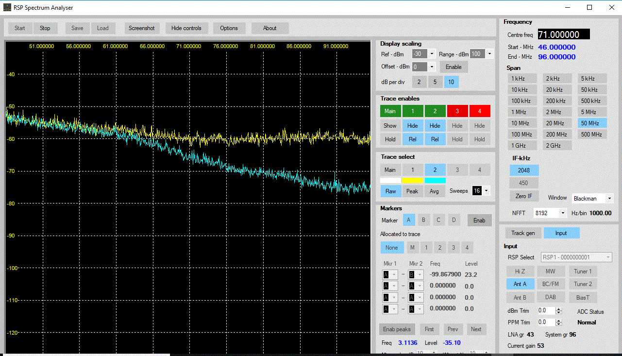

Hi, Firstly congratulations on the hard work that must have gone into producing such a useful piece of software as this. This looks like it will be very useful tool for me and is much appreciated. I have come across some confusing behaviour that I thought it worth mentioning. My understanding is that the reference level for the plot just sets the numerical level for the top of the plot. Is this correct or is it somehow used in the log function calculation?
I set up the spectrum analysis program with my RSP2 to look at two local stations in the FM band. I altered the reference level expecting to see just a vertical shift in the plot. Between a reference level of -80dBm and -40dBm the plots all looked as expected with just an expected shift. I noticed that the noise level changed a bit as well, but this was not large. However, for reference levels of -30dBm and -20dBm the whole shape of the plots changed.
Am I missing something or could there be a software problem? I attach the plots that I made with reference levels of -80dBm, -60dBm, -50dBm, -40dBm, -30dBm, -20dBm with the biggest discrepancies on the -30dbm and -20dBm plots.

1) The "Ref-dBm" control sets the reference level at the top of the screen. In addition, it sets the LNA and IF gains, according to a pre-defined look-up table. At higher reference levels, the total gain will be low, the lower the gain, the higher the noise floor will be. At lower reference levels, the gain will be higher, resulting in a lower noise floor. This is normal.
2) I have the filter buttons on the debug list already. They are working here, but I'll run through the code again.

Hi MikeMike H wrote:I have come across some confusing behaviour that I thought it worth mentioning. My understanding is that the reference level for the plot just sets the numerical level for the top of the plot. Is this correct or is it somehow used in the log function calculation?
The "Ref - dBm" control sets the reference level to the top of the dispaly, it also sets the LNA and IF gain controls via look-up tables. The "Offset" control just applies a vertical shift to the whole display.
I can't find the plots - did you attach them ?Mike H wrote: I set up the spectrum analysis program with my RSP2 to look at two local stations in the FM band. I altered the reference level expecting to see just a vertical shift in the plot. Between a reference level of -80dBm and -40dBm the plots all looked as expected with just an expected shift. I noticed that the noise level changed a bit as well, but this was not large. However, for reference levels of -30dBm and -20dBm the whole shape of the plots changed.
Cheers, Mike.
At lower gains (higher reference levels) the noise floor will be higher that it would be at higher gains (lower noise floor) - this is normal behavior.

I had attached the plots (or so `I was told...) I will try reattaching them in two submissions this time. It is not so much the noise floor that increases, but the shape of the curves as well, especially around marker 'C'. Many thanks, Mike.
