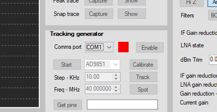

Arduino Virtual COM Port in Windows 10 Device Manager installation,
without Arduino HW is impossible mission so far.
Here have only RPI 2B+ available.
Must consider other way around :mrgreen:
Like this COM1 created with trial version of http://freevirtualserialports.com
real working version is this one -> https://www.hhdsoftware.com/virtual-serial-ports / not cheap ;)
In that case no RPI and my SW translator can run on PC.
So rather like to see some script language support on your future application, in way to run other signal generators...
73

As I understand it, are you are trying to use a virtual comms port to talk to the analyser, instead of using the Arduino ? You want to receive the analyser commands into your own software that drives the Synth ? Or have I misunderstood what you are trying to do ?
I use CSV List Browser which uses the Com0Com virtual port system. I'll have a quick look tomorrow and see if it's possible to do what you want.
