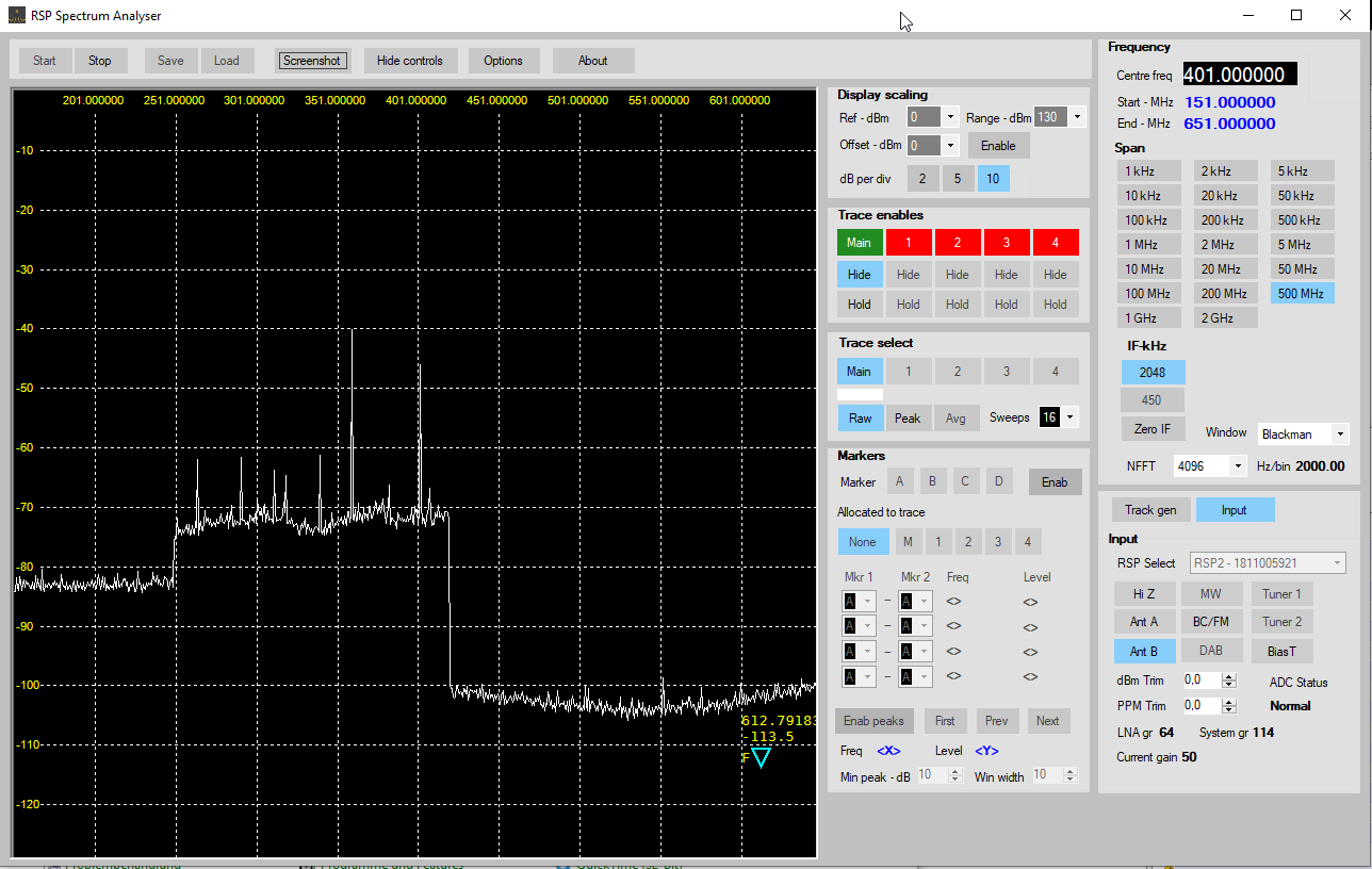

thanks for investing your time in this nice piece of software! I tested it with a RSP2 with SMA A and SMA B terminated with a 50 Ohm load to make the inputs as quiet as possible. I noticed that on the boundaries of the filters at 250Mhz and 420Mhz are big steps in the spectrum plots. Is the noisefloor level of the input circuit that different between the differnt zones ot the input/filter circuits? If i repeat this tests with a noise generator the steps are not that big but still about 20 db high
Is there a way to calibrate the diffent gain settings of the input circuits of each zone?

I noticed that on the boundaries of the filters at 250Mhz and 420Mhz are big steps in the spectrum plots. Is the noise floor level of the input circuit that different between the different zones of the input/filter circuits? If i repeat this tests with a noise generator the steps are not that big but still about 20 db high
many thanks and greetings
robert
Hi Robert
There is a known bug where at startup where the gains are not set correctly. Try changing the reference to another level, and then change it back to the original setting. This should now set the required LNA and IF gains (or more correctly, the gain attenuation) required for the selected reference level. Once this has been done, gains should now be correct for all reference levels. There will still be a change in the noise floor level as a sweep crosses a band boundary, but nowhere near the change in level shown on your screenshot.
It is not possible to calibrate the gain settings for each frequency band. Let us know if the above cures the problem.

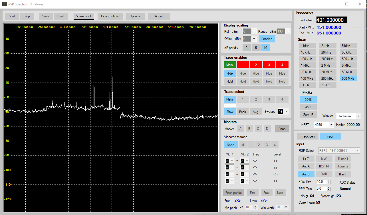

Hello Steve,
I am not sure if I got it right. I played around with the Ref-dBm-Setting and dht dBm Trim: changed it to a different value (e.g. 10) and changed it back to 0. The effect of the change was visible in the curve immidiatly. After changing it back in the next scan the same curve as shown in the screenshot was displayed again.
When i feed a noise from a noise generator into the rsp2 a diffent curve is shown up. Anyway its still a big step visible at 420 MHz.
If I scroll thru the same signal with SdrUno there is a diffence in gain in the Spectrum-View of maximum 5 dBm in the range between 200 MHz and 450MHz.
regards
Robert

srr00 wrote:Hello Steve,
Hi Robert
Ref-dBm is the only control that directly affects the RSP gain. The dBm Trim just adjusts the displayed level.
srr00 wrote: When i feed a noise from a noise generator into the rsp2 a diffent curve is shown up. Anyway its still a big step visible at 420 MHz.
This is because the analyser does not use AGC, SDRuno does, unless you have disabled it. Try the same test with SDRuno's AGC turned off.
Steve
