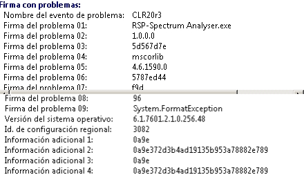

Post by angazu » Wed Aug 21, 2019 9:31 am
Hola.
No previous version installed. HDSDR and RSP1A run fine .
The program installs but when executing, the window for close application shows up.
Please, see attached error capture.
ANgazu.

sdrplay
Posts: 978
Re: Feedback for version 1.0b here
Post by sdrplay » Wed Aug 21, 2019 9:56 am
That seems to imply that it could be a locale issue. Could someone who can't get the application to start change their locale to English and see if it starts?
It could be the . vs , issue
salmantino
Joined: Wed Aug 21, 2019 10:12 am
Post by salmantino » Wed Aug 21, 2019 10:16 am
Buenos días, he cambiado el idioma en el ordenador a ingles y funciona perfectamente
Un saludo ......... Miguel
Translated: Good morning, I have changed the language on the computer to English and it works perfectly
