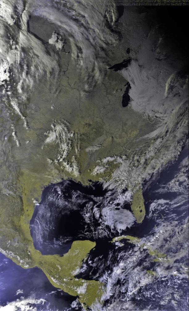

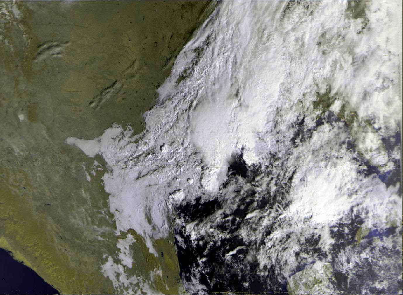

With available software today, you can use the RSP1A to receive HRPT signals from Meteor M2 as well as the NOAA satellites. You will need a motorized tracking antenna mount or to track by hand. The software to apply for decoding the signal is the USA-Satcom XHRPT Decoder and David Taylor's ReadHRPT. For Meteor M2 HRPT image reception, you will also need the MetFY3x Processor software and this can be used for post processing both Meteor and Fengyun satellite images. You will need an LNA, such as the NooElec SawBird GOES on the front end of the RSP1A. Here are two articles applying the RSP2 for HRPT reception from NOAA orbital satellites and/or Meteor M2. The RSP1A will also work well in this application. For the RSPduo, check with USA-Satcom on compatibility of the XHRPT Decoder.

NOAA 19 HRPT Image:
Meteor M2 Image:
Meteor MN2 1-27-2018.JPG (197.28 KiB) Viewed 16093 times
