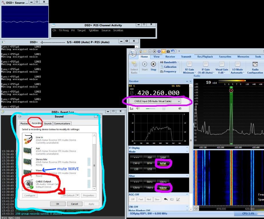

Hi, I have a problem with SDR console V3 when I start DSD PLUS you do not hear the audio, what is the problem? Ho l' rsp1a

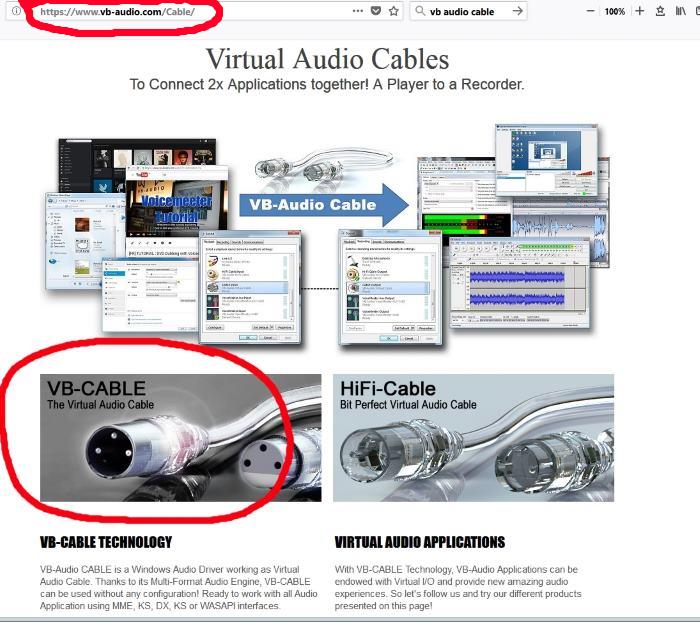

You need to use VAC or VB cable and select that output within Console v3 as shown
Re: Dsd plus e sdr console v3
I use vb-audio cable from http://www.vb-audio.com/cable/
Once setup open SPEAKERS in windows select RECORDING and select CABLE OUTPUT as default.
If you get a lot of feedback, Make sure you mute WAVE.
In windows PLAYBACK...Selecting your normal default sound playback device is fine.
If you double click on CABLE OUTPUT find and tick the box for LISTEN TO THIS DEVICE.
SDR-Console select CABLE INPUT for Audio device
Mode = NFM
filter=16khz
This should work well cheers Tony.
