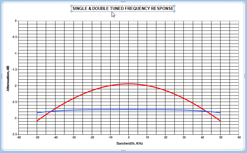

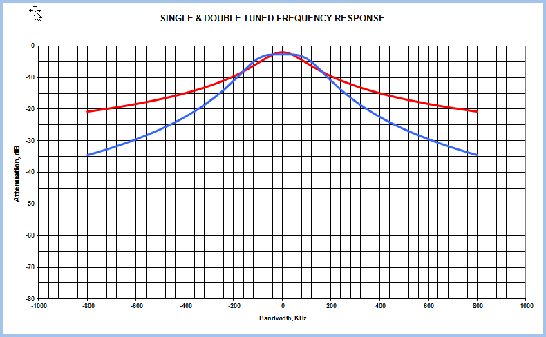

And calculated responses are shown below, RED for single tuned and BLUE for double tuned. From these responses we see that past the 80 m band edges (+/- 200 KHz) the attenuation is +/- 10 dB and goes to 30 dB @ +/- 600 KHz. In fact this response is so large we could just tune the pre-selector at mid-band and get full 80 m coverage and this could be a choice for some, by using fixed capacitors and a small air trimmer with lower Qu coils.

- 3.65 Varicap pre-selector narrow band frequency response
- 3.65 MHz pre-selector varicap tuned 1.png (17.66 KiB) Viewed 55657 times
- 3.65 Varicap pre-selector wide band frequency response
- 3.65 MHz pre-selector varicap tuned 2.png (21.83 KiB) Viewed 55657 times

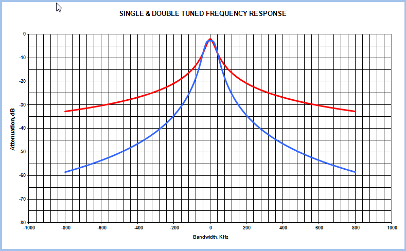

The calculated responses are shown below, RED for single tuned and BLUE for double tuned, in the two last pics. For the same insertion loss, the capacitor tuned pre-selector affords a significantly better selectivity (35 dB @ +/- 200 KHz) offering real protection to our RSP front end. By changing the coupling coefficient p (easily done by altering the value of the coupling capacitor as will be shown in the practical filter implementation next) narrow band selectivity can be changed at will.
The first pic shows the result of cascading two double tuned sections using a low noise amplifier in between, something I am going to test this coming fall.

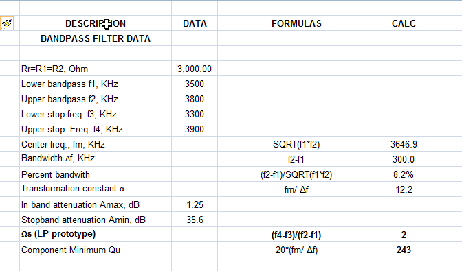

Since we know the center frequency and the passband edge frequencies, we need to put an approximate figure for the band-stop frequencies and find, by calculation, the EQUIVALENT LOWPASS PROTOTYPE. Looking at Figure 1 the impedance level set at 3 KOhm may seem a bit extravagant, but later on we shall see the reason for this choice. What we wish to obtain is a filter as plotted in Figure 2. So our filter must pass with no attenuation from 3500 to 3800 KHz and attenuate at least 35 dB @ 3300 KHz and below and @ 3900 KHz and above. From these data we compute the normalized cutoff of the lowpass prototype, which is 2. We choose a passband ripple of 1.25 dB, equivalent to 50%, (the higher the ripple, the higher the stopband attenuaton at the price of a small insertion loss) and finally we compute the required Qu of our coils and are happy to see it is only 243! This means that the filter can be realized with material N2 toroids for super performance, but also with modest size air coils. So this is surely a big advantage over narrow band filtering.

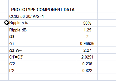

Low pass filter normalized component data is shown in Figure 3 below. This is tabulated data easily avaliable, as we shall see next. In the following post we shall see how to transform this data into the actual component values of our filter.
In this post we are going to look at another alternative: build a fixed pre-selector protecting the entire 80 band, 3500 to 3800 KHz. The design procedure is based on the transformation of a Cauer Low Pass prototype into its bandpass equivalent. In the example shown I give all the formulas for the simple calculations involved, so that anyone interested can design his own with Excel or with a hand calculator.

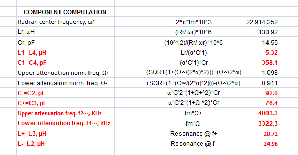

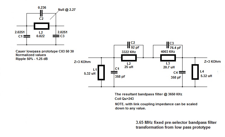

It should be evident that all data & calculations shown in the previous Figures 1 to 3 come from an Excel spreadsheet. Unfortunately I can only post pics of Excel, as the Forum software does not allow me to post the Excel file, otherwise all Forum members could be able to do these designs using the file directly, instead of writing their own. In all formulas SQRT() or RADQ() mean square root of.
This filter has more components than the simple bandpass double tuned narrowband filter, in fact is uses 4 coils, but the required Qu is significantly lower, at 243, for the same or lower insrtion loss.
We come now to the filter impedance level. The lowpass prototype and its corresponding bandpass filter can be de-normalized at any impedance level, as set in Figure 1. But we must recall that we must try and use the best Qu possible and by experiment we have seen that the best Qu values are in the range of approx. 2 to 50 uH, whether we use Powder Iron N2 material or reasonable size air coils. Now this inductance range and reasonable capacitance values, with these filter prototypes, can be obtained at a relatively high impedance level, which is also easily scalable to lower values by using link coupling. The advantage of having all calculations on one Excel spreadsheet is that we can quickly change parameters and immediately see the effect.
With links we can accommodate 50 to 50 Ohm, or, for instance, 450 Ohm (Beverage antenna) to 1 KOhm HI Z RSP balanced input. There is no problem of leakage inductance here, limiting the coupling action, for the simple reason that the filter is narrow band. If we were implementing a very wideband filter, then the leakage inductance variation over frequency would distort the filter response, as we have seen in the highpass filter thread.

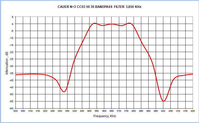

Finally, the frequency response plot shown in Figure 2 is exactly that of the bandpass filter: I presented it before, just to give the ida of what we were hunting for. The two side nulls shown in Figure 2 are of course at the resonant frequencies of the two parallel L/C circuits placed in series, at 3322 and 4003 KHz.
- FIGURE 4. Prototype and transformer bandpass filter schematics
- Filter transformation schematic.jpg (58.92 KiB) Viewed 55376 times

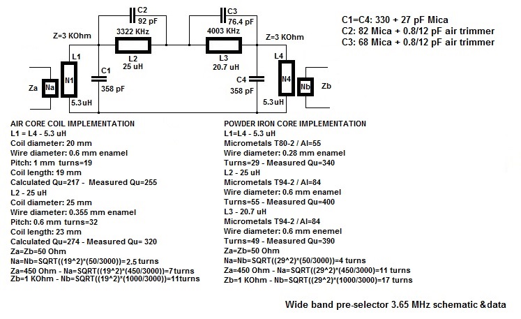

3.3 WIDE BAND PRE-SELECTORS - FIXED BANDPASS FILTERS @ 3.8 MHz - PRACTICAL IMPLEMENTATION
Figure 5 below shows the detailed practical implementation of the 3.65 MHz pre-selector, with air core coil technology, compared to Powder Iron toroid technology. At this frequency, due to the higher Qu's, Powder Iron is the winner and the tested filter provides the calculated performance with less than 2 dB insertion loss, compared to the 4.5 dB loss of the air core coils. Because of the presence of two coupling links with the inherent impedance matching and common mode isolation capability, no extra transformers and/or baluns are necessary. If care is taken in link positioning on the coils to minimise parasitic capacitance, the filter will also provide excellent rejection of locally generated noise.
It must be stressed at this point that this pre-selector, if properly constructed in a well shielded box, will let the RSP "see" its pass-band to the exclusion of any other signal from zero to al least 30 MHz. At higher frequencies the limitations of the parallel resonant circuits placed in series become evident and their parasitic capacitances will make higher frequency signals "jump" across. If desired this limitation can be eliminated by placing a very simple lowpass filter (with a cutoff around 20 Mhz) in series with the pre-selector.
To demonstrate the flexibility of application of modern filter synthesis, a low impedance (25 Ohm) filter, as opposed to the 3 KOhm impedance of the presente unit, will be shown next.
- FIGURE 5. Practical wide band pre-selector filter implementation
- Pre-selector Wide Band 3.65 MHz schematic.jpg (115.24 KiB) Viewed 55279 times

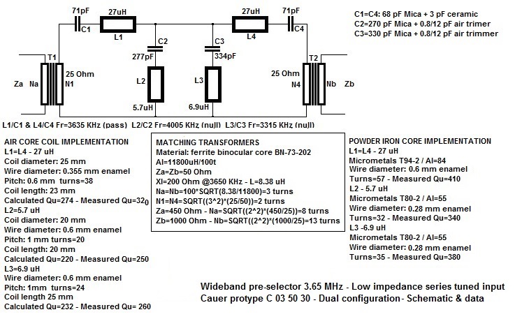

3.4 WIDE BAND PRE-SELECTORS - FIXED BANDPASS FILTERS @ 3.8 MHz - DUAL PROTOTYPE PRACTICAL IMPLEMENTATION
The Cauer low pass filter prototype comes in two versions: the shunt input version shown in Figure 4 and the series input version, where a shunt capacitor is replaced by a series inductor and the parallel tuned L/C circuit placed in series is replaced by a series tuned circuit placed in shunt, as shown below.
By using the dual prototype, reasonable and advantageous values for coils and capacitors are obtained at a low impedance level (25 Ohm) as shown in Figure 6, below. The series input version has the advantage of being low impedance, thus shielding requirements are less critical. Furthermore there is less chance of leaks at high frequencies, because the effect of parasitic capacitances is less marked with this topology.
The disadvantage of this filter is that additional transformers are needed to convert the 25 Ohm impedance to the required levels. Figure 6 shows transformers based on ferrite binocular core BN-73-202. These transformers are good for lab filter testing, but are unnecessarily wideband for the job and additionally introduce a relatively high level of parasitic capacitance with its unwanted common mode noise leakage. Better low capacitance transformers can be implemented with small toroids of 73 materal wound with non-overlapping primary and secondary windings.
- FIGURE 6. Practical wide band pre-selector filter implementation, dual prototype
- Pre-selector Wide band 3.65 MHz schematic (2).jpg (129.01 KiB) Viewed 55219 times
