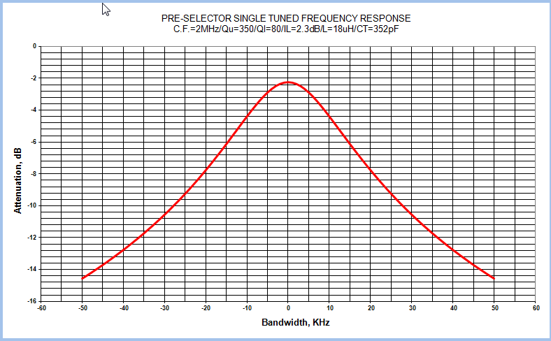

2.3. A DIGRESSION - NARROW BAND PRE-SELECTORS COMPUTER SIMULATION
In general a narrow band pre-selector consists of a tuneable single tuned bandpass L/C circuit placed between antenna output and receiver input. The inductor is wound on a Powdered Iron toroid core and the capacitor is an air variable tuning the L/C to the desired receive frequency. Two basic configurations are possible: (a) one toroid inductor with multiple switched taps or (B) multiple switched toroid inductors, one for each frequency band, to accommodate all frequency ranges between 1.8 and 30 MHz. Solution (B) is preferable as it allows different toroid materials, each with the best Qu for that frequency range, while (A) is more of a compromise. Under the above hypothesis, the following basic parameters have been chosen.
2 - 4 MHz .........Qu=350..........L=18uH
4 - 8 MHz .........Qu=320..........L=5uH
8 - 20 MHz .......Qu=180...........L=1.4uH
20 - 30 MHz ......Qu=140..........L=0.4uH
Powdered Iron materials considered are Amidon #2, #3 & #6. Q values have been obtained by the publication: Amidon RF6 Q Curves and the inductance values have been calculated in order to optimise Qu in the frequency range under consideration. For these conditions, the loading value for the L/C circuit has been selected to obtain maximum possible selectivity, but keeping the insertion loss always below 3 dB. The air variable considered has a standard capacitance range of 50 to 360 pF.
For each frequency range two selectivity curves have been produced for each boundary frequency. A NB, Narrow Band curve and a WB, Wide Band curve, so that adjacent frequency attenuation can be seen, as well as far frequencies up to +/- 800 KHz. Overalaps are also included, in order to appreciate the difference when switching between bands.

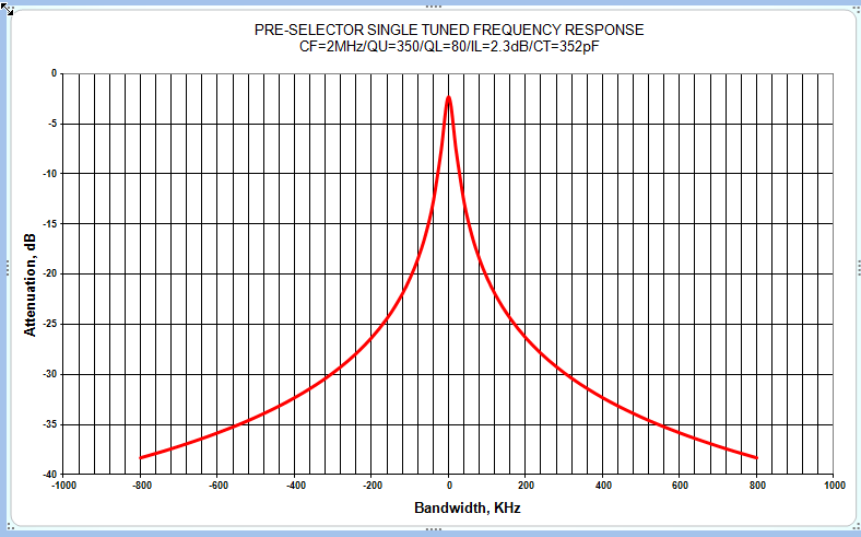

- FIGURE 1. Narrow band selectivity @ 2 MHz
- 1. 2MHz-NB.png (18.99 KiB) Viewed 59163 times
- FIGURE 2. Wide band selectivity @ 2 Mhz
- 2. 2MHz-WB.png (24.32 KiB) Viewed 59163 times

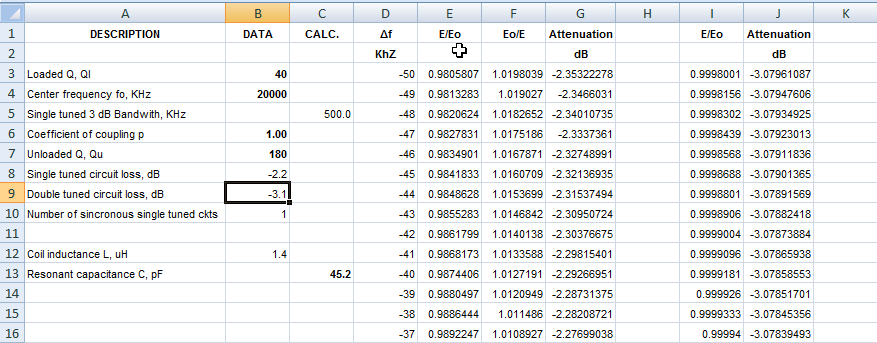

- FIGURE 3. Sreadsheet calculation sample
- Spreadshhet.png (31.06 KiB) Viewed 59163 times

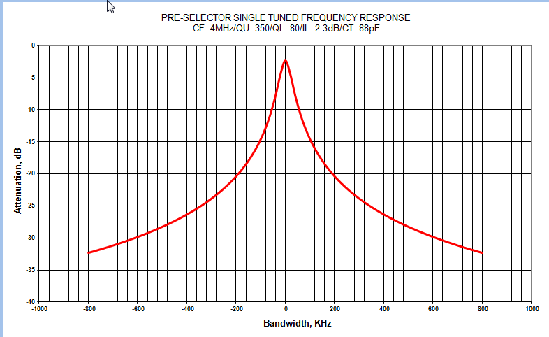

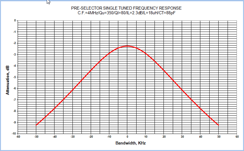

Uploaded below Figures 4 & 5 showing simulated performance @ 4 MHz. Figure 4 (under top title) shows the following parameters:
CF- Center Frequency: 4 MHz
Qu - Unloaded Q: 350
QL- Loaded Q: 80
IL - Insertion loss: 2.3 db
L - Coil inductance: 18 uH
CT - Tuning capacitance: 88 pF

- FIGURE 4. Narrow band selectivity @ 4 MHz
- 3. 4MHz-NB.png (18.33 KiB) Viewed 59131 times
- FIGURE 5. Wide band selectivity @ 4 MHz
- 4. 4MHz-WB.png (21.9 KiB) Viewed 59131 times

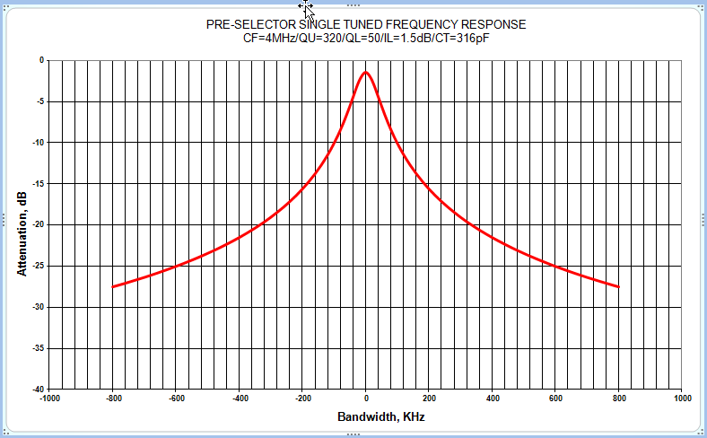

- FIGURE 6. Overlap - Narrow band selectivity @ 4 MHz
- 5. 4MHz-NB.png (18.1 KiB) Viewed 59095 times
- FIGURE 7. Overlap - Wide band selectivity @ 4 MHz
- 6. 4MHz-WB.png (22.95 KiB) Viewed 59095 times

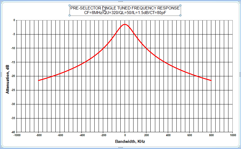

Uploaded below Figures 8 & 9 showing simulated performance @ 8MHz. Figure 8 (under top title) shows the following parameters:
CF- Center Frequency: 8 MHz
Qu - Unloaded Q: 320
QL- Loaded Q: 50
IL - Insertion loss: 1.5 db
L - Coil inductance: 5 uH
CT - Tuning capacitance: 80 pF

- FIGURE 8. Narrow band selectivity @ 8 MHz

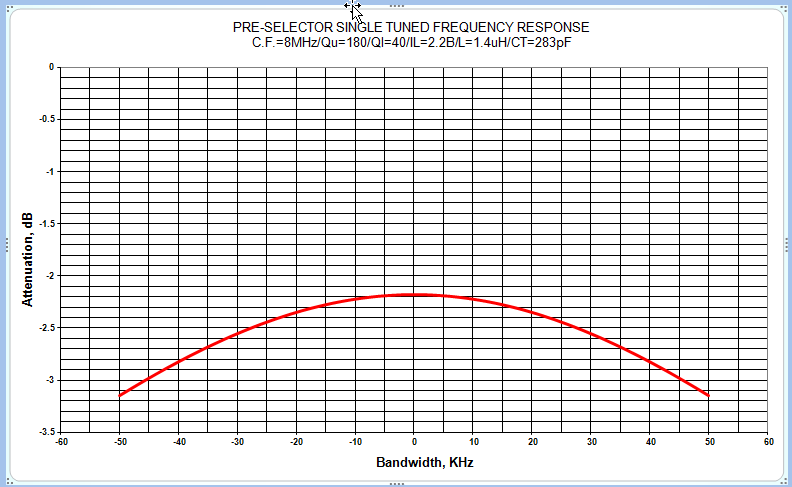

Uploaded below Figures 10 & 11 showing simulated performance @ 8 MHz. This is an overlap, having switched from the 4-8 MHz to the 8-20 MHz band. Figure 10 (under top title) shows the following parameters:
Qu - Unloaded Q: 180
QL- Loaded Q: 40
IL - Insertion loss: 2.2 db
L - Coil inductance: 1.4 uH
CT - Tuning capacitance: 283 pF

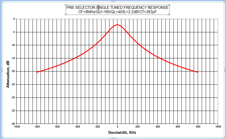

- FIGURE 10. Overlap - Narrow band selectivity @ 8 MHz
- 9. 8MHz-NB.png (17.08 KiB) Viewed 59004 times
- FIGURE 11. Overlap - Wide band selectivity @ 8 MHz
- 10. 8MHz-WB.png (22.65 KiB) Viewed 59004 times

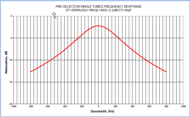

Uploaded below Figures 12 & 13 showing simulated performance @ 20 MHz. Figure 12 (under top title) shows the following parameters:
CF- Center Frequency: 20 MHz
QL- Loaded Q: 40
CT - Tuning capacitance: 45 pF

- FIGURE 12. Narrow band selectivity @ 20 MHz

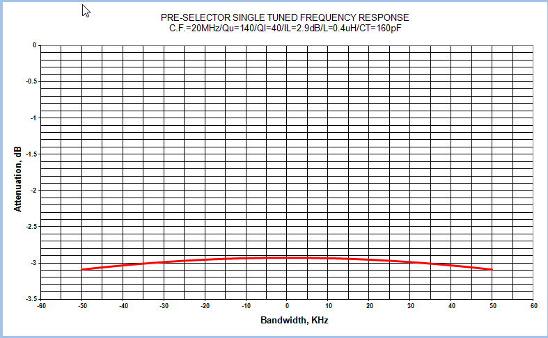

Uploaded below Figures 14 & 15 showing simulated performance @ 20 MHz. This is an overlap, having switched from the 8-20 MHz to the 20-30 MHz band. Figure 14 (under top title) shows the following parameters:
Qu - Unloaded Q: 140
QL- Loaded Q: 40
IL - Insertion loss: 2.9 db
L - Coil inductance: 0.4 uH
CT - Tuning capacitance: 160 pF

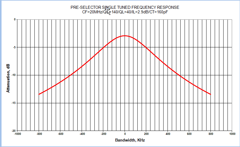

- FIGURE 14. Overlap - Narrow band selectivity @ 20 MHz
- 13. 20MHz-NB.png (13.99 KiB) Viewed 58944 times
- FIGURE 15. Overlap - Wide band selectivity @ 20 MHz
- 14. 20MHz-WB.png (19.97 KiB) Viewed 58944 times

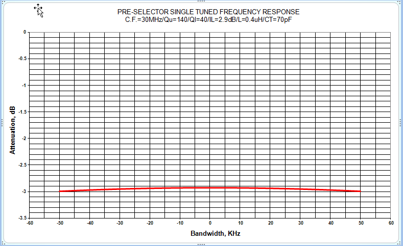

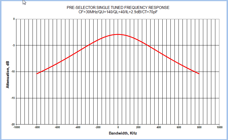

Uploaded below Figures 16 & 17 showing simulated performance @ 30 MHz. Figure 16 (under top title) shows the following parameters:
CF- Center Frequency: 30 MHz
QL- Loaded Q: 40
CT - Tuning capacitance: 70 pF

- FIGURE 16. Narrow band selectivity @ 30 MHz

- FIGURE 17. Wide band selectivity @ 30 MHz
