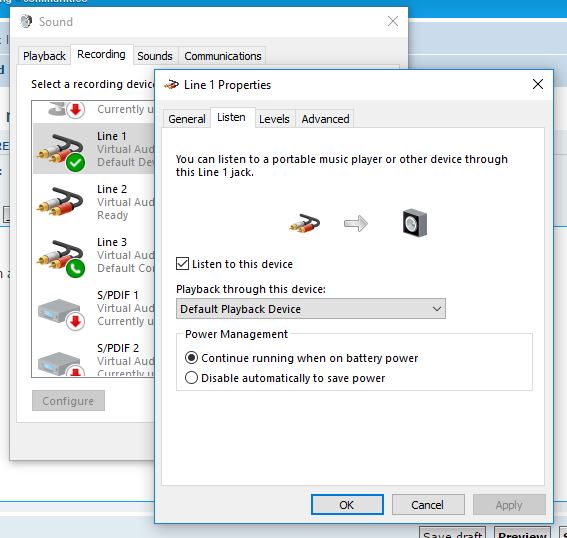

New user.. I've got my sdr-play running and have vb-cable set up.. Wanting to run MMSSTV and can see the incoming audio, but I've "lost the ability to actually hear the audio signals through your computer speakers." per the above post..
How do I fix this..??
What is the work around?

Click on audio properties for the virtual cable and on the listen tab, check the listen to this device and you will hear what the VC hears
Paul - NN4F
