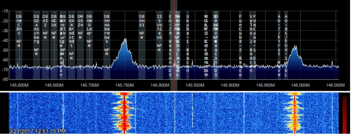

I always thought that VHF/UHF will be a last resort to enjoy the hobby if things go really bad on shortwave. Of course I was wrong. Until now, analog cable "only" caused interference on single channels, like these nice TV FM audio carriers in the 2m band coming from my neighbor's extremely crappy cable installation:
But analog cable TV is about to be turned off here, and the frequencies will be re-used for 7MHz wide DVB-C signals. It doesn't stop there, the cable companies want to implement a new internet technology (DOCSIS 3.1.) nation-wide on the cable nets until 2018, for frequencies up to 204MHz. If you consider the enormous level of this interference, this will be more or less the end of VHF reception in this neighborhood. My neighbor is almost 80 years old and will not be able to pay thousands of Eurobucks to repair his cable installation, or to sue the company that installed it some 30 years ago.
