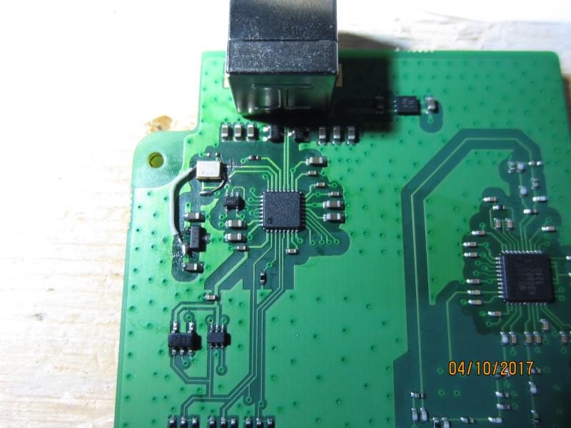

I did a similar rebuild of my rsp1, I found a 24Mhz tcxo on ebay and retrofitted it like in the attached pictures.
The two bottom pads is gnd,
top left is vcc (3v)
top right is signal out, I decoupled it with a 1nF capacitor.
its rock solid at exact right freq., before I had to go - 3,4 to ppm adjustment and was all over the place when I opened the outer door and the cold air got in.
