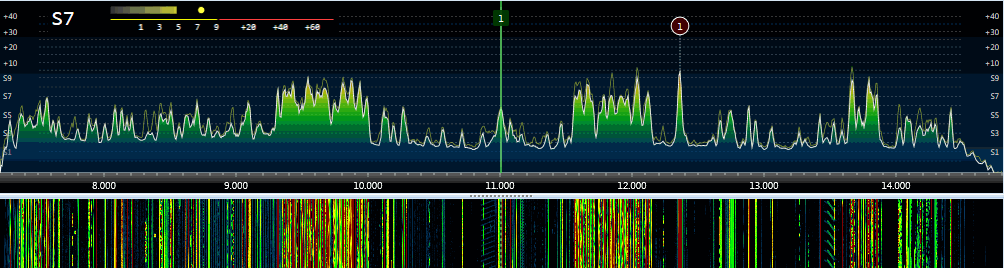

Yes, horizontally polarized (so physically a vertical, "upright") loop, center-fed (vis-a-vis the apex) which is not ideal (high main lobe elevation angles), but this way I could easily conceal the coax in the hedge and the loop is entirely invisible in the tree. Note that for LW/MW, even a 20m/60ft loop is still a "small" magnetic loop (SML), so the main reception lobes are perpendicular to the pane of the loop and I have no idea what their elevation angle would be.
The reason why I use 2 of these antennas (I christened them the "crappole" and the "craploop") that the loop configuration is pretty noisy above 5MHz at least at my QTH. This can be seen in this GIF:
