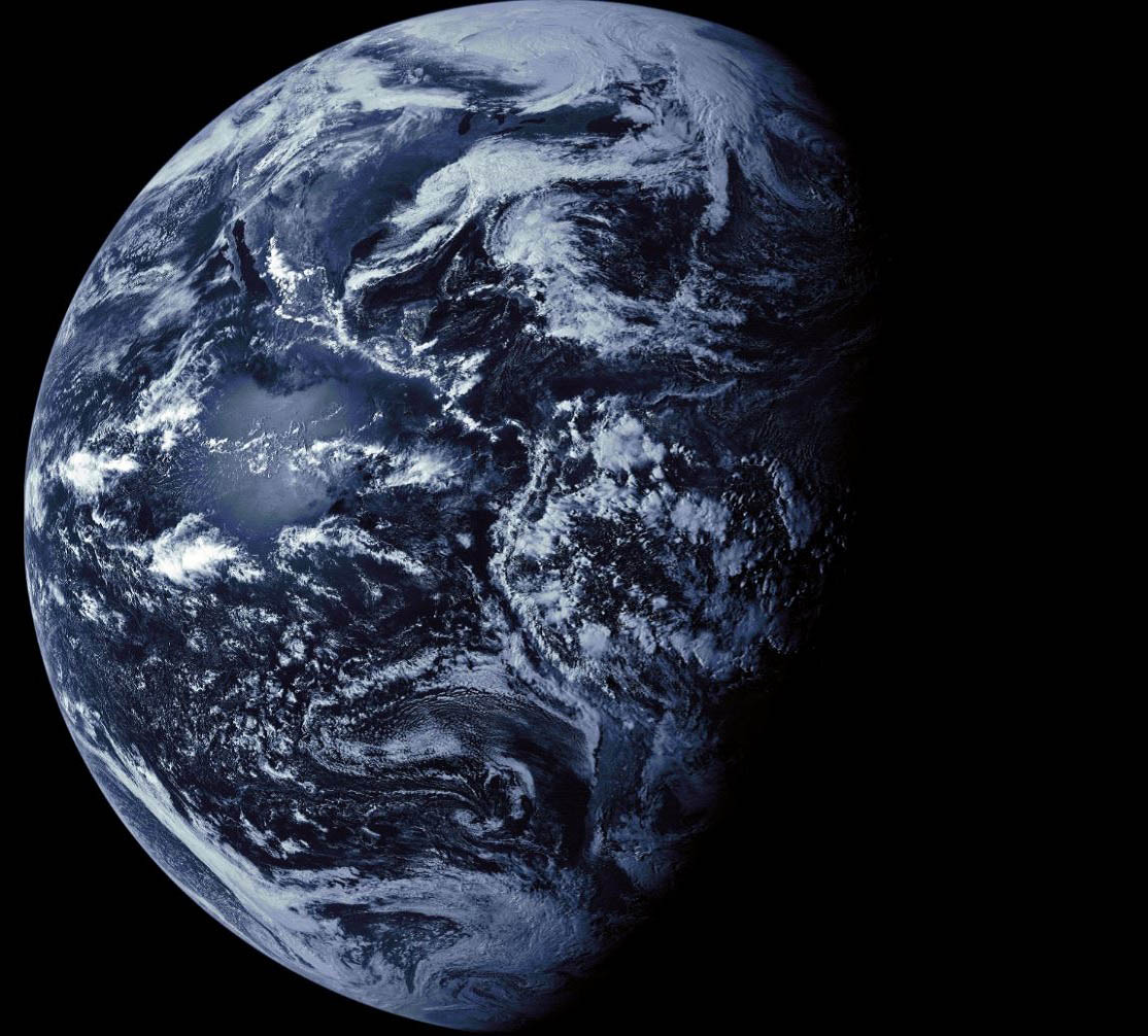

The above is a GOES 13 LRIT image received with the loop Yagi antenna and USA-Satcom XRIT decoder software; the gray-scale image has been colorized using Adobe Photoshop™.

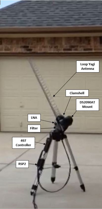

The Meade DS2090AT telescope mount with a 497 controller was repurposed for use as a tracking system and mount for pointing a loop Yagi antenna to geostationary and orbital satellites. The L-Com antenna described above will be too heavy and bulky for proper use with the Meade DS2090AT mount, so a different mount would be used with the L-Com antenna. If you use a loop Yagi and the Meade DS2090AT, be sure to obtain the latest DS2090AT version which has a blue band around it showing the position rather than a black band. Older versions of the mount may not work as well without some modification for this application (they may slip in vertical movement, given that the loop Yagi antenna having 26 director elements is near the maximum out-of-balance weight for the mount – if it should slip and tightening does not solve the problem, pull the vertical control portion apart and insert a rubber washer such that it is between the friction plate and the original gripping section; alternatively, you may be able to add some non-metallic weight to the back of the boom to better balance the antenna in the mount). Given that the diameter of a 90 mm telescope tube is near that of the loop Yagi in the 1.69 GHz range and the antenna weight is comparable to that of a telescope tube, making use of a used telescope mount capable of tracking satellites worked well in this instance. Meade Instruments has downloadable software on its web site to allow uploading the most recent versions of software and TLE (satellite data) files to the 497 controller using an RS-232 serial cable. Refer to the Autostar™ Software Updater. Additionally, Meade has downloadable Autostar™ Suite software to enable using the DS2090AT mount to point to any position in the observable sky for geostationary satellite image reception as well as to track orbital satellites passing overhead. With the Meade DS2090AT telescope mount and 497 controller, once the setup has been initialized, you can point the loop Yagi antenna directly to the geostationary satellite of interest.

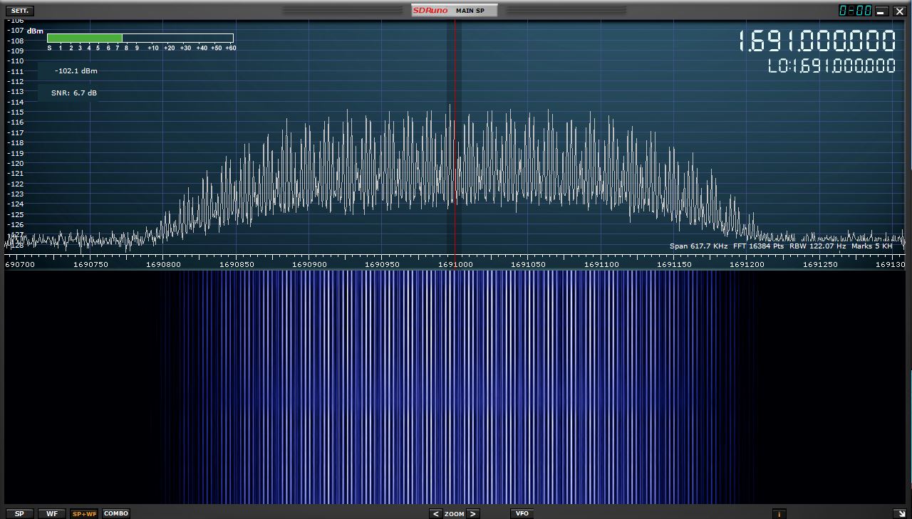

Once you have your antenna and LNA setup and connected to the RSP2, you are ready to receive the HRIT or LRIT signal. Start with GOES 13 at 1.691 GHz, if you are in the central United States and you should see the following LRIT signal using the 8Msps setting for SDRuno:

The above image shows the GOES 13 LRIT signal while data is being transmitted. For good image reception, you should have an SNR of at least 6.5 dB. To obtain a good view of the signal with SDRuno software, you will need to increase the FFT Ave to at least 64. The above image was taken with FFT Ave set to 128. The below image shows the GOES 13 LRIT signal in its idle state.

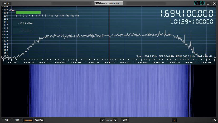

Once you are receiving LRIT signals well, swing the antenna to GOES 16 for HRIT signal reception. You should see the following signal at 1.6941 GHz:
HRIT SDRuno.jpg (94.4 KiB) Viewed 75446 times

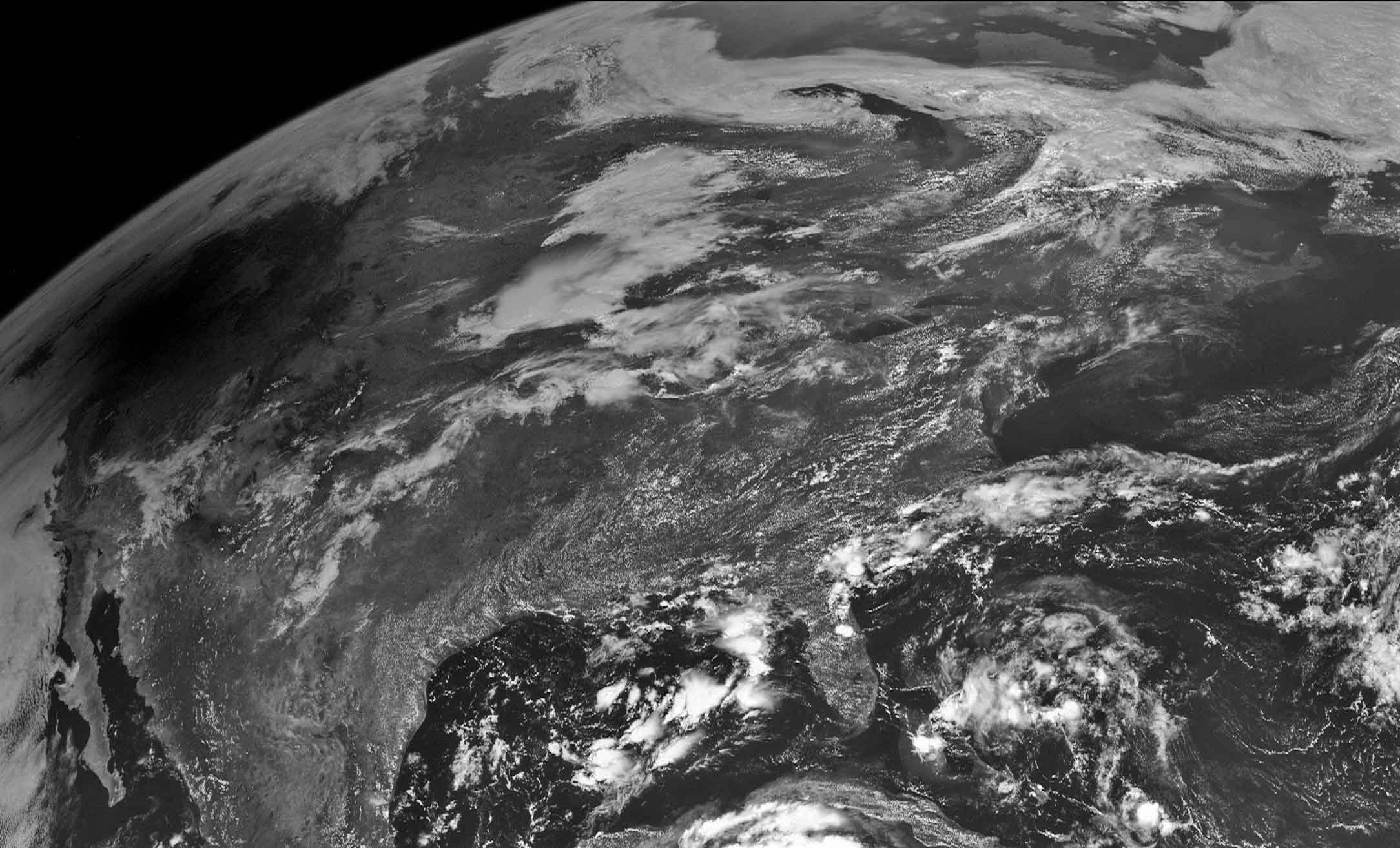

Once you have the setup running well (a signal quality of 97% or better), the HRIT and LRIT images transmitted by the GOES and similar geostationary satellites are amazing. Below is a cropped GOES 13 image of the eclipse that crossed the United States on August 21, 2017:

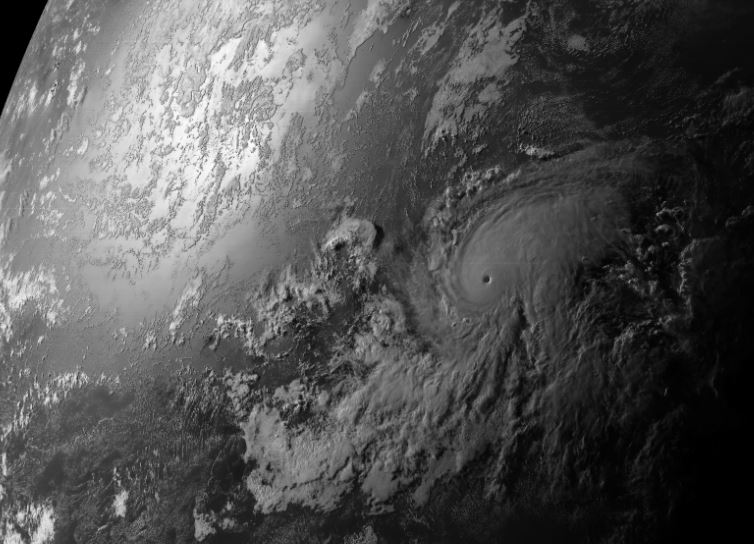

Below is a GOES 16 full Earth image showing Hurricane Fernanda in July of 2017:
GOES 16 FD Hurricane Blk Background.JPG (61.49 KiB) Viewed 75446 times
Note that in the above GOES 16 image, the white background of the image has been converted to black for aesthetic purposes using image editing software.

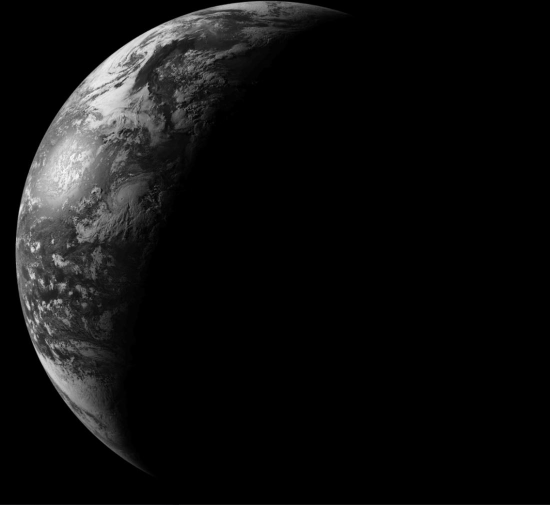

Here is a zoomed-in view of hurricane Fernanda from the above GOES 16 image:
Zoom-In GOES 16 FD Hurricane Blk Background.JPG (78.93 KiB) Viewed 75446 times

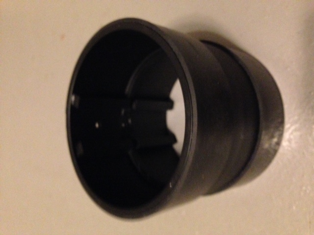

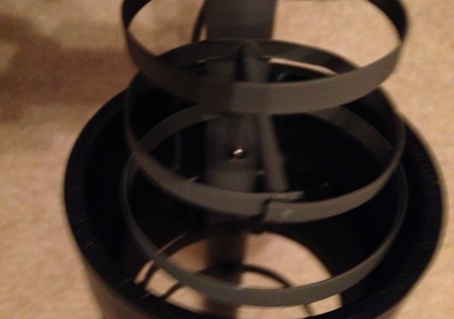

Additional information on the PVC mounting bracket. Here is the PVC mounting bracket with plastic guides glued in. A portion of the center ridge has been removed to allow the boom to lay flat against the inner wall.
Mounting Bracket 1.JPG (84.04 KiB) Viewed 74665 times
Here is a picture of the painted PVC bracket with 1/16 inch thick rubber tape applied to the outer edges to allow for a tight fit in the clamshell holder of the mount.
Mounting Bracket 2.JPG (78.13 KiB) Viewed 74665 times
Here is a picture of the loop Yagi antenna attached through the PVC mounting bracket. Note that the PVC mounting bracket is exactly centered between reflector elements 1 and 3.
Mounting Bracket 3.JPG (71.95 KiB) Viewed 74665 times

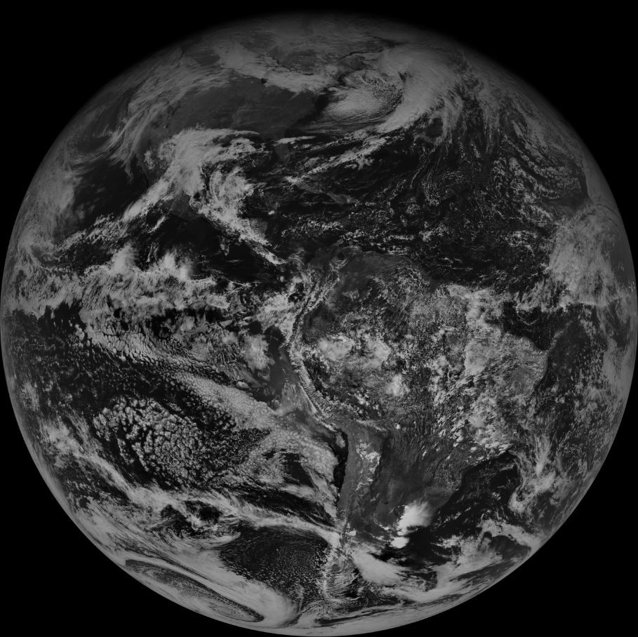

Be sure to check NOAA operation schedules for GOES 13, 14, 15, 16, and newer GOES (and other LRIT/HRIT capable) satellites as these are launched. As of the past week, GOES 16 has been moved to a new position effectively replacing operation for GOES 13. Here is an image from GOES 16 in its new position. Note that the white background was converted to black for aesthetic purposes using image editing software. The easiest way to do this is to open the image in Paint, then select black as the fill color, then select the fill icon (looks like a paint bucket pouring paint), then click on the white background, then save the image.
