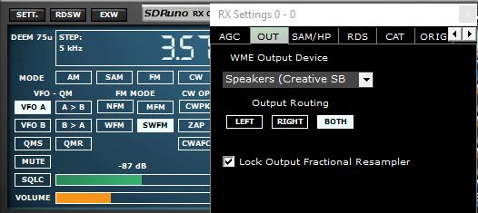

Try Lock Output Fractional Resampler in the RX settings windows in SDRUno. This usually helps straighten out the image. Then use fldigi's slant adjustment to remove slant.
