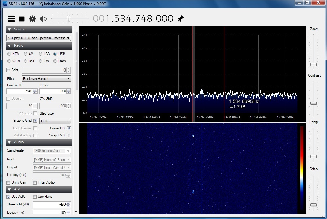

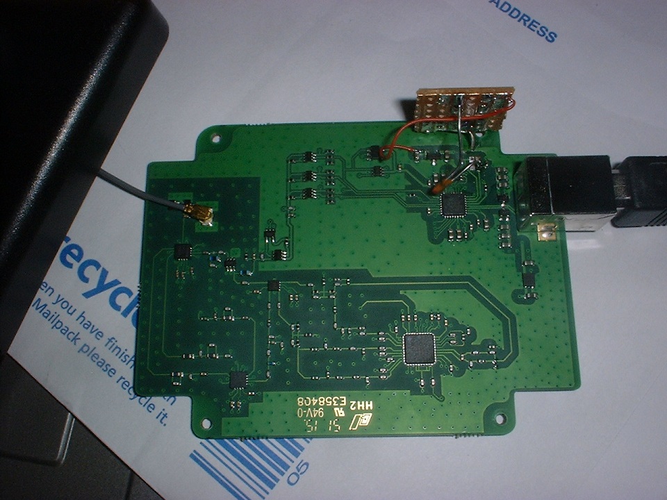

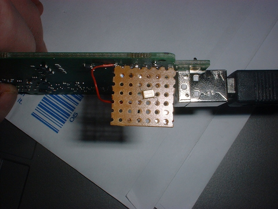

So ..My warranty is now void having removed the 24mhz crystal..
The 24mhz TCXO is temporarily hung with fine wires on a small piece of stripboard ...
This may be a problem to fit as it has a slightly larger footprint than the original crystal ..
No capacitors have been removed from the SDRplay pcb as this didn't seem neccessary ..
the output from the TCXO was ac coupled to pin 22 of the MSI2500 chip with a 220pf capacitor ...and the needed 3v DC supply was picked up from the 3volt regulator U15 which in turn is fed directly from the 5v USB supply ..
The AFC pin on the TCXO is grounded along with pin 1
So PINS 1 and 2 of the TCXO are grounded ..
3v supplied to pin 4
output cap coupled from PIN 3 to the osc in of the MSI2500 chip ..
It donesn't look pretty but it IS working ..
I'm attaching photos of the lashup ..along with an active screengrab of the sdr pcb ouputting ACARS (Aero data)
rgds
VS
