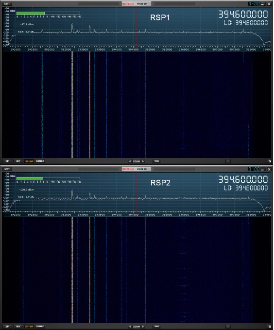

Before I continue yapping about HF on the RSP2 again, I wanted to show you the solid improvement in the area around 400 MHz. The ranges between 327-350MHz and 374-395MHz are particularly infested with images from the entire FM band and above on the RSP1. I chose the upper end of that range because on the right you can even see an image from a ridiculously weak DAB station on 178MHz (the only one that can be received around here so far):

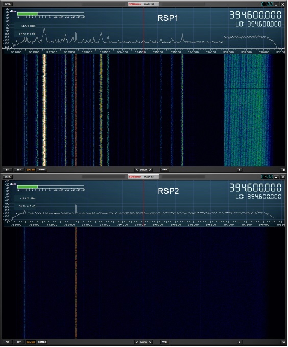

The FM bandstop filter of the RSP2 was not turned on, the improved bandfilters reliably remove the FM muck and let only a lonely local TETRA station show up on the screen. The antenna used for that shot is still my HF dipole, which works pretty well (for a 2x10m wire antenna) on FM and up to 200MHz, but not so good on 400MHz anymore. Here's what's to see on that frequency range when I use an LPDA antenna actually covering that frequency band:
The antenna rolls off below 200 MHz, so it's suppressing the FMBC band nicely but the RSP1 is still adding a little muck. Not sure why the data bursts at 396MHz show up much clearer on the RSP2.

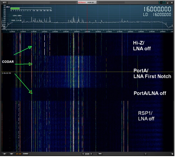

... and the question whether or not the RSP2 is also moar betterer on HF. What I can say for (almost) sure is that the 50 Ohms ports on the RSP2 are not working identically to the RSP1. The RSP2 seems to be more finicky about levels behind the LNA in general, and behaves differently on the 50 Ohms ports than the RSP1, most noticable when the LNA is off. Take a look at this composite screenshot:
All parts of that screenshot were acquired with roughly the same overall GR. What I meant to show there is:
- At the bottom you see the RSP1 with the LNA off, for comparison.
- In the section above you should notice that the RSP2's 50 Ohms port can be pretty deaf in comparison, even in the upper half of the SW band, when the LNA is off.
- If I add a little gain from the LNA (and reduce IF gain if necessary) I still can't match the performance of the RSP1 with its LNA off for some reason, also it looks a little noisier in the center.
- Only the Hi-Z input on top shows a proper match to the RSP1's performance at the bottom. That's why I marked the CODAR (coastal radar) signal on the left side, it had a nice constant level and reflects the differences pretty well. Obviously, the Hi-Z setup changes my dipole's sensitivity and noise distribution a bit, but still the crisper and less noisy looks of that section reflect what I hear.
So it looks as though the answer to the question above is that the RSP2 has at least the same (if not better) HF performance as the RSP1, but only with the Hi-Z port. However if you tweak IF and LNA gain for the optimum, the difference might be rather marginal, even when you use the SMA ports.

All agreed. I find the HF performance via the Hi-z port a big improvement over the RSP1, especially the lack of FM images. It's actually very good and comares well with my other (far more expensive) receivers. I am particularly impressed with the LF performance, which is very clean for such a low cost RX. I still use my homebrew filter bank (0-400KHz LPF//0-1.7MHz LPF//160m amateur band BPF// HF >2MHz HPF), but even without it the performance is commendably clean.
