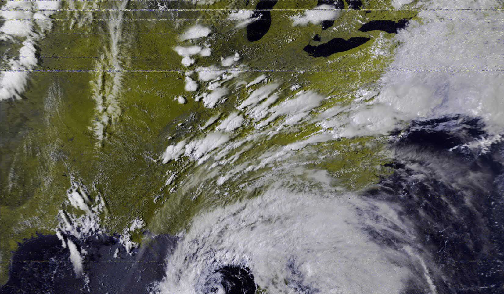

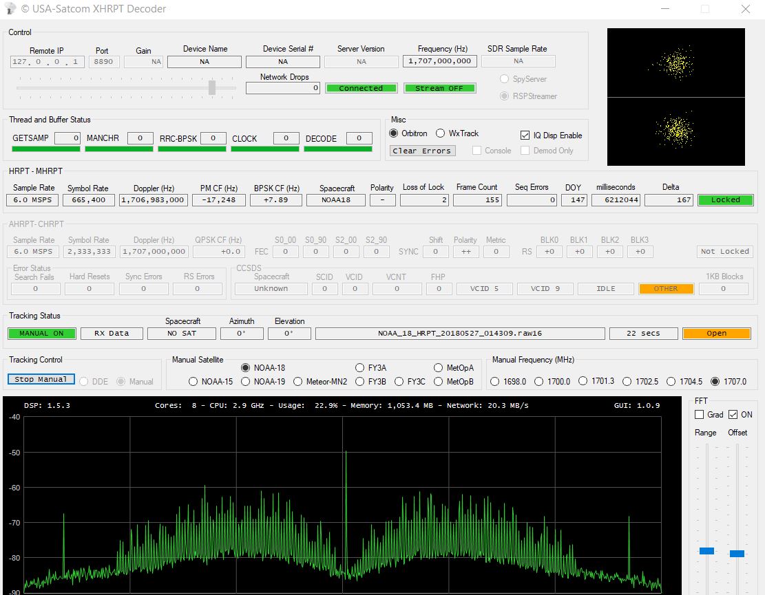

In case anyone was wondering how well the NooElec SAWBird GOES LNA/Filter combined with the Premiertek 1m grid antenna described in the HRIT and LRIT Low-Cost System ( https://www.sdrplay.com/community/viewt ... f=5&t=3262 ) works for HRPT, here is an initial test showing the signal level from a NOAA 18 pass as well as a manually-tracked image showing subtropical storm Alberto from NOAA 19 with a 31 degree maximum altitude pass. WIth optimized antenna tracking, results are expected to be better.
Noaa 18 NooElec SAWBird LNA and 1m PremierTek Grid.JPG (162.47 KiB) Viewed 19732 times
NOAA_19_HRPT_20180527_211230 LR v2.jpg (206.57 KiB) Viewed 19732 times

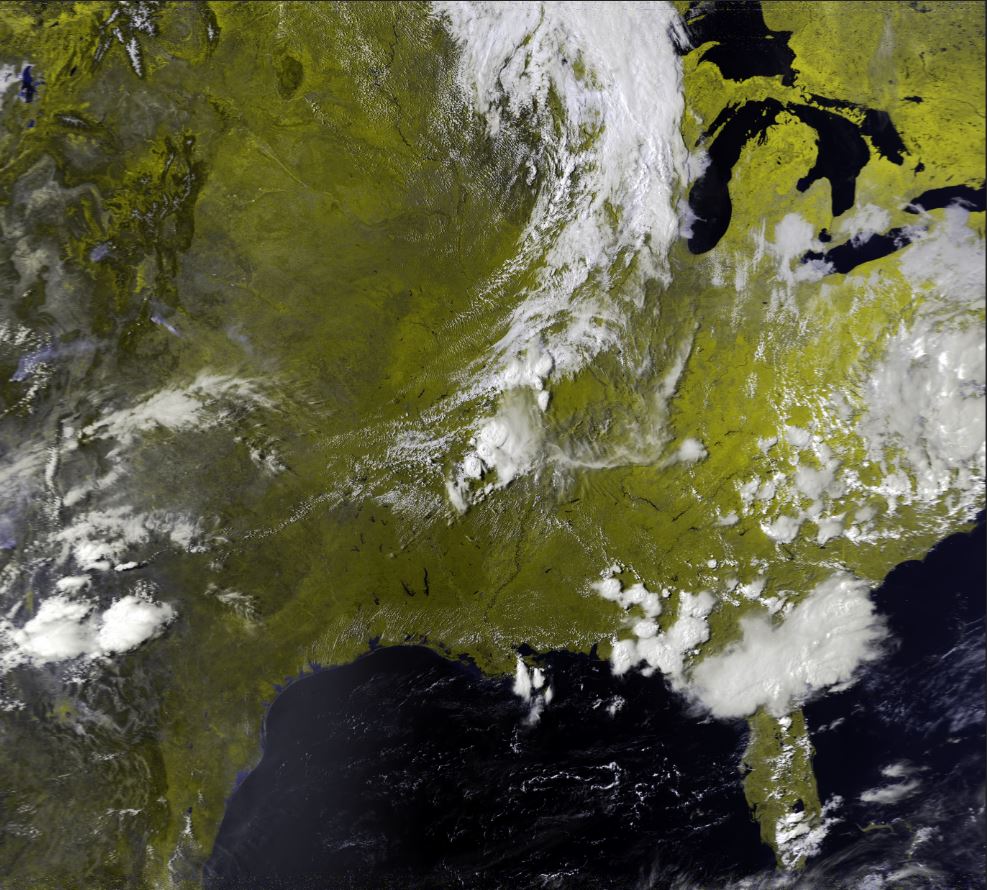

Better 60 degree maximum altitude hand tracked NOAA 19 HRPT pass using the Premiertek ANT-GRID-24DBI antenna and the NooElec SAWBird GOES LNA.
NOAA_19_HRPT_20180602_214244-rgb-corrected v2.JPG (184.06 KiB) Viewed 19686 times
