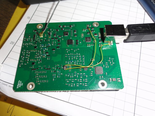

Just for laughs I show my Hammy Hambone solution for the spur in the 40m band. It's a 47 Ohms 1206 SMD resistor connected to 5V and glued to the offending chip. The ~0.5 W dissipation creates enough heat to move the spur down to 6.92 MHz.
Merry Christmas and a happy new year!

DK7OB wrote:Just for laughs I show my Hammy Hambone solution for the spur in the 40m band. It's a 47 Ohms 1206 SMD resistor connected to 5V and glued to the offending chip. The ~0.5 W dissipation creates enough heat to move the spur down to 6.92 MHz.
Good one!
