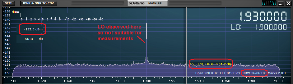

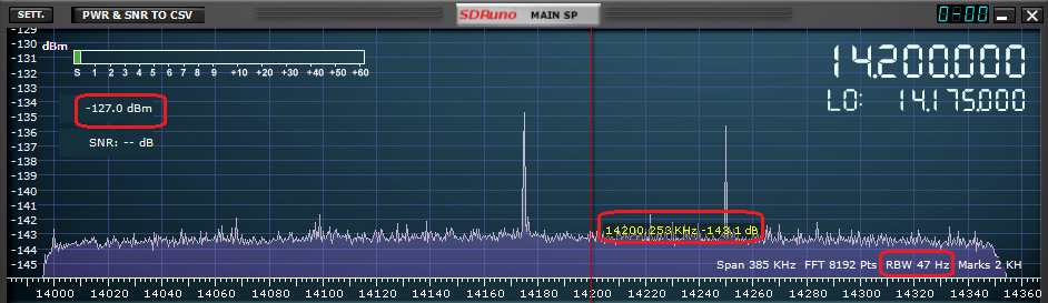

Here are a couple of tests at the frequencies that you used and my results along with screenshots. They were done using the HI-Z port terminated with a 1K resistor. The Rectangular Window was selected under SETT and the FFT average was 128. 1800 Hz. filter in USB.
When selecting the 160m band in SDRuno the LO will be at 1900 Hz so this is not a good test frequency. You need some offset. Here are my results. I have adjusted the scale under SETT to zoom in on the noise floor. The baseline noise floor is selected with the cursor in SDRuno.
Frequency 1930 KHz.
METHOD 1
Noise Floor: -132.5 dBm
-132.5 -10*LOG10(2000) = -132.5 - 33 = - 165.5
174 - 165.5 = 8.5 dB NF
METHOD 2
Noise Floor: -151.2 dBm
RBW = 26.86Hz
10*LOG10(26.86)= 14.3
-151.2-14.3 = 165.5
174-165.5 = 8.5 dB NF
Frequency 14.200 KHz.
METHOD 1
Noise Floor: -127.0 dBm
-127.0 -10*LOG10(2000) = 127.0 - 33 = 160.0
174 - 160 = 14.0 dB NF
METHOD 2
Noise Floor: -143.1 dBm
RBW = 47 Hz
10*LOG10(47)= 16.7
-143.1 - 16.7 = - 159.8
174 - 159.8 = 14.2 dB NF
Roger
