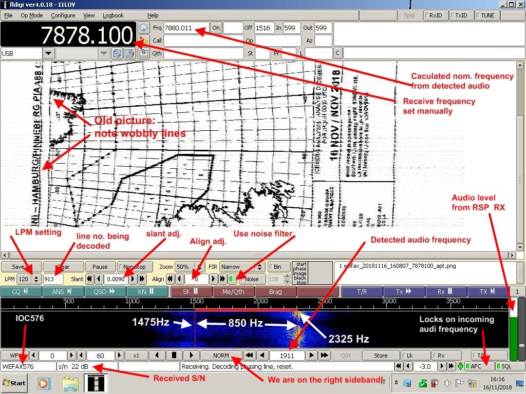

Re: QUALITY METEOFAX RECEPTION WITH THE RSP RECEIVER
WEATHERFAX AND THE RSP DUO RECEIVER - Fldigi Wefax in operation
- Figure 7. - WEFAX in operation with Fldigi
- Fldigi in operation.jpg (355.76 KiB) Viewed 27116 times

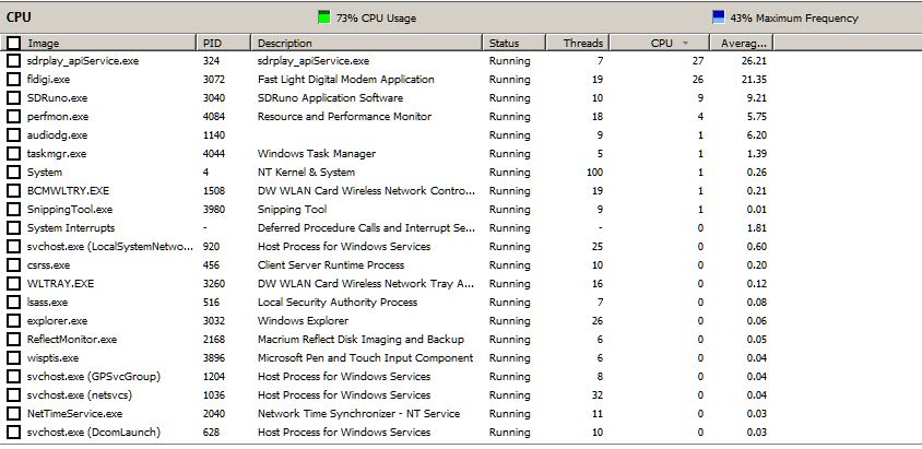

SDRPlay API Service: 26.2
SdrUno 1.23: 9.2
Fldigi 4.0.16: 21.3
Total for abv. 56.7
The horizontal displacement in the image indicates that the received data is encountering delays (latency). Breakup of the audio is also noted.

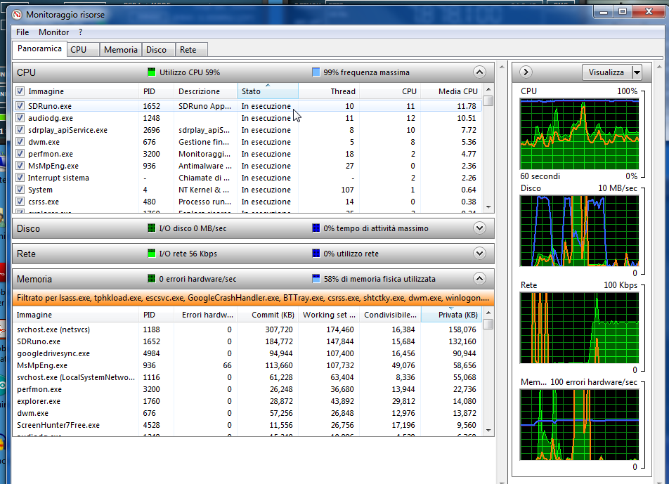

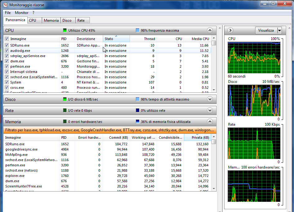

WEATHERFAX AND THE RSP DUO RECEIVER - SYSTEM OVERLOAD?
Hi Mike 2459,
Opening the W7 diagnostics is a good idea, here below I downloaded two PC screens showing what's happening with SDRuno open as well as Fldigi. Clearly the system is already at nearly max. load with just SDRuno open, and goes over the top when the Wefax software is started. The hard disk seems to be in a very bad state, e.g. the Virtual memory going full blast, so it is probably the RAM that needs to be doubled to 6 GB or more...
I also tried with SDR Console, hoping it would be lighter on the system, but the charts are still very dirty, while they are perfect on PC #2. I have opened a ticket also, as I feel this to be a problem of general interest.

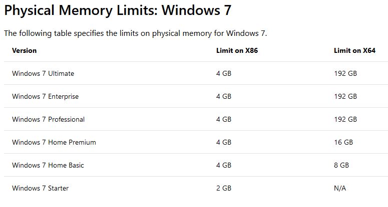

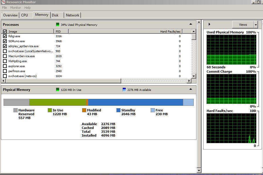

You can view your memory usage in Resource Monitor:
Memory Usage for Dell E5400 laptop Win7 32bit
Standby memory is memory that is available for use 32 bit Windows operating systems can access up to about 3.5 GB of memory (about .5 GB is reserved). 64 bit operating systems can access much more.
https://docs.microsoft.com/en-us/window ... -windows-7

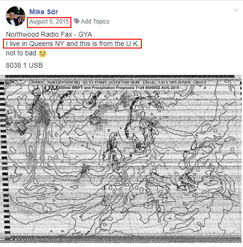

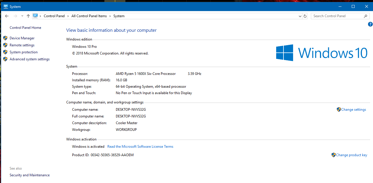

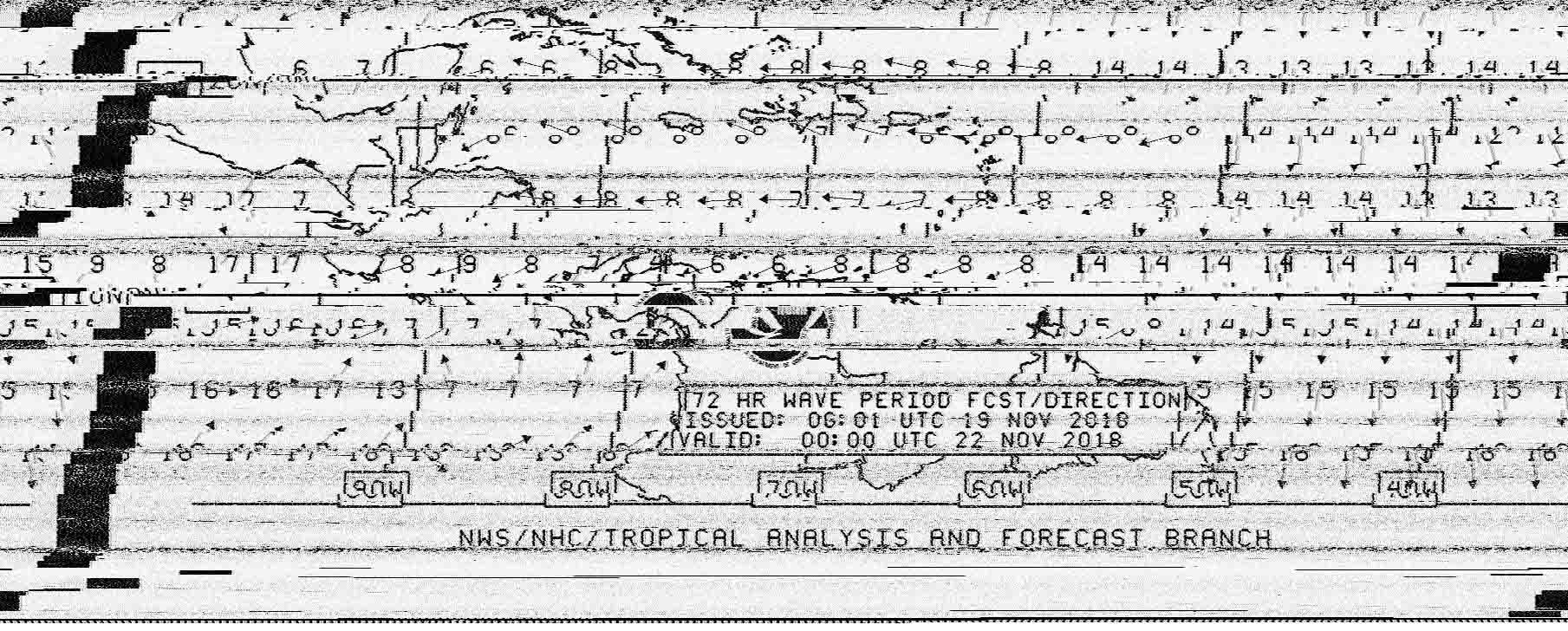

Yesterday a few minutes after I had lodged my ticket, Mike of SDRplay Tech. Support promptly replied to my questions and sent copy of a meteofax chart coming from Europe and received with a RSPuno in NYC, using a single PC hosting SDRuno and the Wefax decoding program MultiPSK. SDRplay must be commended for the quality of their assistance!
Here below the received chart and the PC specification. It is now certain that SDRuno and Meteofax software can coexhist on the same PC and successfully produce Meteo charts. In fact the chart shows some noise, due no doubt to a weak signal, but there is no trace of smearing on the black lines.
Coming to the question of the PC used: it is a 64 Bit tabletop, Windows 10 OS, with an AMD Ryzen 5 1600X six core job, operating at 3.59 GHz. The RAM is 16 GB. This is a far more powerful machine than my IBM X61 laptop operating with Windows 7 and this explains why it is not possible to receive and decode Metofax with a "small" machine. Furthermore I have no hope of improvement, because, as pointed out by Mike 2459, nor the X61 at 32 bit, nor Windows 7 Professional support more than 4 GB RAM. So the trick of using two machines, one for receiving and the other for decoding, really saves the day and provides satisfactory quality at low cost.
