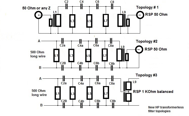

Re: HIGH PASS FILTER FOR OPTIMUM HF RECEPTION
GENERAL DISCUSSION ON PRACTICAL FILTER REALISATION PROBLEMS
During this month of January I have built and tested several prototypes. The outcome of of the results is as follows.
1) Practical realization of filters with in/out 50 Ohm impedances is difficult, because capacitor values near or above 1000 pF are needed and temperature stable high value precision capacitors are difficult to find. At this cutoff frequency (2.200 KHz) it is advisable to go for higher internal impedances (such as 500 Ohm) which require more easily available components.
2) My choice of Series First topology (see previous posts) in order to minimise the number of coils and hence the insertion losses, was not ideal, because then one would be obliged to use transformers (additional components) for impedance trasformation, so losses would go up again, apart from making the filter more complex.
3) To conclude, the best topology, after all, is the Shunt First as shown above.With this configuration the filter has a shunt inductor at the beginning and one at the end. If we change these inductors into transformers by adding an additional link (winding) we obtain a big simplification, hence smaller size, and lower losses in practice. With this topology we have the advantage we can use the impedance level as a parameter for filter component optimisation, because the turns ratio between main winding and link permits to accommodate any impedance shift. This configuration makes the use of toroids mandatory, at least for the two end inductors, in order to have strong coupling between the windings.
4) Another advantage is that any filter, whatever the level of the internal design impedance, can be easily measured with standard 50 Ohm instrumentation by just adding a link to the two external coils. Furthermore the links can even provide double ground isolation if desired, resulting in exceptional ground balance, useful for local noise rejection.
Following the above criteria, I calculated and built the experimental proptotype whose excellent performance was illustrated in the previous posts. In the next post complete data for this prototype will be uploaded.

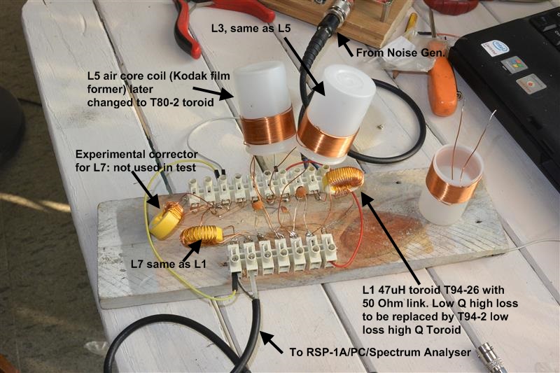

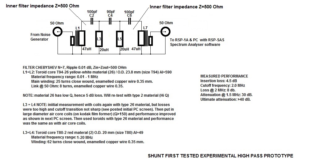

The N=7 Chebyshev High Pass Prototype
Uploaded below detailed data of the High Pass Chebyshev N=7 prototype. At this frequency the technical characteristics of available components are as important as the design, in fact the best design will fail if implemented with low quality components.
The other problem with this High Pass filter is that it must reject very strong signals, so that shielding is essential and effective shielding requires low filter volume and hence low size components. In this respect the air cored coils wound on Kodak film roll containers have a very good Q factor, but are very large. They are good for prototype measurement, but should be replaced by smaller toroid cores, if possible. This is what I have done substituting the two internal coils with T80-2 toroidal cores.
The next step will be the replacement of the T94-26 external toroid cores with T94-2 cores having a much higher Q factor at 2 MHz.
See errata corrige for the schematic: "Experimental prototype illustration" in one of the next posts. Added 26/01/19

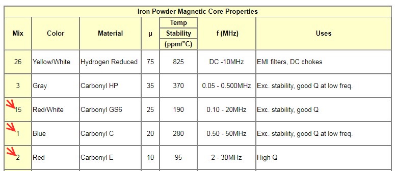

I think material 1 (mu 20) or 15 (mu 25) would be a better choice for powdered cores for MF. Ferrites have much higher mu.
Good work!
Good work!
Tony
AA9CC
AA9CC
Tony,
Thanks for the suggestion. I hope to get back my HP "Q" meter this week, I have sent it for repairs. Then I should be able to assess Q of various coils & materials.
The three materials should all be sutable at 2 MHz. The higher mu ones, that you advise, use less turns and hence should have less copper losses. However it is not easy to get toroids and one must get what is available. I shall try to get materials 1 & 15 as well and do a Q comparison.
'73
'73
