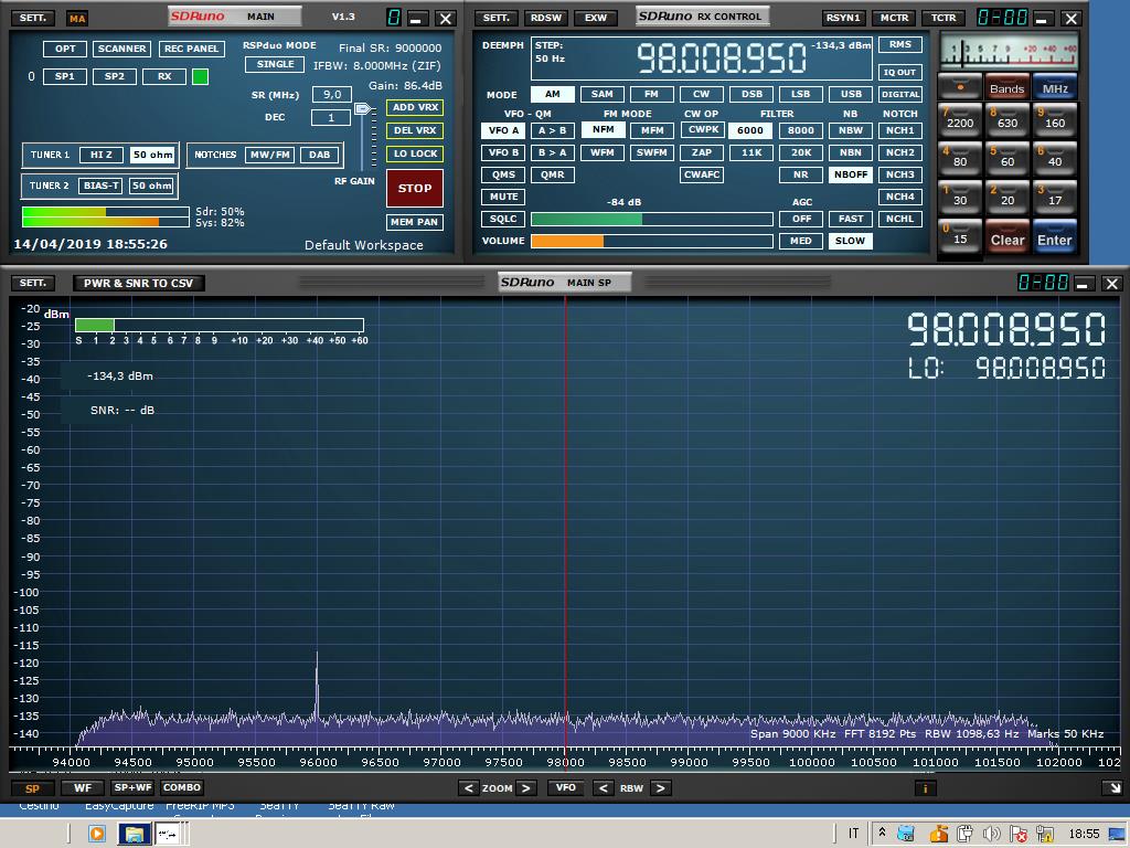

Re: FM BROADCAST BAND SUPPRESSION CHEBYSHEV N=5 BAND-STOP FILTER
I tested the RSPduo in the same conditions and in the same lab position. The metal case of the RSPduo shines here in its quality, the uploaded pic shows it: no FM broadcast feedtru at all.
- Tuner 1 50 Ohm port terminated into 50 Ohm SMA load
- FM Band Feedtru RSPduo.jpg (149.87 KiB) Viewed 23398 times

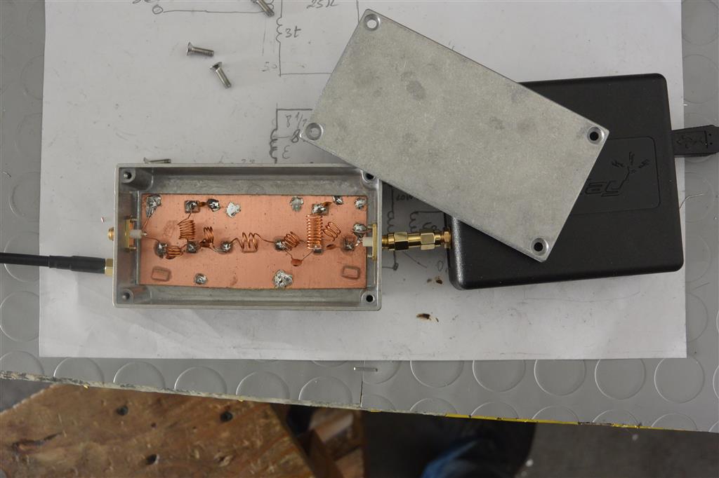

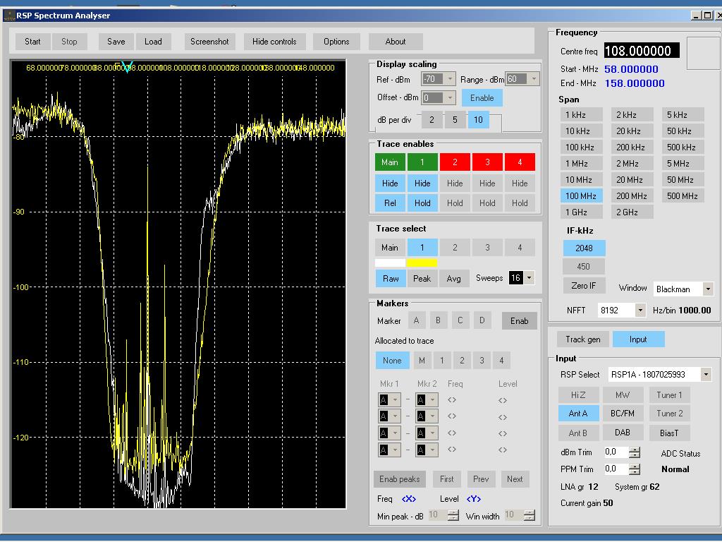

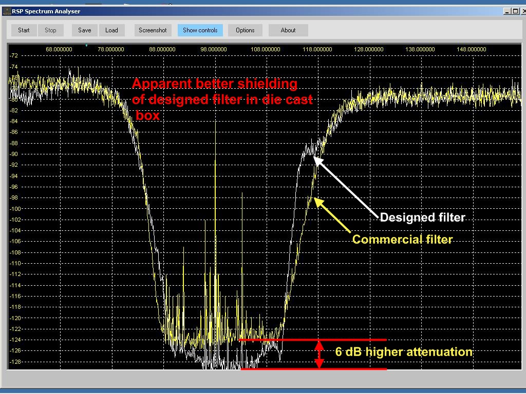

The filter has now been assembled into the die cast box and I could upload the final measurements. The filter attenuation in the stop-band has increased to between 45 and 50 dB and it is on average 6 db better than the commercial filter. Also, looking at the comparison, white for the designed filter and yellow for the commercial filter, the FM Broadcasts feedthru seems far worse for the commercial filter, but at 90 dB down anything can happen, with FM signals stealing directly into the RSP-1A.
In any case both the commercial and the designed filter are a useful addition to my RSPduo accessories and I must use one or the other when scanning the Airband or the VHF 2 m Ham Band to get rid of overload FM Broadcast noise.
- Filter in box.JPG (93.83 KiB) Viewed 23333 times
- Band Stop Filter shielded 3.jpg (338.17 KiB) Viewed 23333 times
- Band Stop Filter shielded 2.jpg (144.34 KiB) Viewed 23333 times
