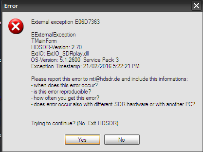

Re: The station name thing
Are you getting a real crash (standard Windows crash window "Blah blah has stopped working") or the same/a similar exception error window from HDSDR like on my screenshot on the previous page? I take it you're using XP 32 bit?Fractal1 wrote:I have the very same issue with HDSDR crashing now, but on windows xp system. Installing an earlier EXTIO works.
13dka,
i get the same HDSDR error/crash window as you posted on the first page. To my knowledge i haven't done anything with the eibi database.
Just to add further, yes i'm xp 32 bit. Here is my error:
- hdsdr crash.png (13.1 KiB) Viewed 32494 times
This is a known issue on some machines which I'm working on.
For now, you can download this zip file: http://www.sdrplay.com/software/disable ... lookup.zip
make sure HDSDR is not running, extract the reg file out of the zip file, double click on the reg file
restart HDSDR - this disables the station lookup and returns 3.8.1 to 3.7 functionality.
We are looking into the issues causing the crash and will update you as soon as we can with a solution.
