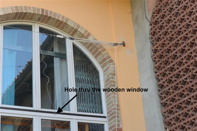

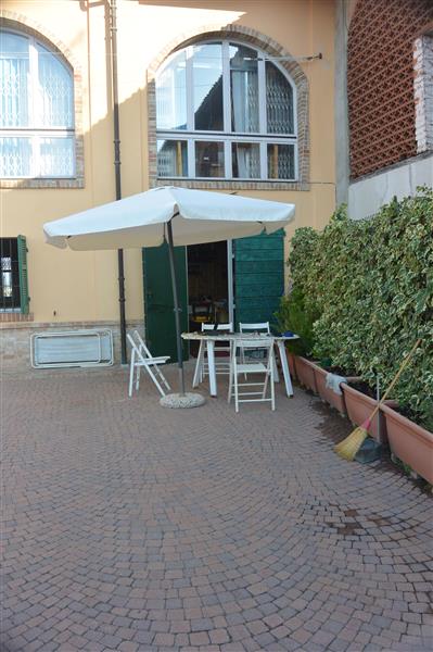

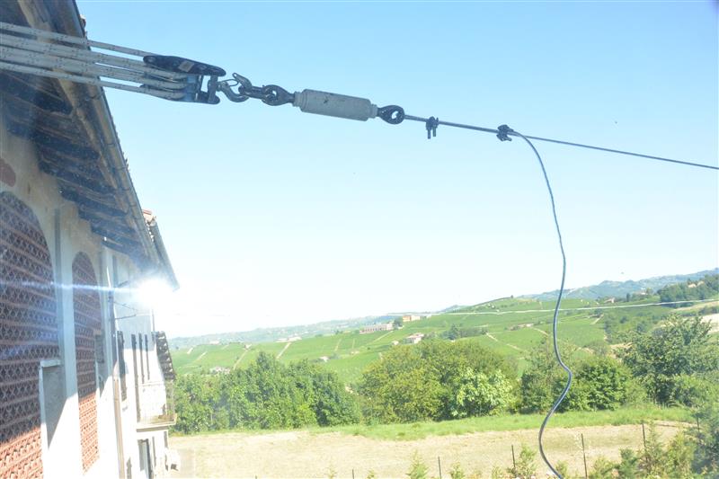

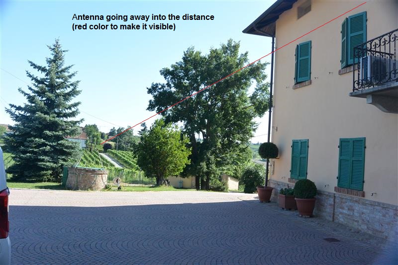

Dear Phil, it is 18:00 hours and I am back (tired) from the Riviera. Tomorrow I shall study your material in detail. Here I wish to give you physical details of the Beverage and of my setup, because I fear it is far simpler than you imagined.
The antenna is held to the side of the house with a triple purchase tensioner and goes away into the distance to a wooden telephone type pole (no other poles in between). Average antenna height over ground is 6 m and horizontal length is 135 m, + 2 m lead-in, + 5.5 m to the junction box containing the terminating 560 Ohm resistor. Grounds at both ends with heavvy stakes as shown in the picture. Stake depth 1.7 m into humid clay grounds (extremely good for Barolo wine which I make). I have no feeding arrangements as the antenna loops thru the insulator and goes to the inside balun thru a small hole in a wooden window. More in the photos.
Kind regards,
Gianfranco
Kind regards,
Gianfranco
- Antenna receive side 2 .JPG (150.57 KiB) Viewed 34927 times
- Antenna receive side 1.JPG (84.56 KiB) Viewed 34927 times
- Antenna going away.JPG (176.02 KiB) Viewed 34927 times

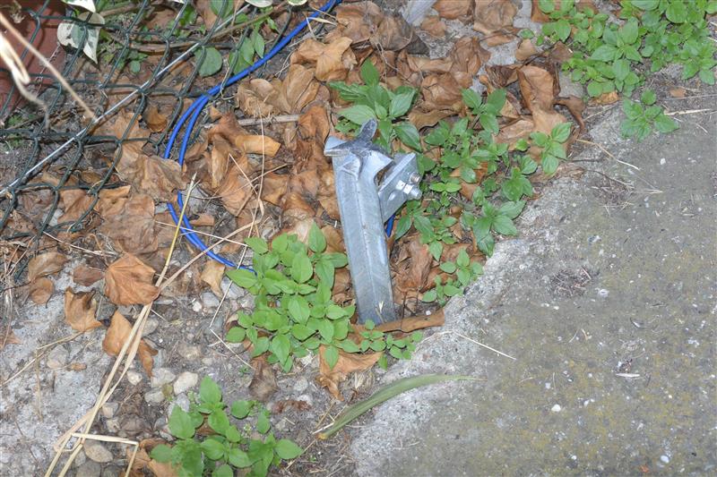

More photos....
- Inside works .JPG (135.72 KiB) Viewed 34927 times
- Ground stake.JPG (138.31 KiB) Viewed 34927 times
Re: Testing RSPduo receiver sensitivity with noise generator
Dear Gianfranco, I don't think I've corresponded with anyone from the Riviera before, especially someone bragging about coming home tired
Hope it all worked out well for you both and the problem was resolved! But, here we sit in the depth of winter and you're showing me sunny photos of vineyards and talking of home made wine and beverage antennas, a Freudian slip no doubt.
Lovely to see your situation, thank you for the unexpected bonus!

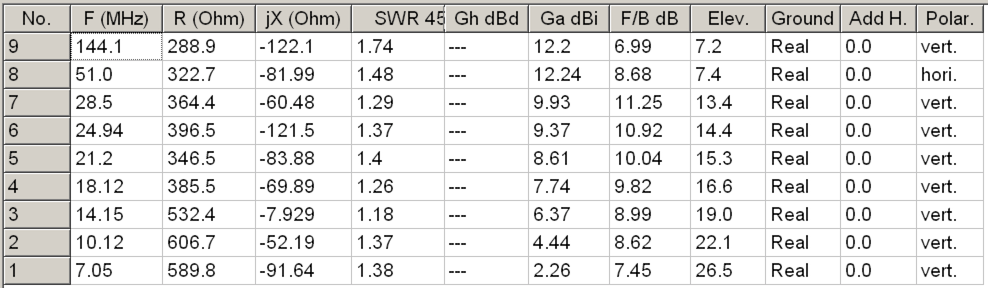

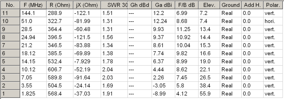

Here is your antenna as per your length and height figures minus the 5m feed in. It's modelled with your 560 ohm resistor, the SWR figures are calculated for a 450 ohm feed line. You might get to hear some rare DX on 6 and 2 if you avoid the ferrite bandwidth issue.
I should have done this properly before the above post. Suddenly occurred to me that I hadn't tried it below the 7MHz you originally spoke of using it for.
Here is your antenna from 1.8Mhz up. This time the SWR figures are calculated for a 300 ohm feed point. My wife wouldn't possibly let me drill a 450 ohm hole in her window, maybe a neat 300 slot is remotely possible though
That's one very interesting antenna isn't it.

I am simply amazed by (and a little envious of) your capabilities about antenna modeling. I have also seen you are also equipped with the AA - 1400, top of the range antenna analysis meter, so you are able to close the circle, from design, to modeling, to actual antenna measurement and I consider myself very lucky to have your help.
You have now compelled my attention and interest to the extreme bandwith of the Beverage antenna, while previously my involvement with the RSPduo was with VLF to HF only. By going from an unterminated 30 m wire and no baluns to a 135 m terminated Beverage and painstakingly tested wireline, ferrite loaded baluns, I went from almost no signal received, to crowded HF bands in just 15 days.
I agree with you that baluns, while dramatically improving Beverage performance, steal one of the best features, e.g. extremely wide bandwith. On the other hand, unless you reside on a mountain top, the biggest drawback in using a long Beverage above 28 MHz is antenna elevation. In 1950 to 1960 I worked on 14.300 SSB, but was very much involved with VHF, UHF and SHF as well. For 144 and 432 MHz it was Yagis as high as I could place them, for 1296 MHz it was a converted APX6 (you certainly remember lighthouse tubes) and parabolas. I even wrote an article on APX 6 conversion on 73 Magazine, 1960.

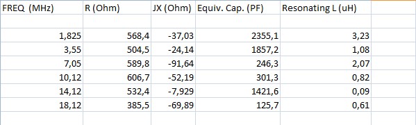

Dear Phil,
On second thought wonder if you could look again at your last antenna model and provide R / JX data from 2 to 14 MHz, but evenly spaced, i.e. every MHz. It should then be possible to implement an autotuner which could zero the capacitive term at every frequency....
What worries me is the apparent discontinuity between 10.12 and 18.12 MHz.
Cheers,
Gianfranco
Cheers,
Gianfranco
- ANTENNA REACTANCE tune.jpg (27.91 KiB) Viewed 34732 times

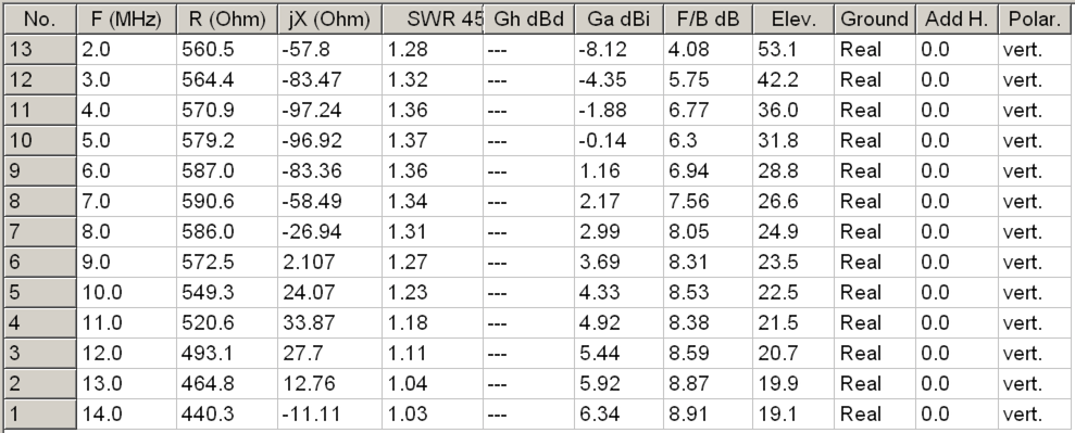

Hello again Gianfranco,
I'm not like the soothsayer in Antony & Cleopatra "In nature's infinite book of secrecy, a little I can read", the reality is I'm like the blind theologian looking in a dark room for a black cat which is not there. The problem is my conceit and impatience sometimes makes me think I've found it, so beware!
Happy to do the 2-14MHz modelling, will post it a bit later, all going well.

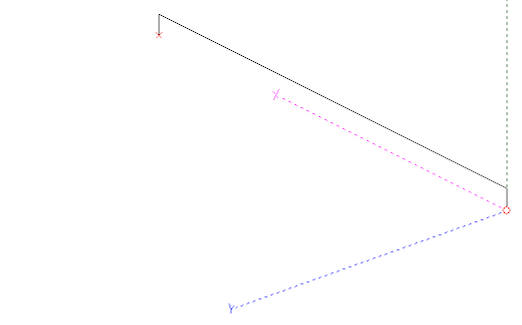

Before pushing forward though there is another consideration. The models are based on the view in the pic below - a classic Beverage - which as you can see has the feed point at the bottom of your blue wire, between it and your earth stake, at the red dot. Hence my comment about bringing a ladder feeder in through your window.
I wonder if you are willing to reconfigure things temporarily that way for a test? It looks like the blue wire connected to the top of your Beverage at your window might be able to drop down to the earth stake instead of coming in the window so that you could on one of your very many sunny days place the RSP and your balun at the earth stake and extend the USB cable up through your temporarily open window?
Otherwise, if that is not convenient, I should try to remodel it based on the reality of your situation.
Here is the 2-14MHz table

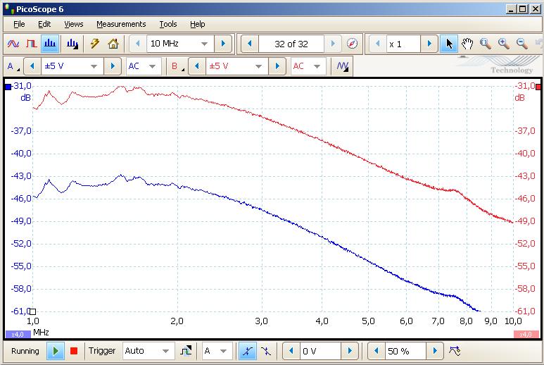

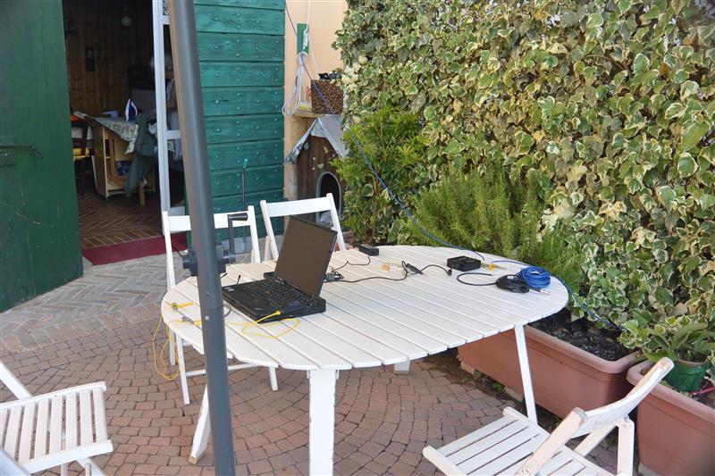

Dear Phil,
The RSPduo relocation is completed and I am now ready to test the system as you proposed. With reference to the pictures, I have lenghtened the antenna lead (blue wire from top) by 2.5 m and it goes directly to the RSP. The ground lead between stake and RSP is less than 1 m. As soon as I switched on I could immediately see a lot of amateur stations on 14 & 7 Mhz, which normally disappear at this time of the day (8:20 and sun high up). Will post results tomorrow morning.
Kind regards,
Gianfranco
Kind regards,
Gianfranco
- DSC_1110 (Medium).JPG (129.78 KiB) Viewed 34800 times
- DSC_1109 (Medium).JPG (68.31 KiB) Viewed 34800 times
- DSC_1108 (Medium).JPG (131.44 KiB) Viewed 34800 times
