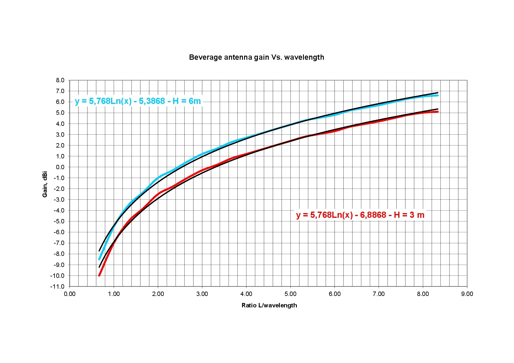

An L = 135 m Beverage antenna, at an average height of 6 m operates at 3.6 Mhz and measures an average noise floor of -104 dBm. Balun loss is negligible. The Beverage is a wideband antenna and gain depends on the ratio of length L to wavelength W.
At 3. 6 Mhz Wavelength W = 300/3.6 = 83 m.
L/W = 135/83 = 1.62
From Figure 1, r’ = -2.8 dB.
Therefore the corrected antenna nose floor Anf= - 104 + 2.8 = - 101 dBm
Applying the decile deviations: -98 > Anf > -104
In conclusion (Table 3) we are in the bottom end of the “Quiet rural” situation.

- Figure 1 - Beverage Antenna Gain Vs. Wavelength ratio
- Beverage Gain.jpg (284.38 KiB) Viewed 21782 times

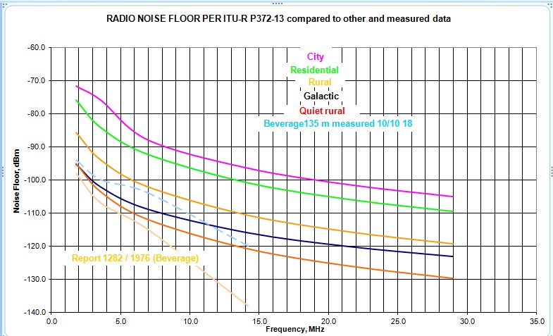

Re: ASSESSING THE PERFORMANCE OF THE RSP RECEIVER SYSTEM IN HF
The enclosed graph summarises Radio Noise evaluations, data and measurements discussed in this thread.
- Noise Floor summary graph
- Noise Floor Summary.jpg (88.14 KiB) Viewed 21701 times

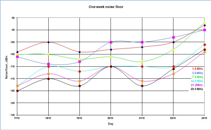

One week noise floor variation in Northern Italy. Data taken with already mentioned 135 m Beverage antenna at 17:00 local time (15:00 GMT) each day. This is not local noise, as verified by radio ham reports in QSO's, but a general situation, especially today, when a remarkable noise increase was registered on all frequencies.
- One week's noise on HF bands
- One week noise floor .jpg (50.26 KiB) Viewed 21504 times
