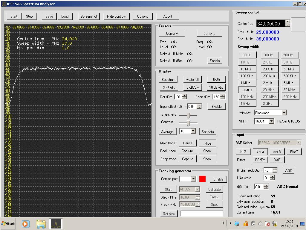

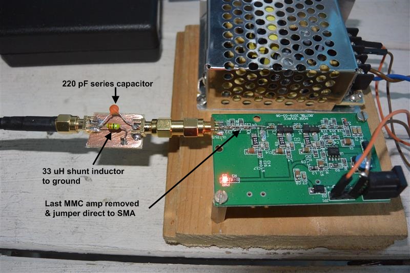

OUTBOARD OUTPUT AMPLITUDE EQUALISER FOR THE BG7TBL NOISE GENERATOR 3 TO 35 MHZ
It is possible to remove the main problem (output levelling) of the BG7TBL, limited to the frequency range that interested me for filter development, e.g. 3 to 35 MHz, with a simple outboard L/C network. In reality equalisation should work down to 2 MHz, but it is difficult to say if the drop is due to the generator or the measuring software down there. I have measured the equalised output of the repaired noise generator. e.g. the one with the last amplifier removed and with a jumper from the second amplifier to the output SMA. Output level shown in the pics is 6/7 dB less because of the averaging action(level 16) of the display.

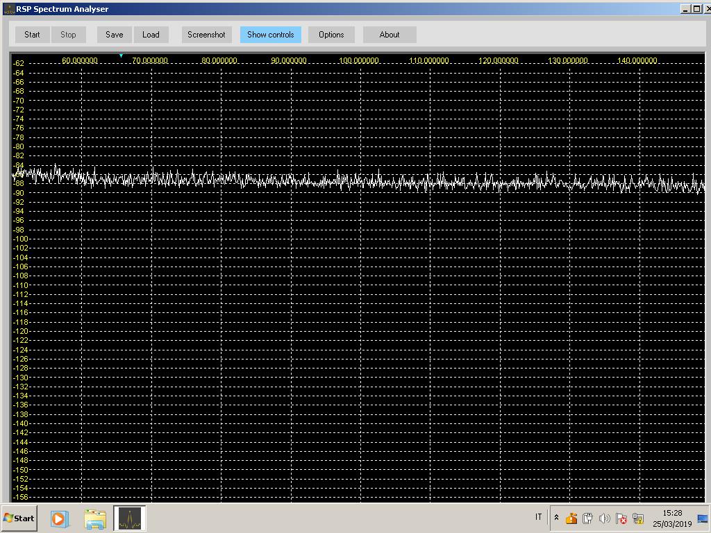

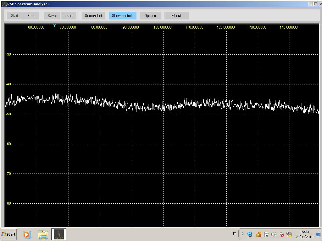

THE NEW SPECTRUM ANALYSER ALPHA SOFTWARE & NOISE GENERATOR DATA
VERY MANY THANKS TO STEVE!!
What better time to obtain Noise Generator accurate reference data using the new issue of Steve's wonderful software?
The following data has been obtained using a BRAND NEW BG7TBL Noise Generator fed by a stable 11 V supply.
Supply voltage: 10.96 V
Suppy current: 196 mA
Power output @ 50 MHz: -45 dBm
Uploaded below output between 2 & 150 MHz.
FIGURE 1 has been drawn with the Noise Generator directly connected to the RSP-1A input to obtain the absolute level of output noise.
FIGURES 2 & 3 have been obtained with a 43 dB attenuator in between.
Curves 2 & 3 can be used to calculate a correction factor formula vs. frequency and/or a frequency dependent amplitude equaliser.

- Figure 1. Output level to RSP-1A with no attenuator to measure absolute output level
- ABS LVL.jpg (101.74 KiB) Viewed 42618 times
- Figure 2. Output variation 2 to 100 MHz
- 2- 100 MHz.jpg (246.4 KiB) Viewed 42618 times
- Figure 3. Output variation 50 to 150 MHz
- 50-150 MHz.jpg (243.21 KiB) Viewed 42618 times

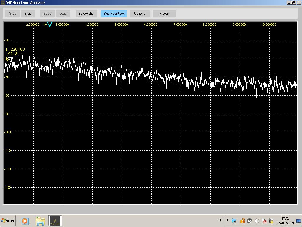

Re: A CLOSE LOOK TO LOW COST NOISE GENERATORS
Uploaded below is lower frequency Noise Generator output (43 db Attenuator between generator & RSP-1A).
- Figure 4. Output variation 1 to 10 MHz
- 1-10 MHz.jpg (114.39 KiB) Viewed 42581 times

glovisol it seems to me you are using a switch supply with the noise gen. This makes a lot of bad hash. How can you do measurement?
